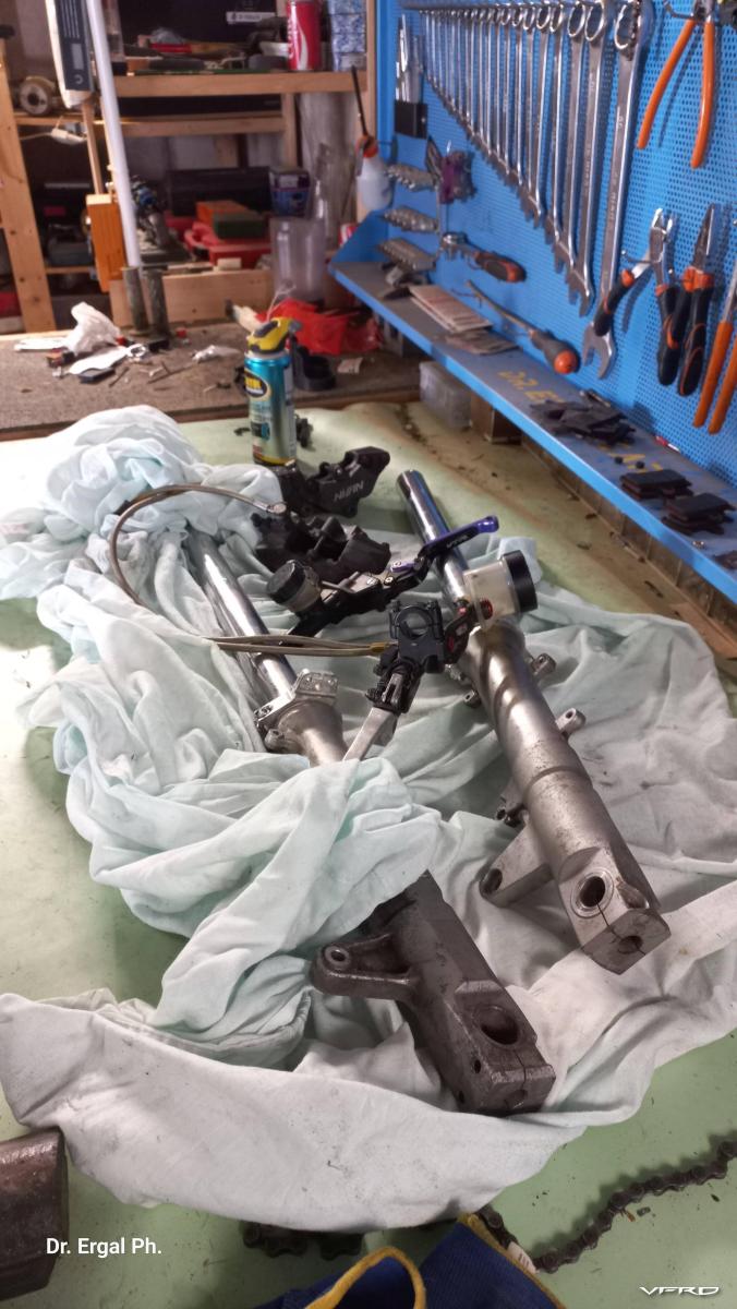

I made what most of all already did : VTR1000F front-end swap.
I found a second-hand fork set, and a complete braking front system (including a HEL steel braided line)

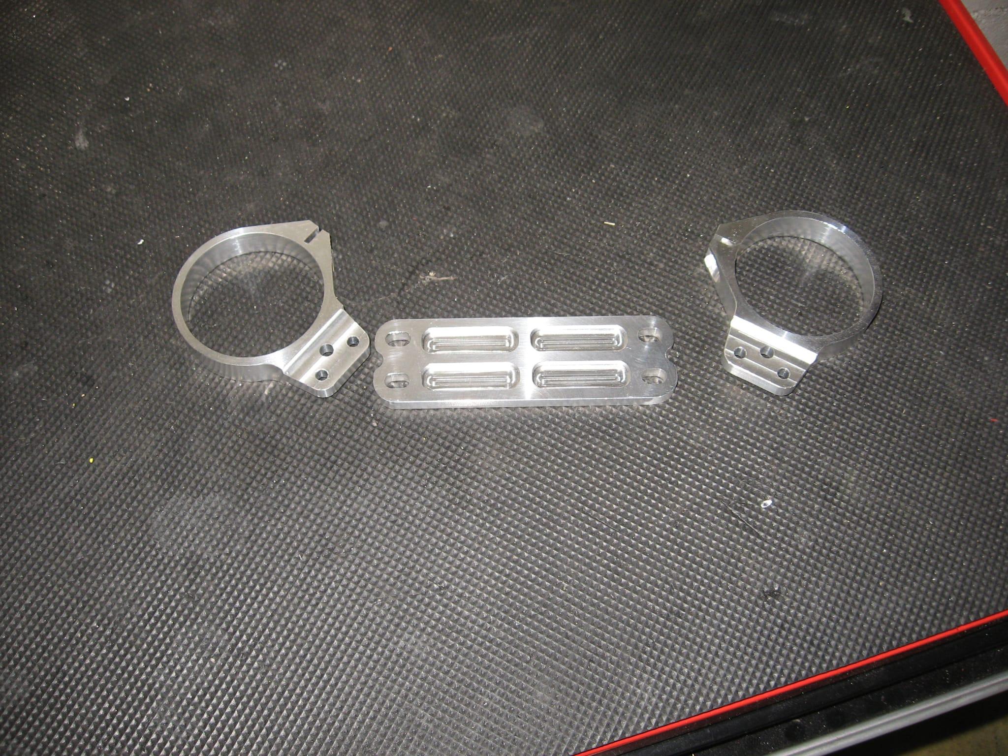

I won't add pictures of the works, because it's something posted dozens of time here.. I just want to remark an upgrade: a dedicated forkbrace, designed by myself: and machined from a solid Avional 2024 block.
image.thumb.jpeg.6a5867f96de837b4889daacc8ab07f6f.jpeglarge.IMG-20250113-WA0048.jpg.b31e0504184d03173644c3416ea4cf3f.jpglarge.IMG-20250113-WA0047.jpg.3654c46c95500670d3b5a3021f8d3193.jpg

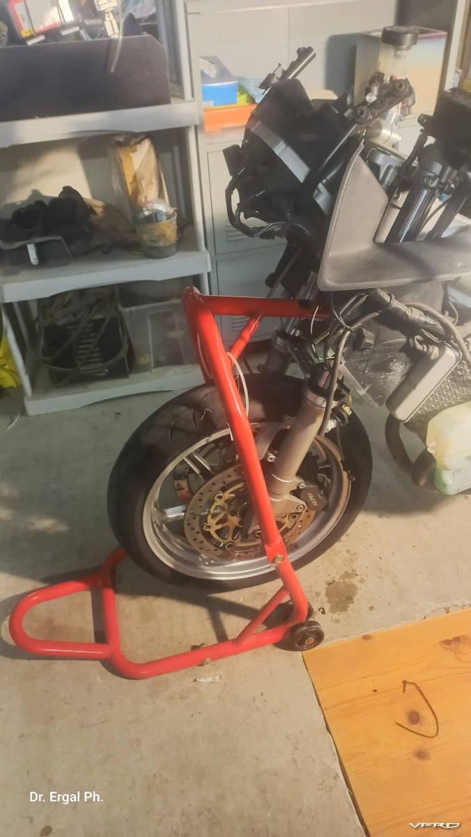

I replaced the original spacer with a new one made in aluminium:
Here's the frontend swapped in:

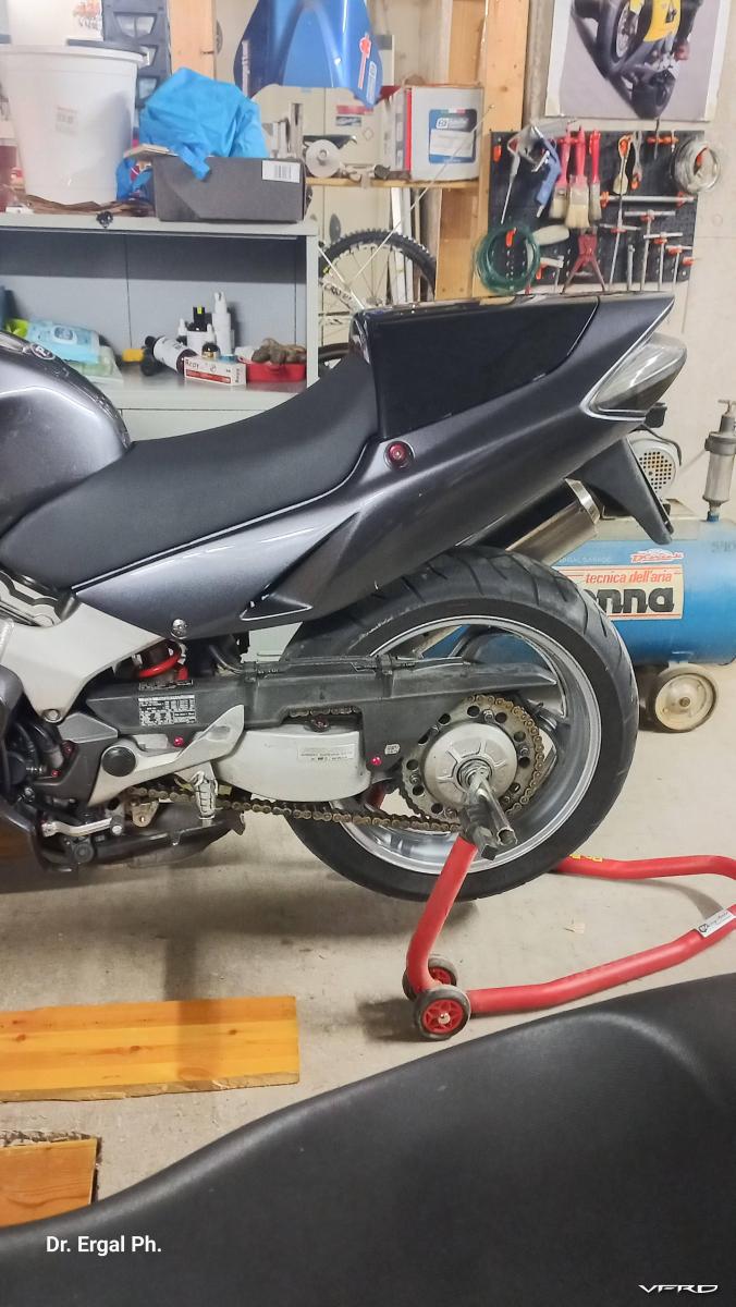

Because I use it "solo only" (my wife has her own bike), I removed passegers footpegs.

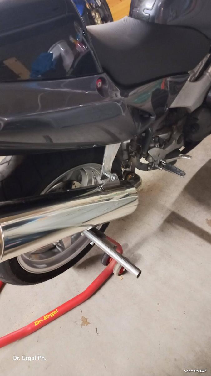

I'm still studying for a decent muffler bracket...
large.20241005_162950.jpg.9842edebc52462789f5e9e059d65dcc0.jpglarge.20241005_162933.jpg.dbb67f47581460bc21aa2f45d79ea5a0.jpg

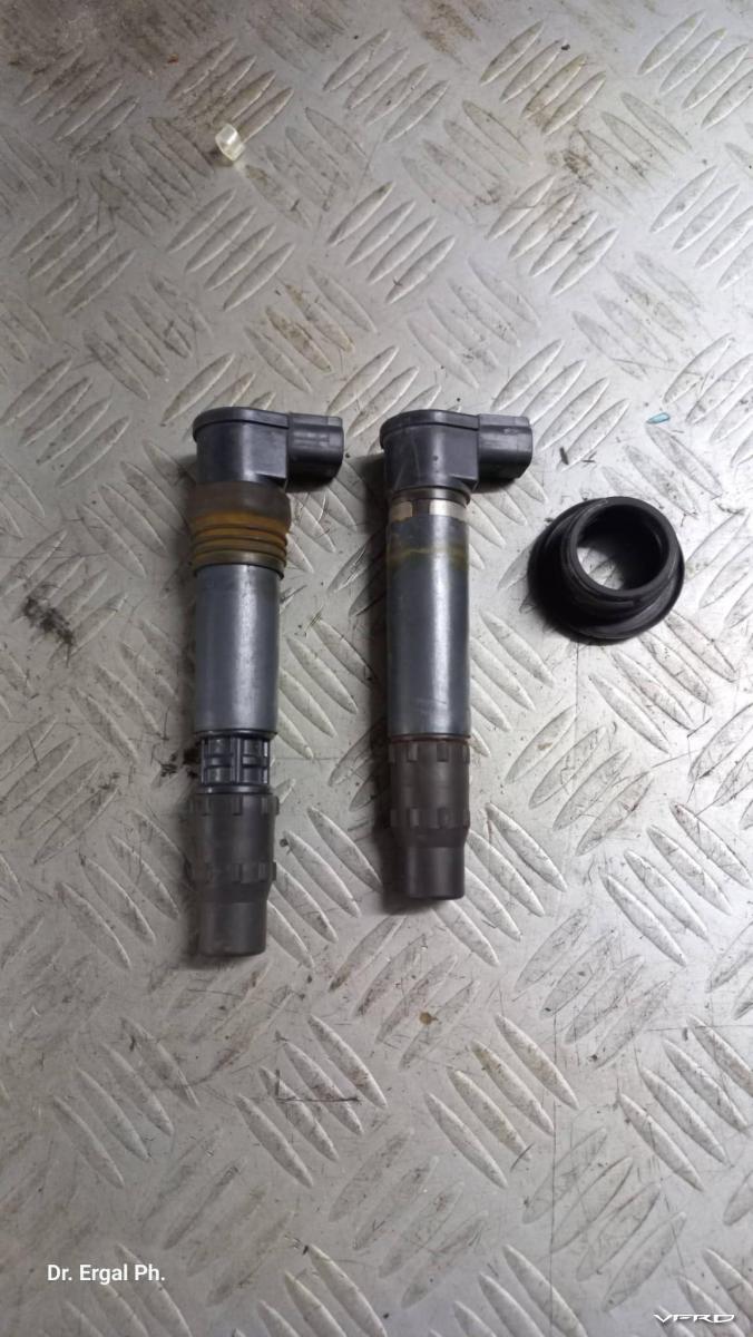

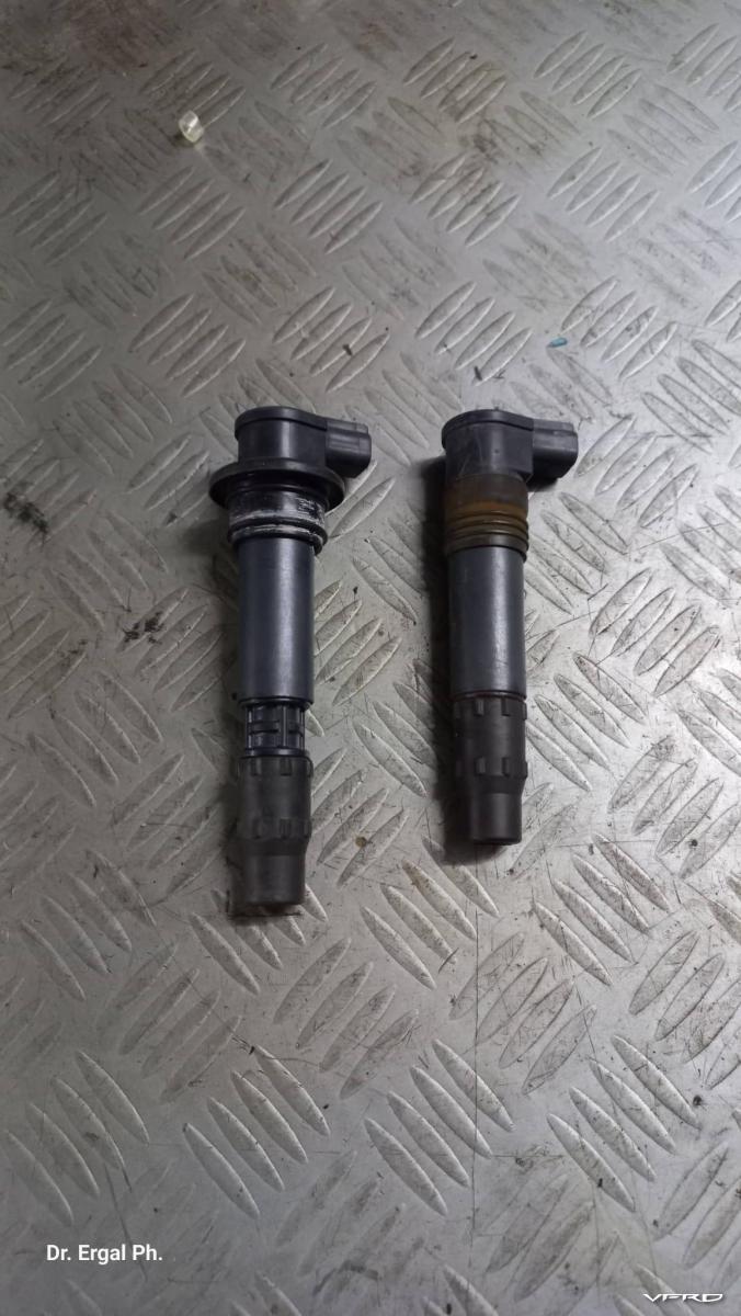

2. Ignition coil update with coilstick
As well as the frontend swap, it's something posted a bunch of times here,, so I just want to thank you all for inspiration and information.
Despite all the info collected here, I fell into the error to buy a short coilstick 😁
However, it's not been completely useless, because by applying the seal of the shorter into the longer I got the perfect match:
Short and long:
Long coilstick equipped with seal of the short coilstick: 👍
Front cylinders:
Rear cylinders:

Looking good. It's interesting to see the different ideas people have about what they want from their VFR. You've done quite a number of modifications to yours. I particularly like the coil-on-plug mod, and the fork brace. That's the first I've seen of those mods on a VFR. All that, but you still have the stock exhaust can. That was one of the first things to go on my 5th gen. What made you keep the stock can?
3 things made, essentially.
1) I DO LOVE the whining sound of the engine coming from the timing gears, and I don't like it to be overpowered by the exhaust
2) I have horsepower enough to have fun; I'd like to install a LIGHTER muffler (weight saving is the main thing: HP output gain is totally negligible, to me) , but I consider other stuff much much worthy. I.e., I'm saving money for the rear shock
3) In my place (Trentino, north Italy, close to Garda lake), police officers are extremely strict for such modifications.
