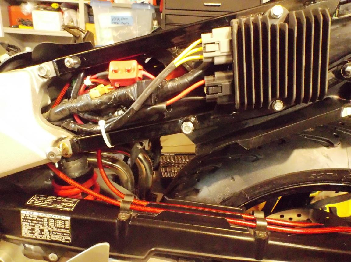

Member Contributer Tirso Posted January 7, 2025 Member Contributer Posted January 7, 2025 18 hours ago, Ziffer said: I just bought a Shindengen SH847. Still waiting to get it, but wanted to find out what people have done to mount it. I just figured I'd buy or build a bracket to mount it in the original location. Is that the "best" option?  This is what I did: 5th Gen Needs New Rec/Reg, Other examples on this thread. If I had to to it over, I'd use rivnuts. Other mounting examples from VFRW  Good luck  Quote

Member Contributer Ziffer Posted January 7, 2025 Author Member Contributer Posted January 7, 2025 3 hours ago, Tirso said:  This is what I did: 5th Gen Needs New Rec/Reg, Other examples on this thread. If I had to to it over, I'd use rivnuts. Other mounting examples from VFRW  Good luck   Ah, finally, someone with some useful information. I took a quick look at the provided info... I'll probably just drill and tap the subframe. 👌 Quote

Member Contributer JZH Posted January 10, 2025 Member Contributer Posted January 10, 2025 On 1/7/2025 at 3:27 AM, Tirso said:  This is what I did: 5th Gen Needs New Rec/Reg, Other examples on this thread. If I had to to it over, I'd use rivnuts. Other mounting examples from VFRW  Good luck    I love Rivnuts. Especially stainless steel ones (but use anti-seize).  Ciao,  JZH Quote

FrostyJ Posted February 17, 2025 Posted February 17, 2025 It has been awhile but I think that I just drilled and tapped the frame, careful not to over torque. Rivnuts was plan B.  Quote
Member Contributer MBrane Posted February 18, 2025 Member Contributer Posted February 18, 2025 I just made a simple adapter out of some 1/2' x 1/8" flat stock, and some spacers. An added advantage is getting it away from the hot subframe. I even added a little axial fan. Probably not needed, but it can't hurt.  It's not that difficult if you have a hacksaw, and a drill. Quote
