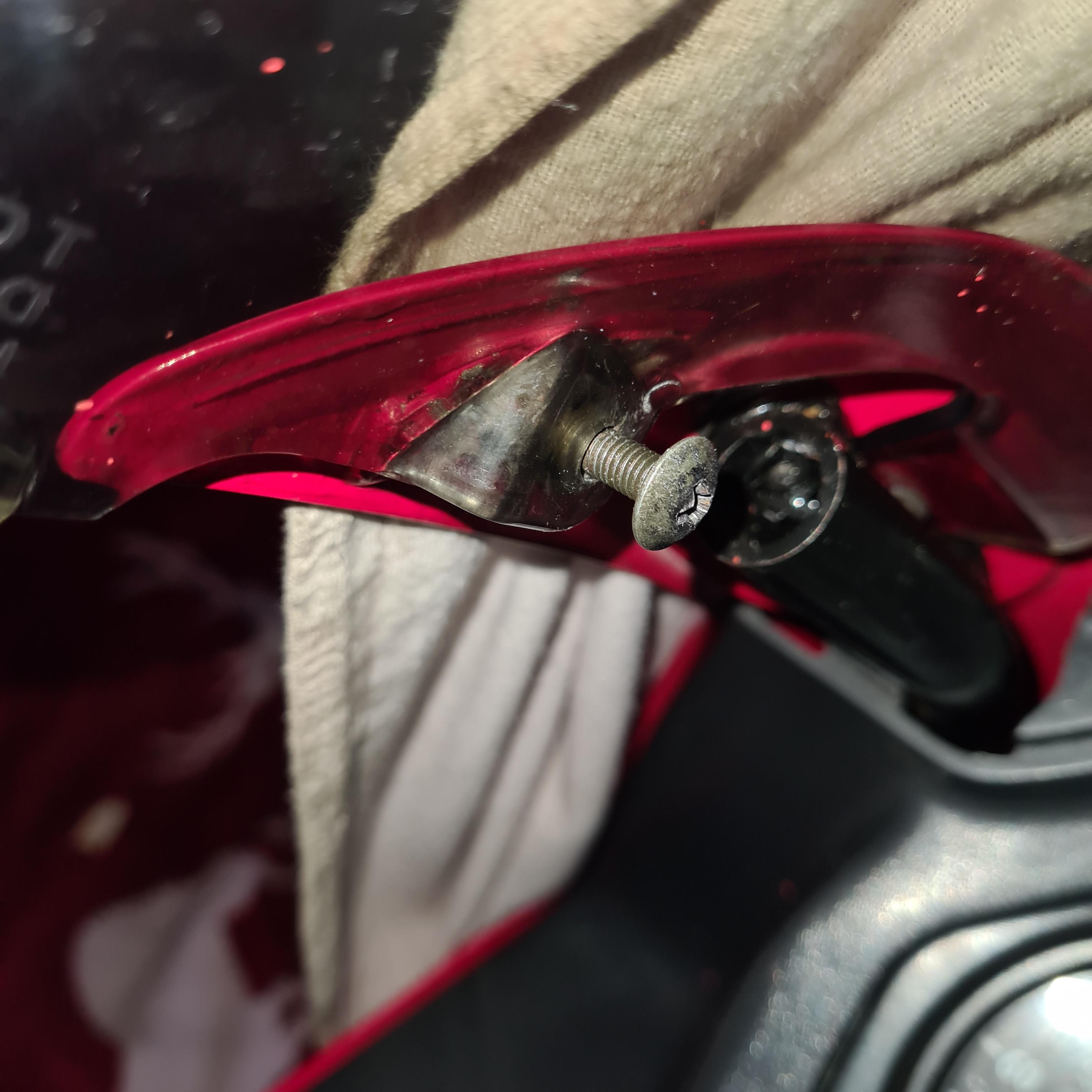

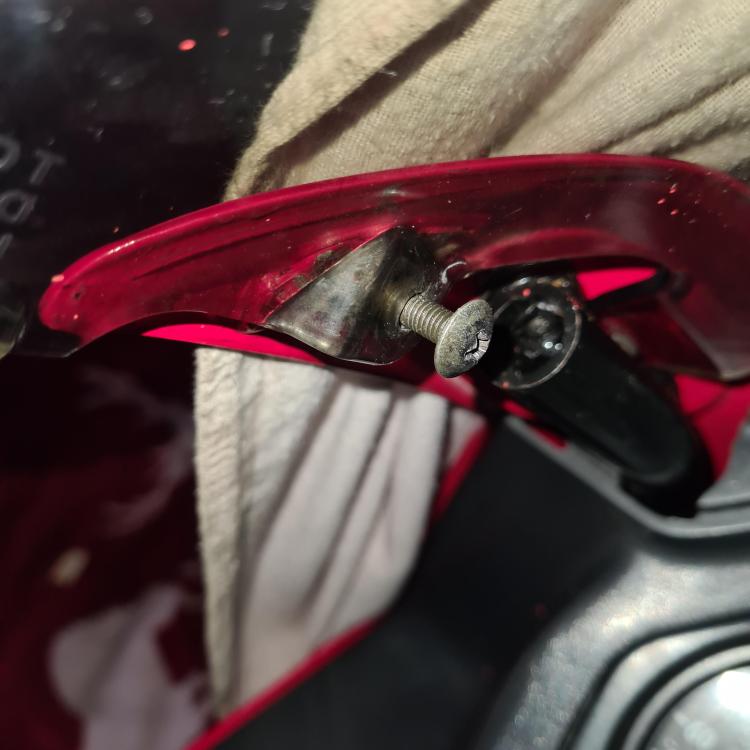

VFRRS Posted November 24, 2024 Posted November 24, 2024 I've just repaired the mounting lug to the upper fairing/dash cover,the small triangle ones. The spigot had snapped away from the fairing from a previous repair and had been incorrectly lined up. Upon tightening the 5mmx16mm screw into the triangle piece the angle off the threaded brass insert was way off and tension pulled the spigot and lump of old glue clean off. Having tidied the spigot up and ascertaining the correct angle I used good old super glue and baking soda. It's now spot on for alignment of the cover screw hole and is stuck like shite to a blanket. On 11/17/2024 at 10:45 PM, AaronRic said: Hey all - My new-to-me 1999 VFR 800 fell off the trailer last night, and broke a small section of the upper cowl. I'm planning to ABS cement that section back together, but I'm posting here (already posted WTB in classifieds) in hopes that 1) someone maybe has a red upper cowl they would part with 2) see if anyone knows a good way to repair ABS cracks, and 3) if anyone has any experience with eBay Chinese fairings. My gut says they're probably more trouble than they're worth, but figured I'd ask in case anyone has any surprises. I have Googled around about the Chinese fairings and have seen some answers, but the posts were all a bunch of years old, and I find it's always good to ask for yourself rather than rely on searches all the time. I've recently repaired the spigot which holds the brass insert for the upper cowl/dash side covers. Previous resin type repair had failed due to misalignment and broke away the fitting. I used super glue and baking soda to reattach the spigot at the correct angle to the fairing bracket. Stuck like shit to a blanket now👍 1 Quote

VFRRS Posted December 5, 2024 Posted December 5, 2024 Just fixed this upper mount spigot with superglue and baking soda...worked a treat! 3 Quote
