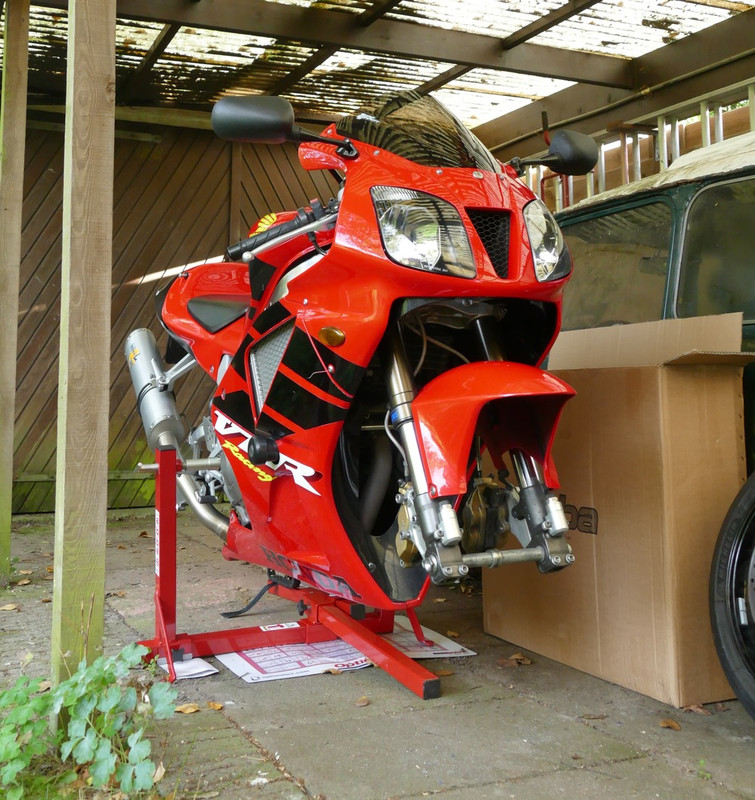

V4 Rosso Posted October 30, 2024 Posted October 30, 2024 With this Abba stand you will be able to not only lift both wheels of the ground but also remove the whole front end for instance when you need to replace head bearings. 2 Quote

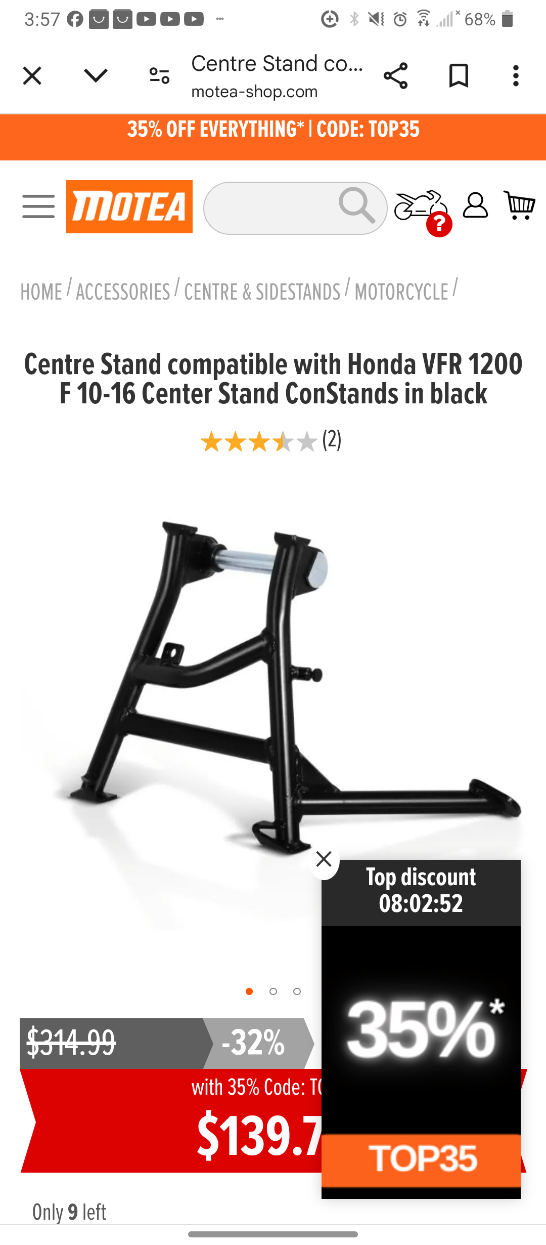

Member Contributer FromMaine Posted October 31, 2024 Member Contributer Posted October 31, 2024 5 hours ago, vfrcapn said: Yes, I would do this. I have used this approach many times to replace the forks and install new steering head bearings. Definetly the way to go for someone in your situation. I have no personal knowledge of this company, I just put this here for reference. 1 Quote
Member Contributer swimmer Posted October 31, 2024 Member Contributer Posted October 31, 2024 7 hours ago, FromMaine said: Definetly the way to go for someone in your situation. I have no personal knowledge of this company, I just put this here for reference. Even if a person didn't want to install a center stand permanently, it seems like you could just install the stand with just the large bolt quickly and no spring and lift the bike as normal with a center stand and then just pull the bolt and remove stand when you are done. Not much more work than the pitbull stand and cheaper. There is a company that makes a center stand(ish) lift .https://www.motostorm.it/en/accessories/equipment/lv8-e640h-honda-vfr-1200f-center-pad.html?currency=USD&size=UNICA&gad_source=1&gclid=Cj0KCQjw1Yy5BhD-ARIsAI0RbXbDH4g3u9108hEi2zVU9H1FOTU-QX8MVi2cBANu9jVE6Z48L_nmcLQaAp9xEALw_wcB 1 Quote

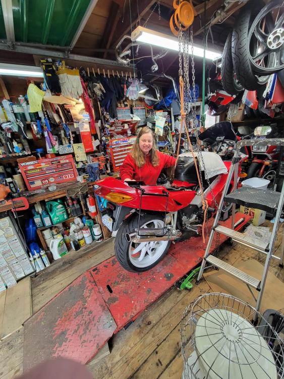

Member Contributer Stray Posted July 1, 2025 Member Contributer Posted July 1, 2025 I lift my front end with a pulley from the ceiling, strapped to the handlebars. It’s quick and easy and cheap. This allows me to remove the front wheel and full fork assembly for rebuilds. Can you hang the front end off the ceiling? The front end is quite light and can be lifted by hand. 1 Quote

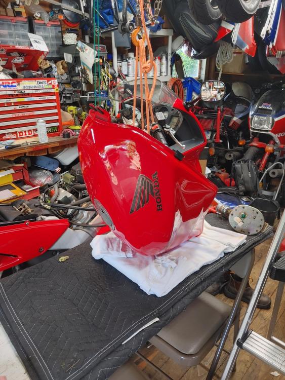

Member Contributer FromMaine Posted July 2, 2025 Member Contributer Posted July 2, 2025 As Stray points out, having a structural member in your garages ceiling has some benefits as far as options for lifting or stabilizing the bike I have a 1 ton chain hoist mounted above my lift. They are about $70 at HF. First pic I used my hoist to lift the bikes rear up as bit to do some work this Spring. Second pic I used the hoist to stabilize the bike at the handlebars as I was going hammers and tongs working on it this past Fall. Good tip over insurance without having to strap the bike down. 2 Quote
