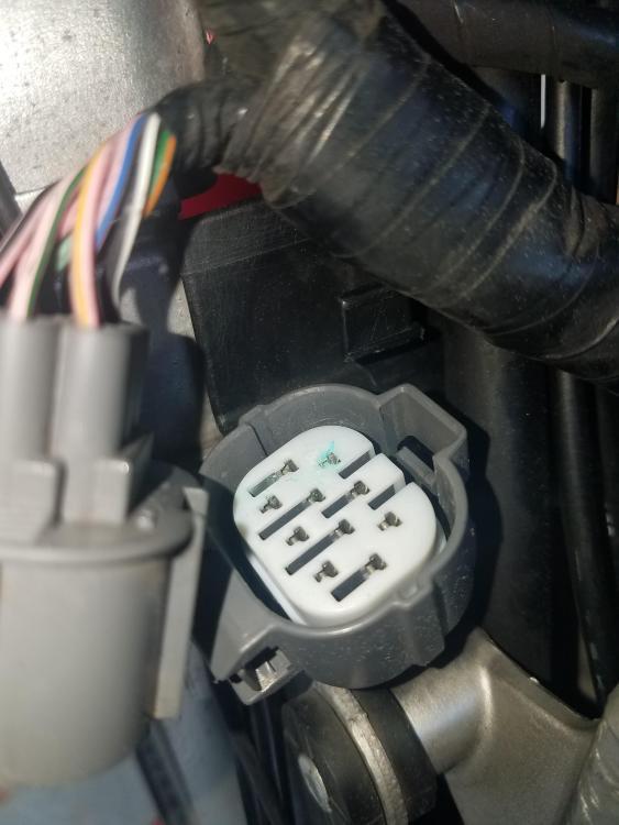

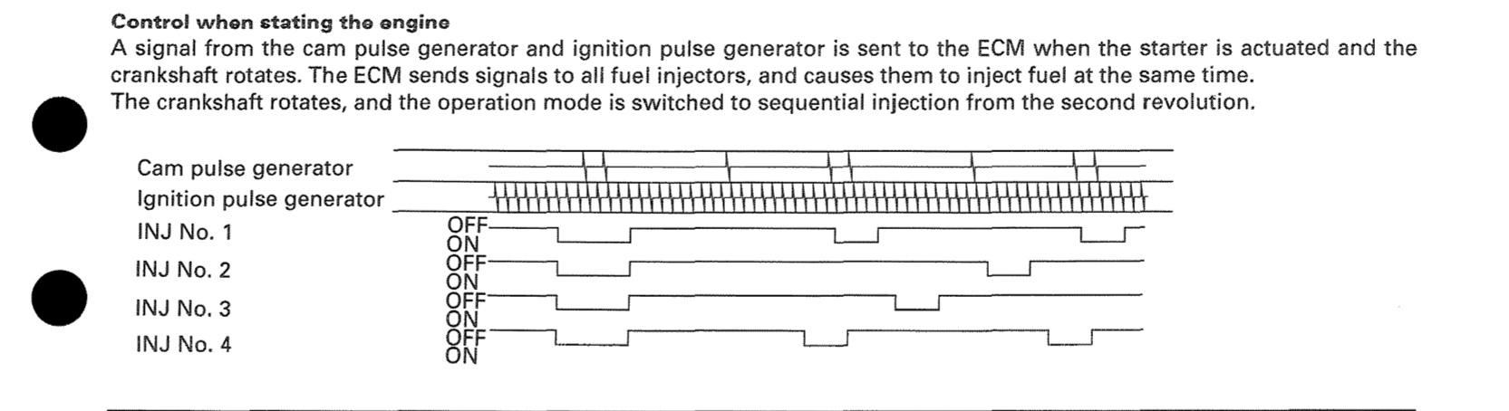

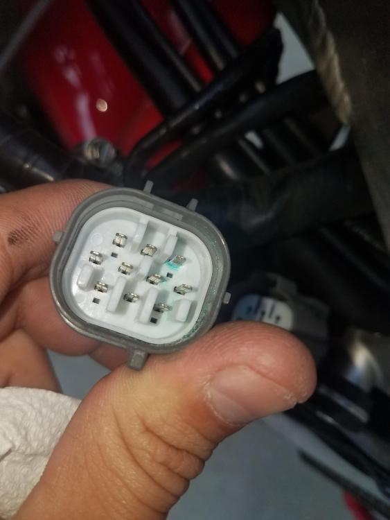

Member Contributer Grum Posted October 8, 2024 Member Contributer Posted October 8, 2024 Check the 10P Gray connector feeding the injectors. Make sure both pins and sockets are clean with no corrosion evident (see attached Note the green corrosion). Make sure you measure a good solid 12v for the injectors on the Black/White wire. Failing that agree with the other suggestions of professional clean and flow balancing of the injectors. If you have an O Scope handy, you could verify the Negative going drive pulses to each injector, see attached. And I take it you're not seeing any Fault Code for injectors from the Fi Light, Sidestand Down? Quote

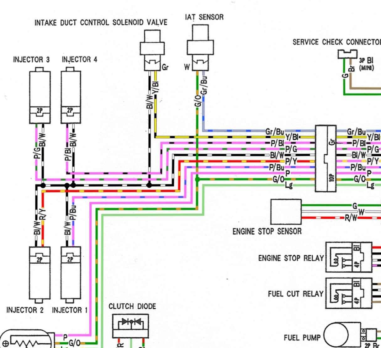

yellowvfr Posted October 8, 2024 Author Posted October 8, 2024 great info cheers guys. ill try thos suggestions. ill confirm feed to the injecors and then ill just pull out the whol lot and throughly clean it all. ill look into getting replacements too just in case. is there a part number of the injectors i could look up and see whats available. Quote
