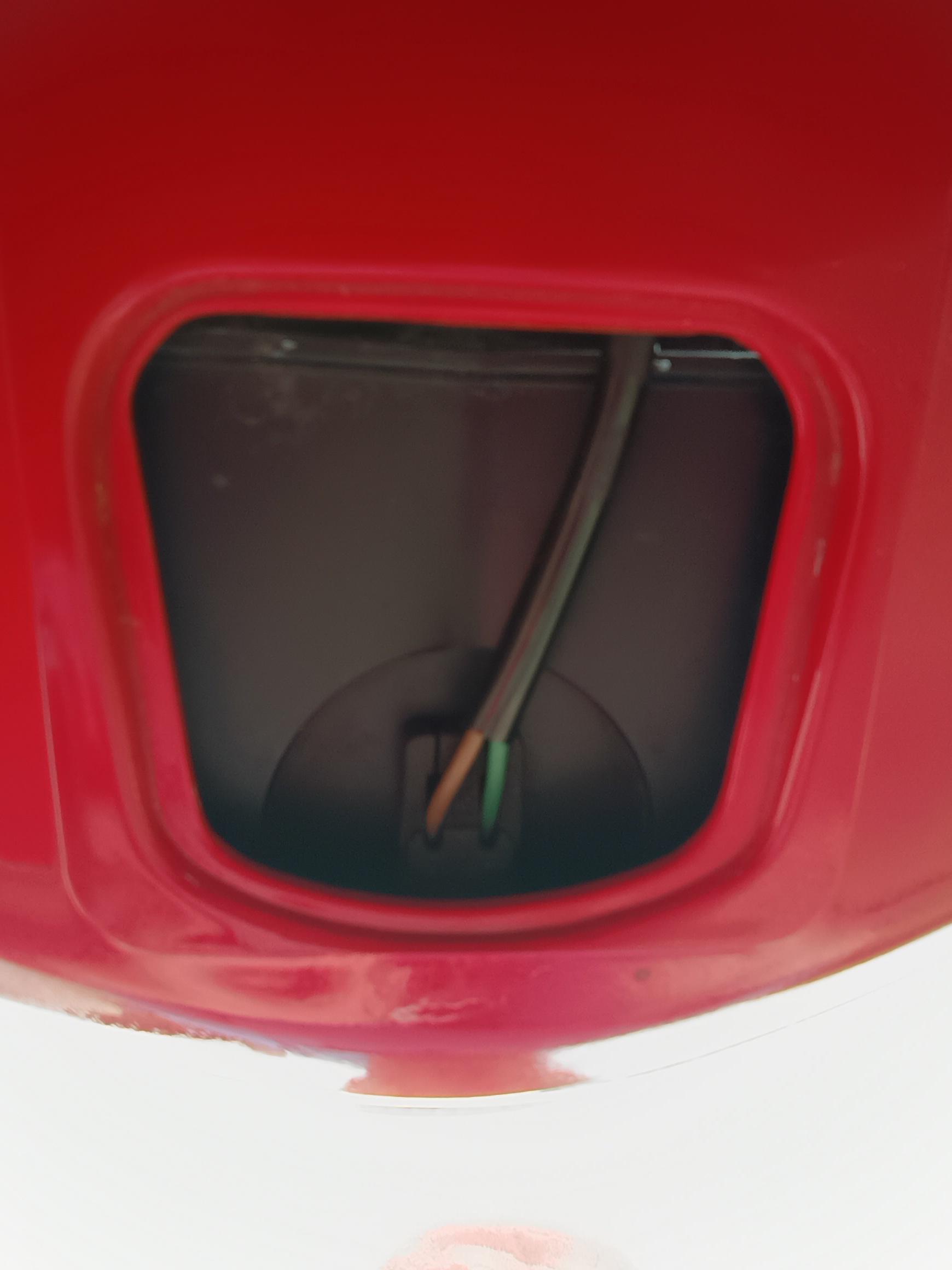

Member Contributer Mohawk Posted September 9, 2024 Member Contributer Posted September 9, 2024 The most important part on a 5th gen is a 2" square of plastic below the centre of the headlight. It's there to allow you the change the parking light bulb, but many bikes have lost it & it not being there allows water to spray onto the unprotected PCB of the dash, causing corrosion. Any kind of post pottage is likely to contain & accelerate any existing corrosion, so possibly a blessing & a curse at the same time. Make sure the PCB is clean. Soak with ACF50 &/or make a removable cover for the back & ensure the 2" cover is in place or tape over the hole to keep water out. Quote

Rustty Posted September 10, 2024 Author Posted September 10, 2024 Parking light cover? History I think 🤔 Quote

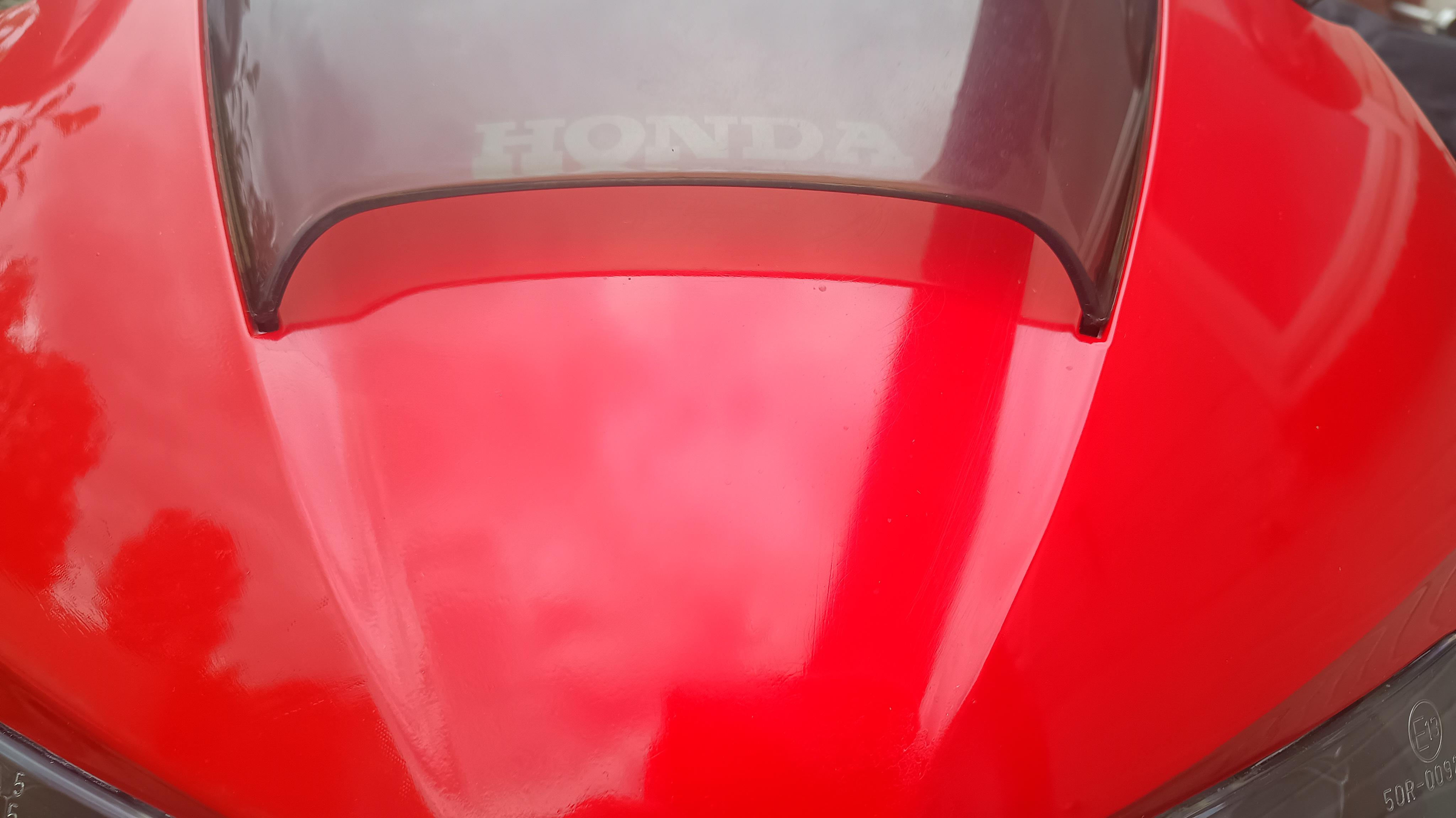

Rustty Posted September 10, 2024 Author Posted September 10, 2024 Dirty great gap at edge the the screen, designed to deliver rain right down the back of the clocks! The horror! Who signed off on this mess? And where is my rain shower proof headlight gasket? Quote
Rustty Posted September 10, 2024 Author Posted September 10, 2024 Jokes aside, I'll see if I can find the missing cover. And do a spot test with conformal coat on the film wire assembly. I don't wanna melt or damage it. Cheers 😁 Quote
