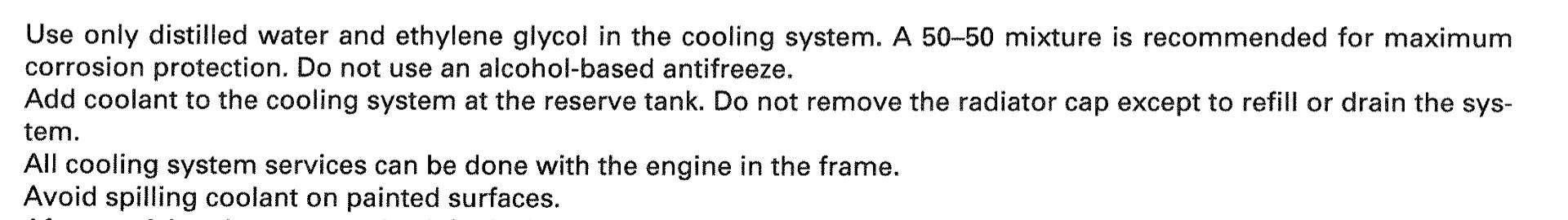

Service Manual states to top up via Reserve Tank.

I love how the FSM says all cooling services can be done with the engine in the frame.  Does this mean there was one person who thought you had to pull the motor to flush the cooling system?  LOL
