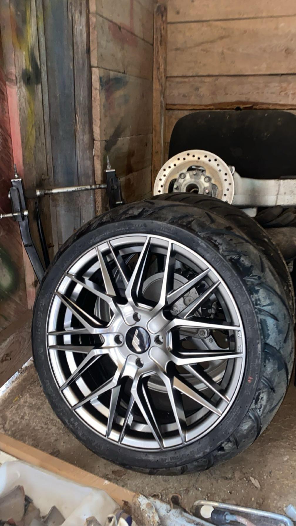

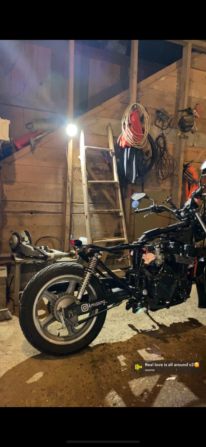

Hello!
I am currently on a mission to complete the conversion to sssa on my Honda CB750 and I was hoping to get some help from this forum since the sssa is from a 90-93 VFR750. I am having difficulties figuring out how big of a flange I need to make the car wheel fit and to be centred (I heard that a few mm off isn't too bad either). I was hoping maybe someone smarter could tell me where in what order and how to measure certain things so I end up with the right flange measurements. The car wheel I am using is 17x7 with a 42mm offset. I just had the local tyre shop mount 210/50/17 Metzler tyre on it. I have read some old threads where the adapter sizes run through but I don't know if they're relevant to me since the wheel isn't going under a viffer, just a viffer sssa on another Honda bike. I have my bike's rear end all removed (the picture was taken right before I dismantled it but maybe it'll help in some way) and ready for mounting/measuring. I hope that someone smarter can point me in the right direction.

Sounds fun! Give it a try. Here a are couple things I was asking myself while looking at your pics:
I'm an old school CB 750/550 head; the 750's back in the day use to have a "dry sump" lubricating system.
Is that still the case with your bike? If so is the oil tank still under the right side cover?
Will there be room for a single shock and linkage in the area that houses the battery and the oil tank, airbox?
Are you going stock air box, v/stacks or K&N's?
Is there room for the new swingarm at the pivot point @ the frame or will the frame get modified; just guessing the sssa is much wider than the stock one and probably cant be made narrower because of bearing/seal casting on the sssa?
I have used a dummy engine with an output shaft to help align the engine and sprockets with the rear but that was for a 100mph straight line bike...you have so many more variables.
Good luck keep us posted.

Thanks for the reply, the oil reservoir is on the right side, and I plan to mount the battery somewhere else (probably make a box or something for it under the seat). I plan to use the stock airbox but if it will get in the way of the shock mount then I'll just install pods or v/stacks as I have already had that planned in the past. The frame doesn't need any modifications because the sssa is quite much narrower than the stock arm, so I'm gonna need to have some bushings made. I'm thinking that I will mount the sssa to the leftmost side of the frame at the pivot point and then somehow measure out the right thickness for the adapter so it clears the swingarm, and chain and still be as center as possible.

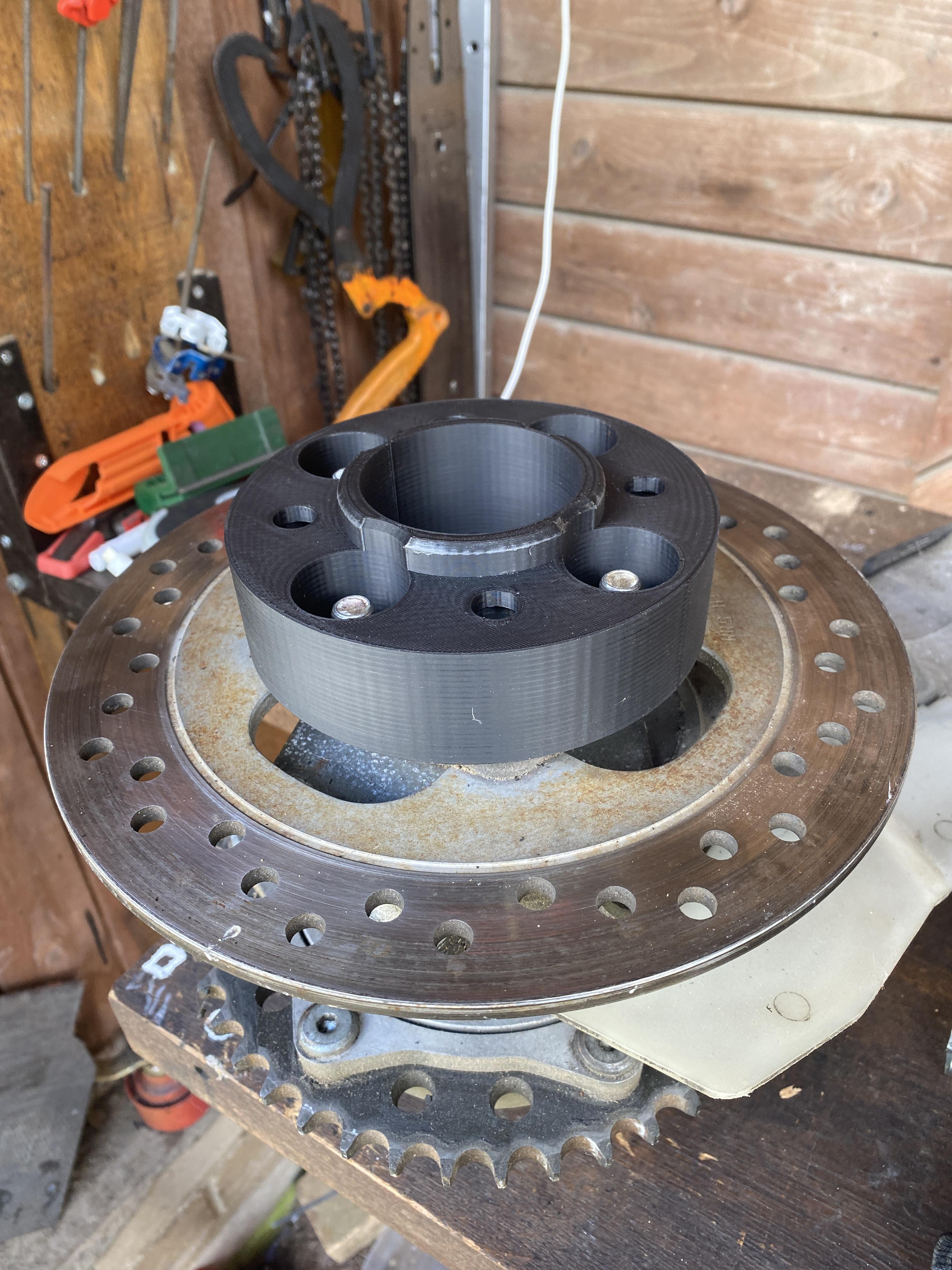

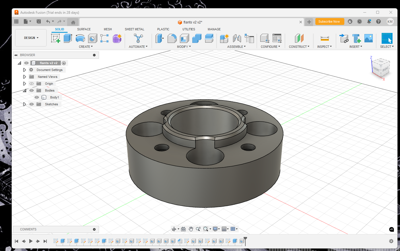

A little update on the build. Did a lot of eyeballing with my father and found out that the spacer should be 38mm thick to get about 5mm clearance between the tyre and swingarm. So I signed up for the Fusion 360 free trial and got to work without prior 3D modelling experience. I decided to 3D print my design before having it CNC'd to ensure that all the holes, etc., line up exactly. I will update this thread as I go along. If anyone has some kind of tips feel free to reply.

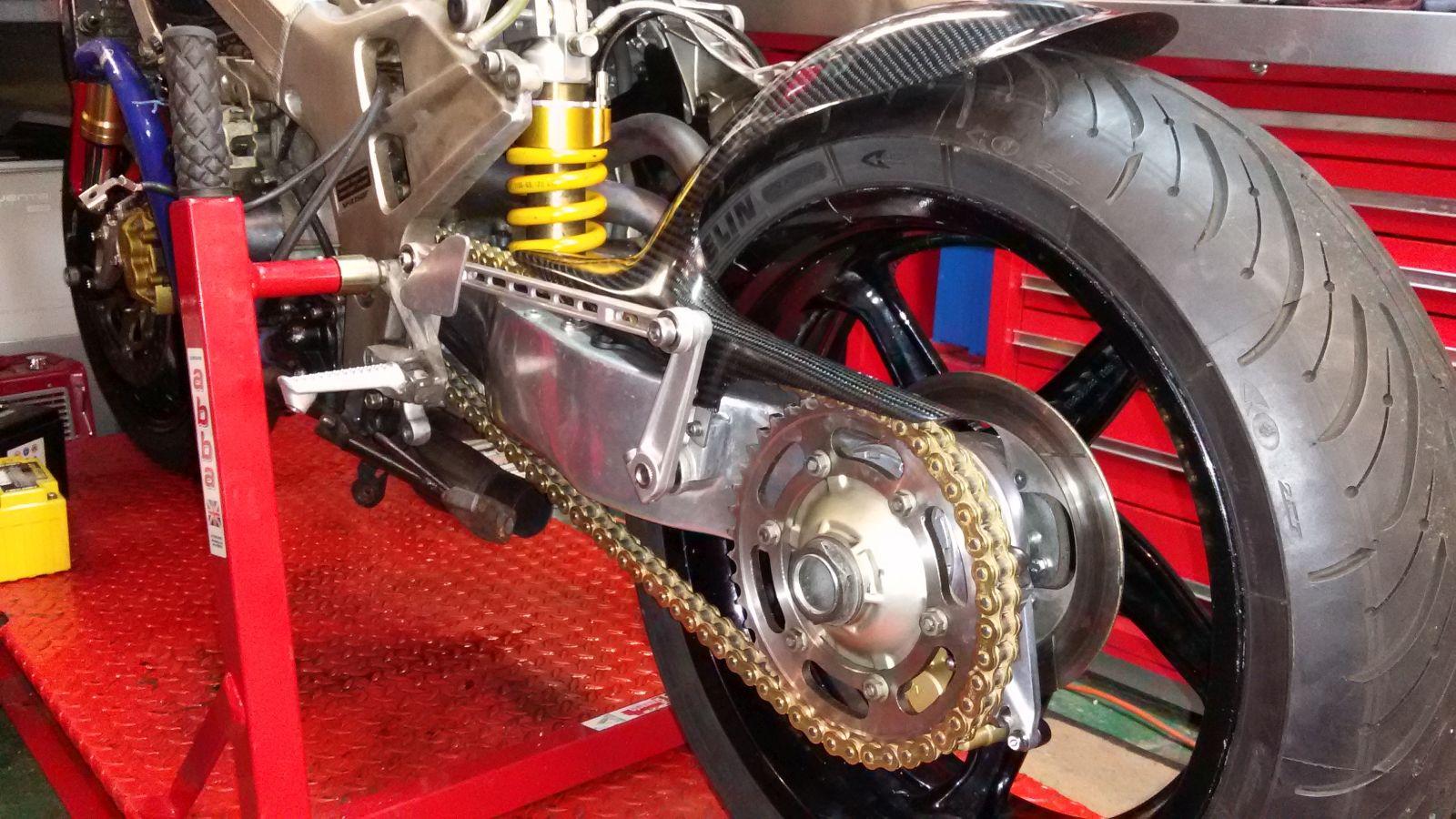

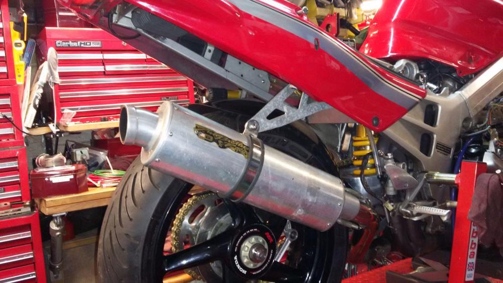

Honda SSSA wheels all seem to have the same offset.  Different widths, hub and drive arrangements, but for example, an NR750 wheel aligns perfectly on my RC30-swing armed '90 VFR750FL.
FYI, last time I installed, Fusion 360 was free to use non-commercially "in perpetuity".  There was some confusion about that a while back, but the free version is still free, and is not limited in time.  I can't remember what you have to do after the "free trial" expires, but I did it.  YouTube will reveal all.
