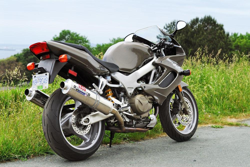

Member Contributer Terry Posted August 11, 2024 Author Member Contributer Posted August 11, 2024 3 hours ago, Lorne said: How did I miss your VTR pic? They are such great bikes, but with an SSSA and a 21 litre fuel tank they'd have been near perfect. I had a red '97, too, and this 2005 back in the late '00's. Yes I was very fond of my VTR. It was another of the "it's too cheap!" purchases and I was slightly amazed that my wife thought it was a good idea, and then consented to us driving 200km to collect it the next day...My 97 was a Japanese import (complete with a dropped Japanese coin sitting in the V) and over a couple of years I fitted manual CCT's, some gutted stock exhausts, Ohlins shock and Racetech goodies in the front, plus CBR954 calliper and master. It was a great handler, and just loped along. I sold it for nearly double what I paid for it (as long as you ignore all the extras that I added, maths was never a strong suit for me...). 2 Quote

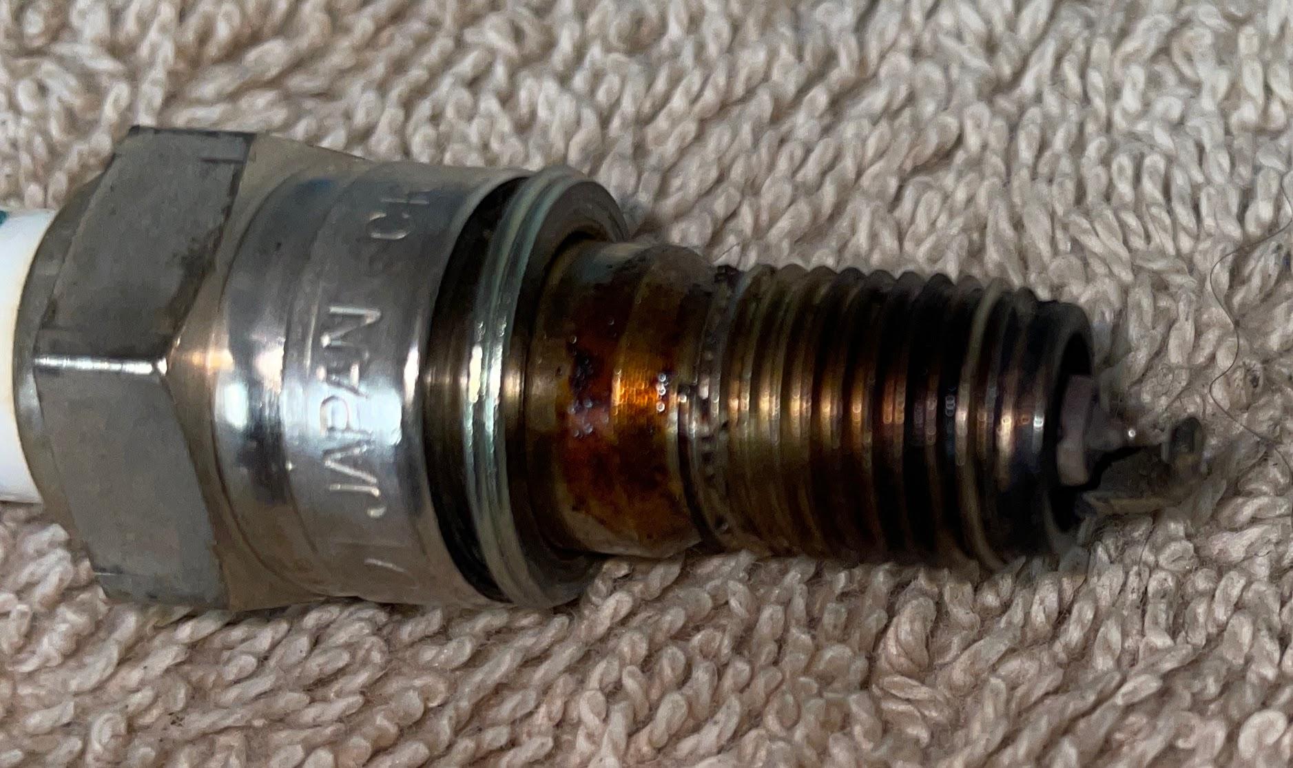

Member Contributer Terry Posted August 11, 2024 Author Member Contributer Posted August 11, 2024 I spent a bit more time on the VFR during the week as my long-awaited iridium plugs arrived; I was not in a tearing hurry and bought them new on eBay from a US vendor, US$90 delivered, vs local pricing of US$134. The old plugs looked like original items being Nippon Densos and very well worn. The plug change was easy enough except for the right rear coil retaining screw which was a complete bastard to undo, requiring penetrating oil and an impact driver before it cried enough, and of course I had to remove the tank to get access. Whilst I was in there I also disconnected the PAIR solenoid plug and plugged the intake flapper actuator as well. Those changes all seem like good things, and the flat spot before the VTEC activation seems to be much less noticeable, whereas previously it almost felt like the bike was running out of fuel. Had a lovely 300km ride to celebrate and it was all good. I know the flapper has no effect barring sound but I happen to like that. For good measure and because the weather was nice, I also pulled the big blue bus out for a 300km run; I had forgotten just how comfortable and well-suspended this one is, and it made me think about a suspension upgrade for the VTEC... 1 Quote

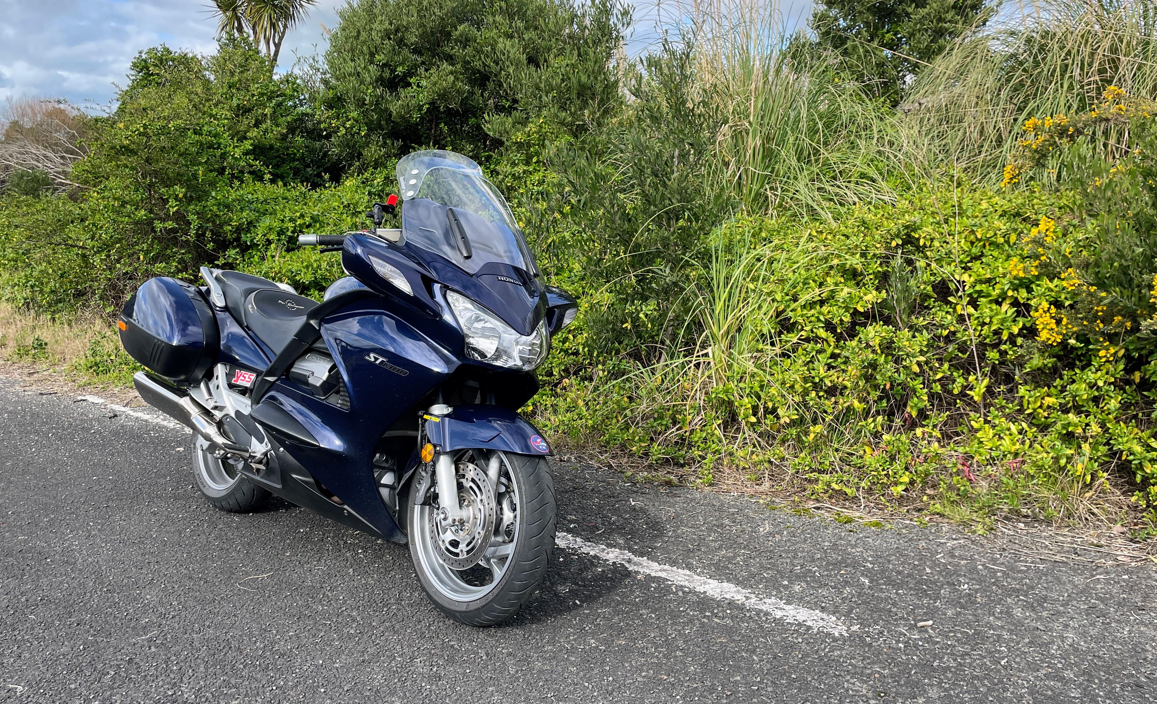

mello dude Posted August 13, 2024 Posted August 13, 2024 1 hour ago, Terry said: My choice was based on a favourite Youtuber, Projectfarm: https://youtu.be/XXOX4z6uwXo A huge thumbs up to ProjectFarm! 1 Quote
fabio222 Posted August 13, 2024 Posted August 13, 2024 1 hour ago, Terry said: I have used this on my ST1300: https://cerakoteceramics.com/cerakote-ceramic-trim-coat-restoration-kit/ My choice was based on a favourite Youtuber, Projectfarm: https://youtu.be/XXOX4z6uwXo ProjectFarm is the best. 2 Quote

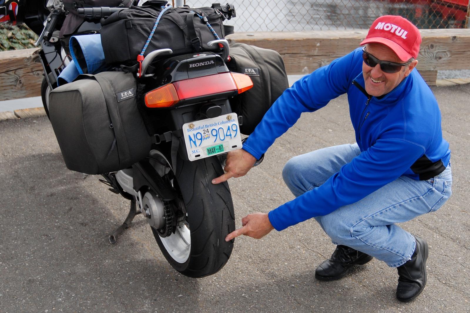

Member Contributer Lorne Posted August 22, 2024 Member Contributer Posted August 22, 2024 (edited) 7 hours ago, Terry said: I am not someone who just keeps going until the tyre cords start to show. The majority of my mileage has been on my trips to California, annually till covid. Typically around 5-7,000 km round trip. A lot of their secondary highways have really coarse pavement texture, good for traction but not so much for longevity. The tire in this embarrassing pic is an original Pilot Power. We'd just arrived at the Port Angeles ferry terminal in Washington State after a morning ride up from Seaside, Oregon. The night before we'd inspected the bikes and checked the chains, oil level, and tire wear. My rear's wear bars were getting pretty thin, but no worries as it was only about 350 km more to get back home. Was a bit of a shock when my pal Tony spied the rear's condition. ps. my cam chain tensioners from Webike Japan arrived today. Now to figure out whether I am brave enough to tackle the job of installing them - thanks again for the tip. Edited August 22, 2024 by Lorne corrected a typo and added a line or two 1 Quote
TimC Posted August 22, 2024 Posted August 22, 2024 9 hours ago, Lorne said: The tire in this embarrassing pic is an original Pilot Power. We'd just arrived at the Port Angeles ferry terminal in Washington State after a morning ride up from Seaside, Oregon. The night before we'd inspected the bikes and checked the chains, oil level, and tire wear. My rear's wear bars were getting pretty thin, but no worries as it was only about 350 km more to get back home. Was a bit of a shock when my pal Tony spied the rear's condition. That happened to me with my 6th gen. several years ago during a trip to the Skyline Drive in Virginia. My rear tire looked fine when I was leaving home. When got to my hotel in Front Royal, VA, I was alarmed at how thin it looked. I think the tire wore much faster than usual due to a combination of abrasive road surfaces, a loaded bike, and hot weather. I looked online for any local motorcycle shops where I might be able to get the rear tire changed the next day, but there was nothing close. I had planned to ride a little of the Blue Ridge Parkway that trip, but that tire was already getting thin, and when I got to the BRP a warning side said 'Loose stone' (chip seal) for the first 12 miles. No way I was risking that, so I turned back toward home. By the time I got home I was showing cords in a couple spots. Quote
