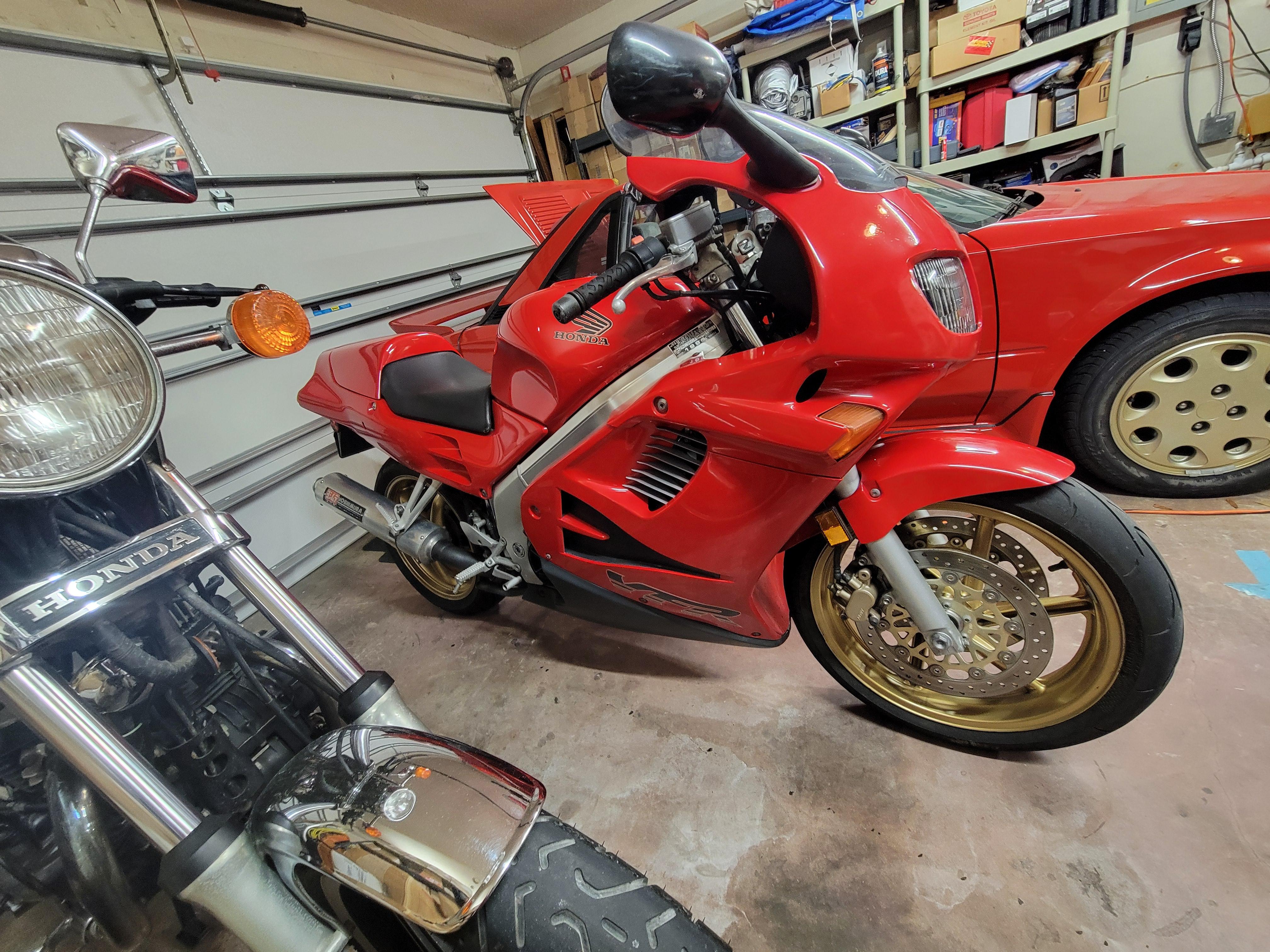

Hello all. I'm not new, but I have a new VFR. I bought a 1995 750 today. Browsing Facebook Marketplace can be fun, but sometimes expensive 😀. I probably paid too much for the bike, but it is in good  shape and they don't come up for sale too often. It has almost 50k miles on it, but that didn't worry me much. I was disappointed to find that the tool kit was missing, so I'm going to have to find an appropriate pin wrench to adjust the chain. Charging system looks good (at least for now). All the plastic is there, but there are some small cracks and a few missing tabs, but I think it is all fixable. The inside of the tank looks almost new. I go to get my tag on Friday, and I'm looking forward to taking it out for a ride. Here it is, nestled between the 1982 Nighthawk 450 and the 1988 Supercharged MR2.

Since my wheels are gold, I assume they aren't stock since I read that all RC36/II had black wheels. I wonder if they were painted or maybe came from another bike. Either way, I like it. The gold sets off the gold color in the "VFR" decal on the side fairings.

Very likely painted or powder coated.  That rear wheel is unique to 94 - 97.

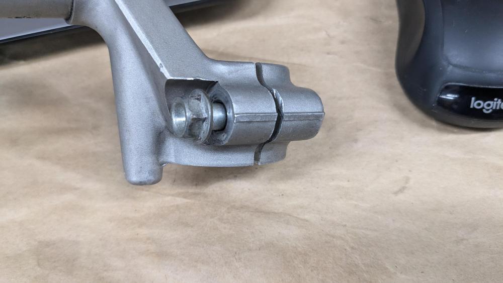

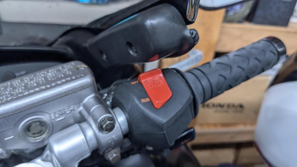

I find that the stock position of the bars on the 90 - 97 are a little too angled inward for my preferred riding position.  There are lugs on the clip-on that can be cut off and it allows you to rotate the bars more forward a fair amount.  I make that mod to all of my bikes that have room at full lock for the bar to rotate around bit and not let anything hit the cowling.  It "opens up" the cockpit a bit and makes a big difference to make a bike feel how you would like.

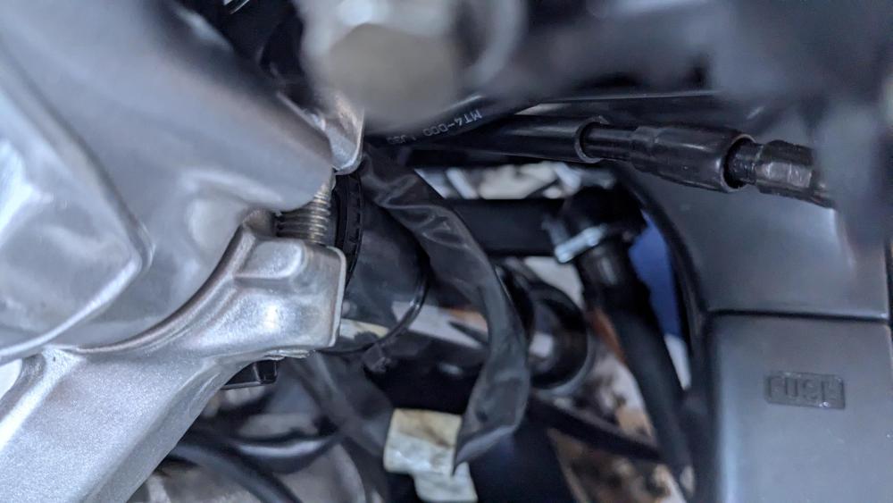

Still plenty of clearance...
If it seems good for you, disregard.  Other's might find it useful.

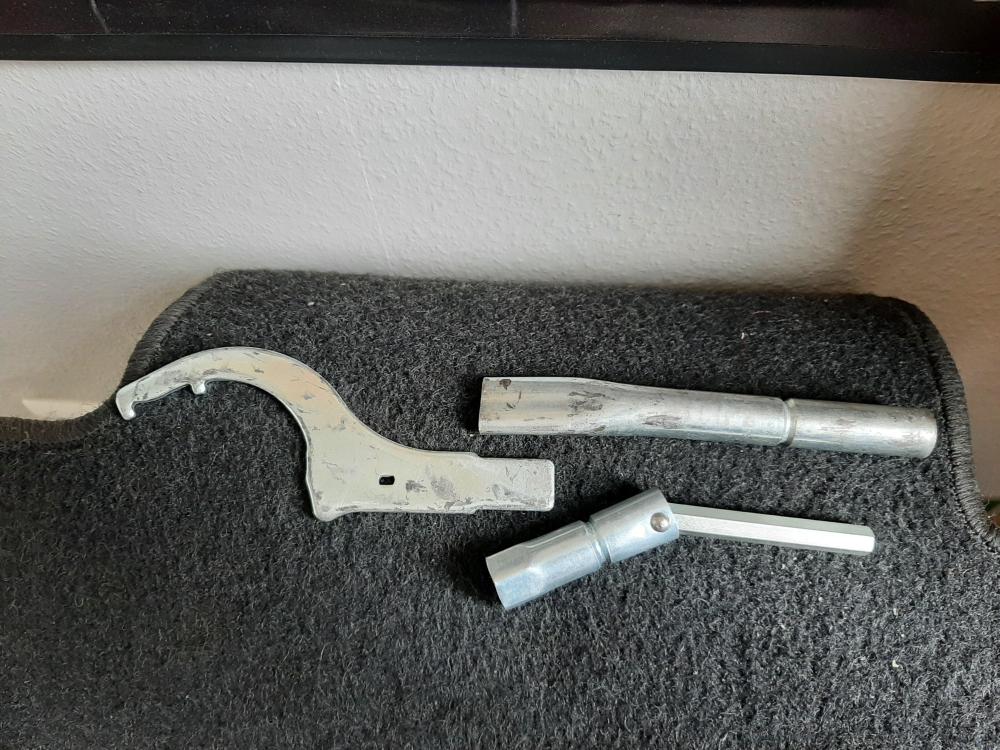

These the "VFRcritical" tools from the kit
