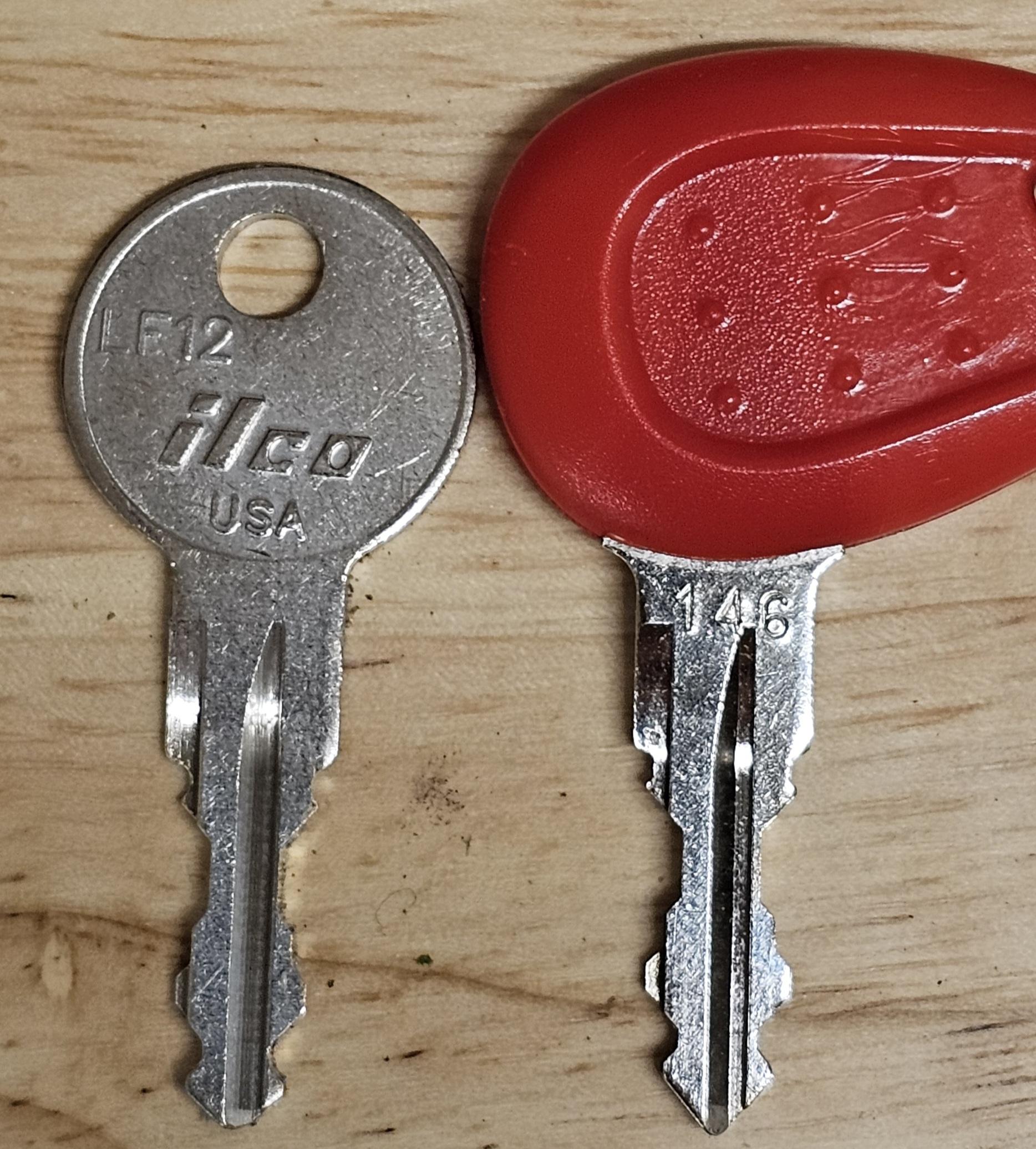

I've confirmed the giant red Givi Monokey that doesn't fit well on a keyring can be successfully copied using Ilco LF12:

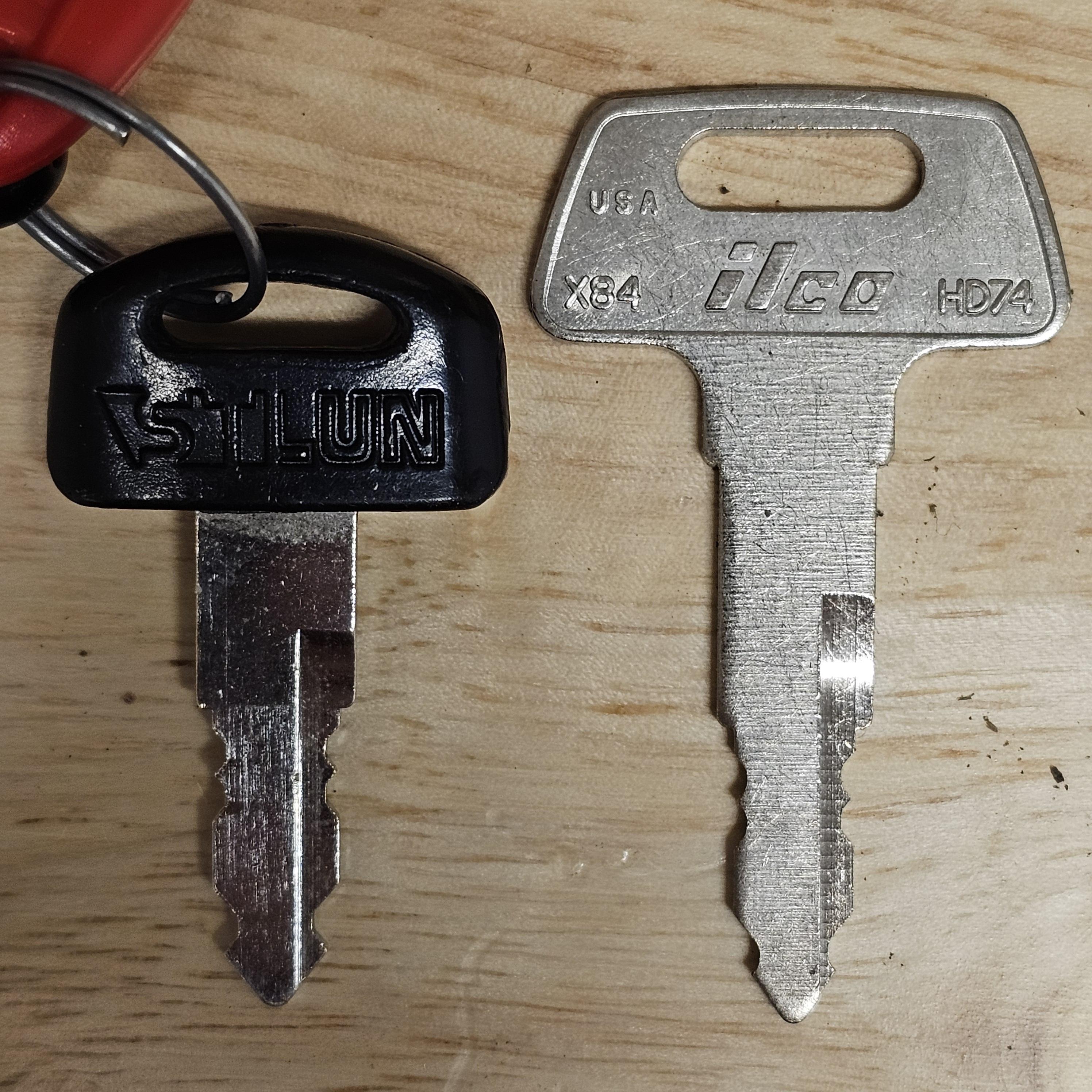

The STLUN/Emgo Chinese top box key can be copied using Ilco X84/HD74:
1000007480.thumb.jpg.de67ee26b8429e675c54f1871e0524ec.jpg1000007481.thumb.jpg.b5078d4ad239d5513d27d7d742ded54c.jpg

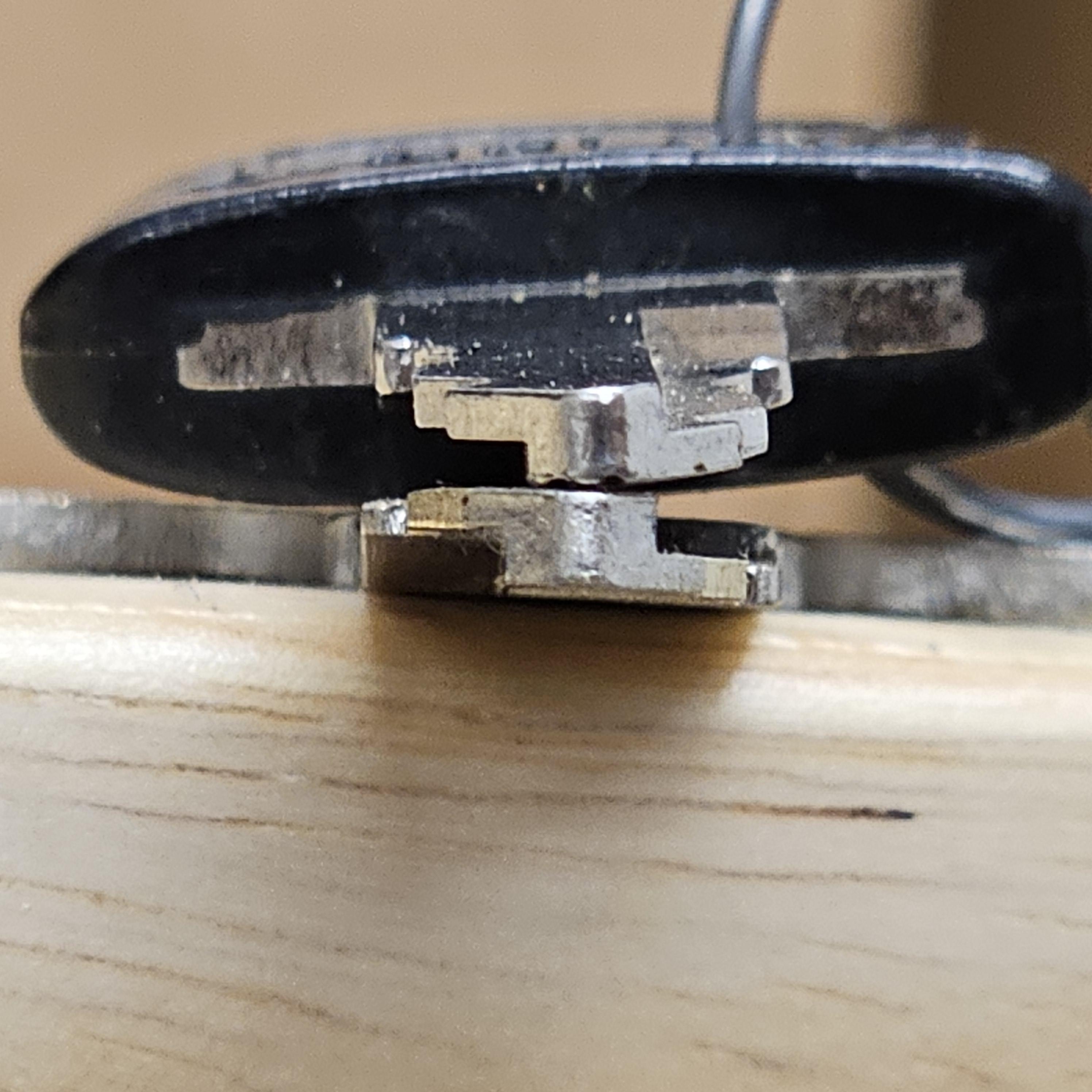

And finally, the Honda key used in a 5th gen VFR (I assume other gens as well) can be copied using the same key! Ilco X84/HD74 can be cut to fit both the Honda ignition and the STLUN/Emgo top boxes!

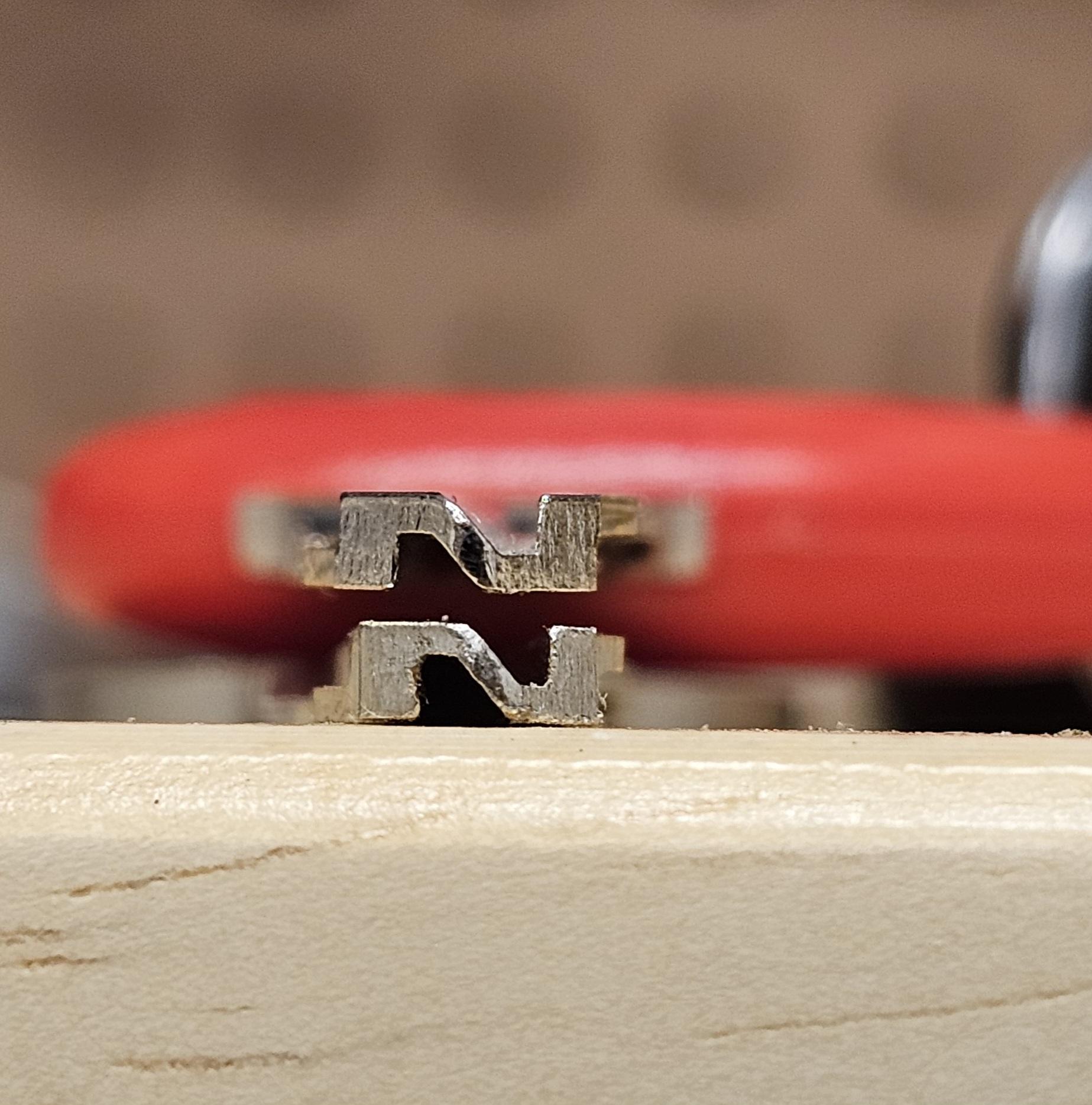

Naturally, this has led me to look into keying the two alike, so one key can start the bike, unlock the seat/helmet lock, and open the top luggage case. Unfortunately, when I took the cylinder off the STLUN/Emgo case, it appeared to be crimped sealed at the factory, and it uses some kind of weird square tumblers so that even if I did bend it open, I don't know of a good source for square tumblers to key it with. Being a brand with little support, I have doubts I will ever figure out how to order spare cylinders or pins to fit it.
I didn't look into rekeying the Honda ignition and seat lock since I'd much rather mess with a $100 top case than my bike's ignition. Also, I doubt Honda has any official support for rekeying their cylinders with custom key codes. If anybody has done that, I would be very interested.
Unfortunately, the Givi Monokey keyway is very different than the ignition key, so it's probably not a good candidate for matching the ignition key unless somebody could retrofit a STLUN/Emgo cylinder in one. For now, I'm just happy to have found some more compact metal keys I can carry on my key chain instead of three separate large rubber head keys.
