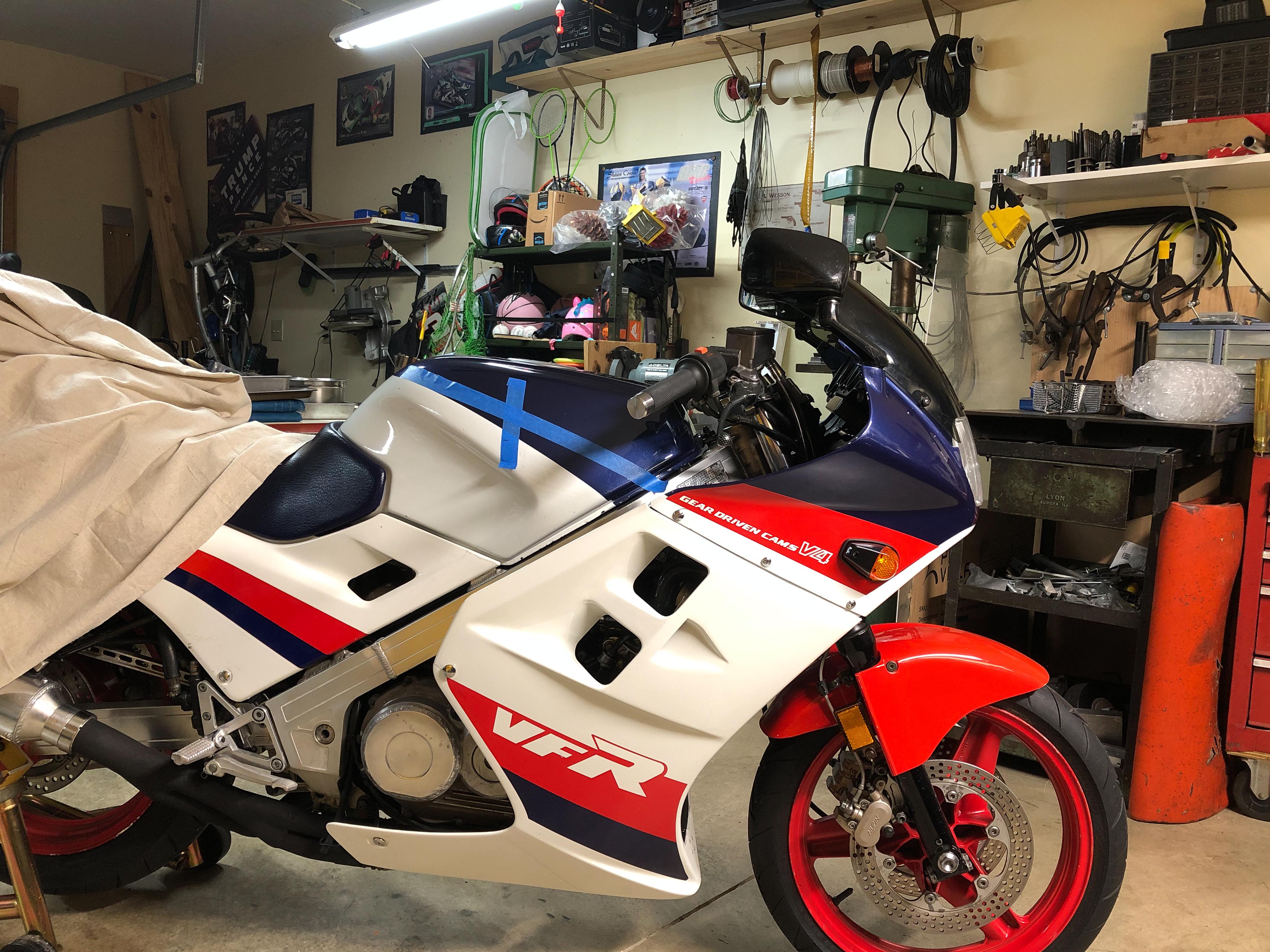

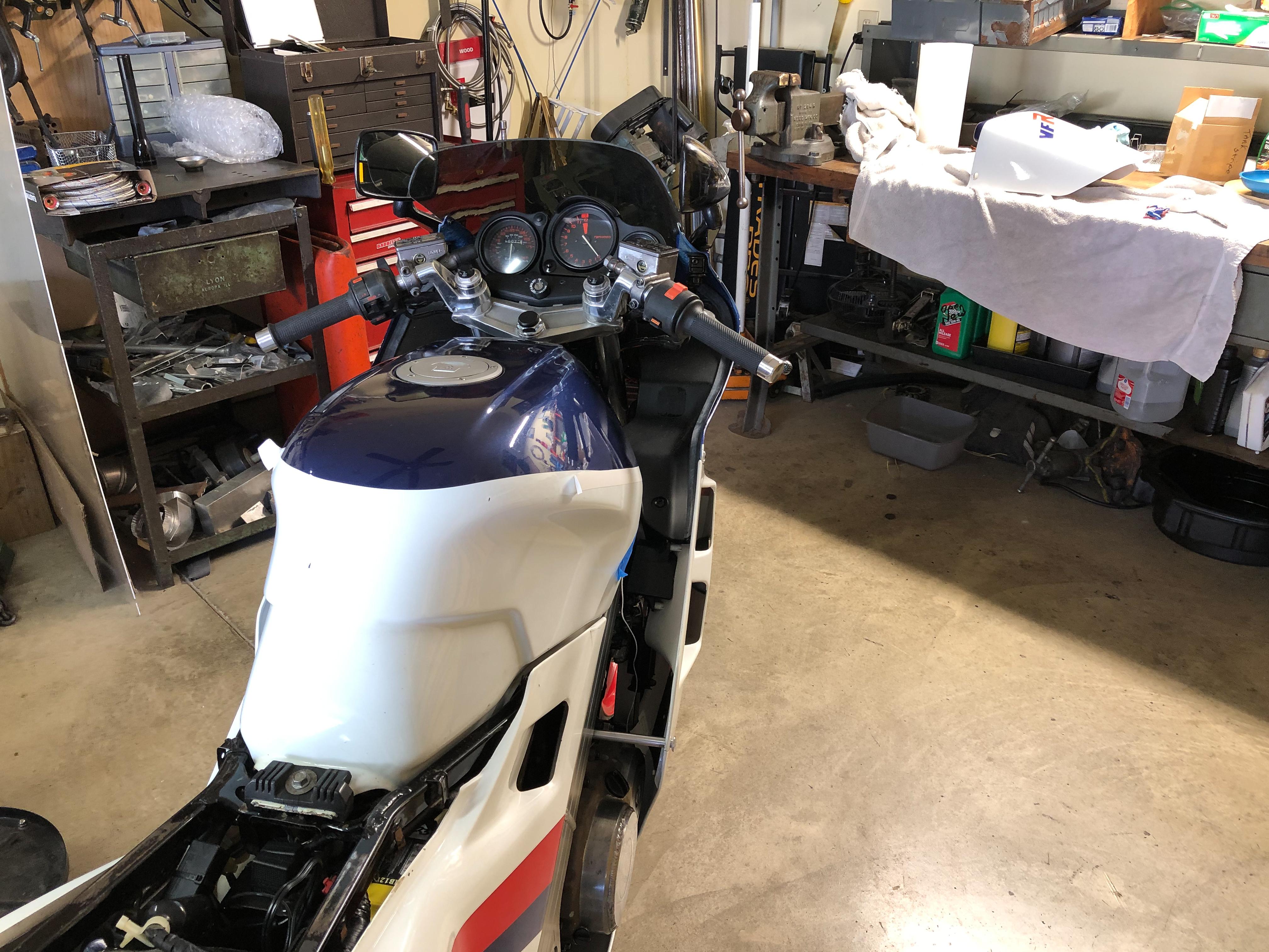

Hello, I've been putting together an 86 700F for a while now and have come to a point in the build that scares the hell out of me.

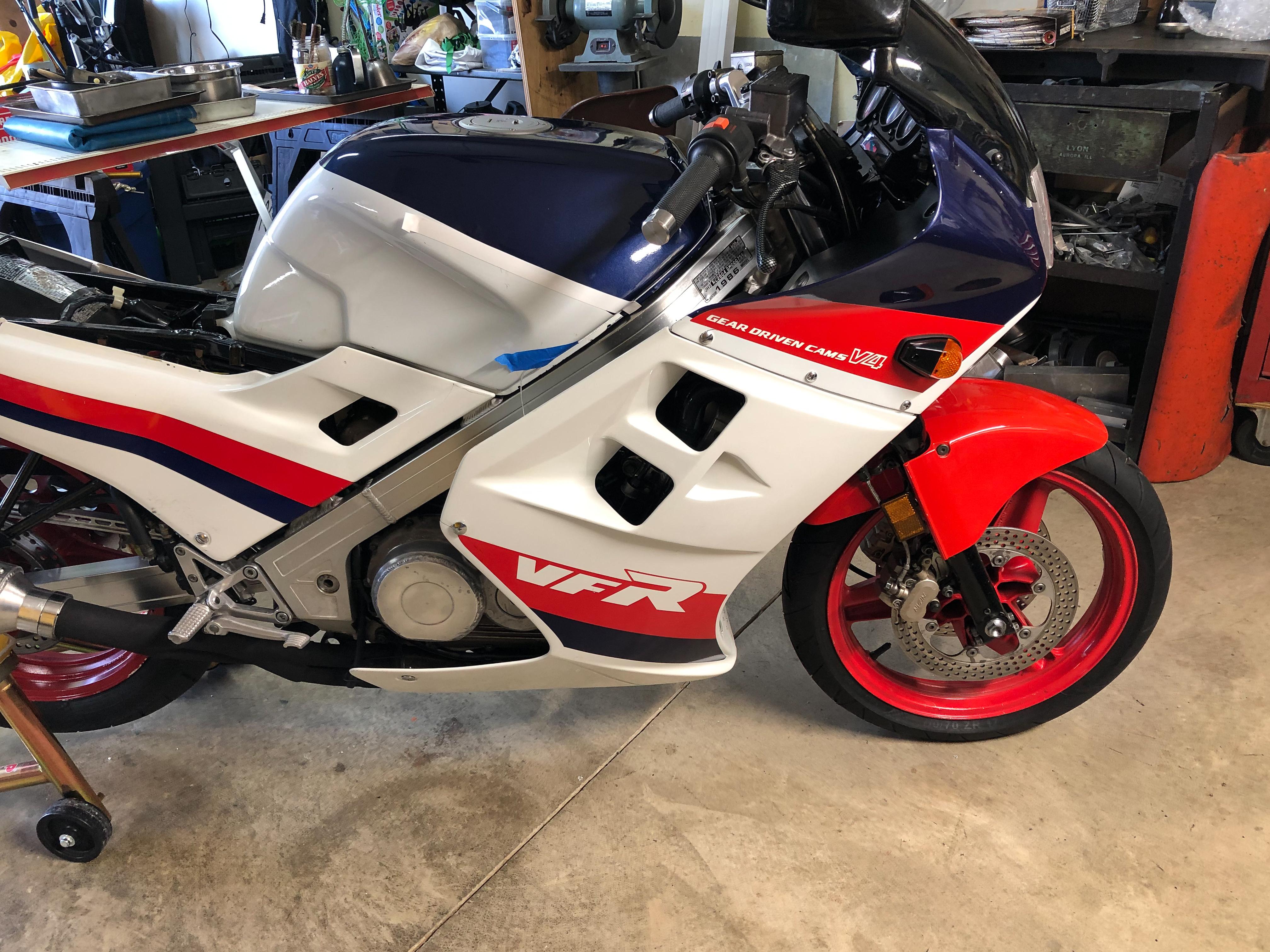

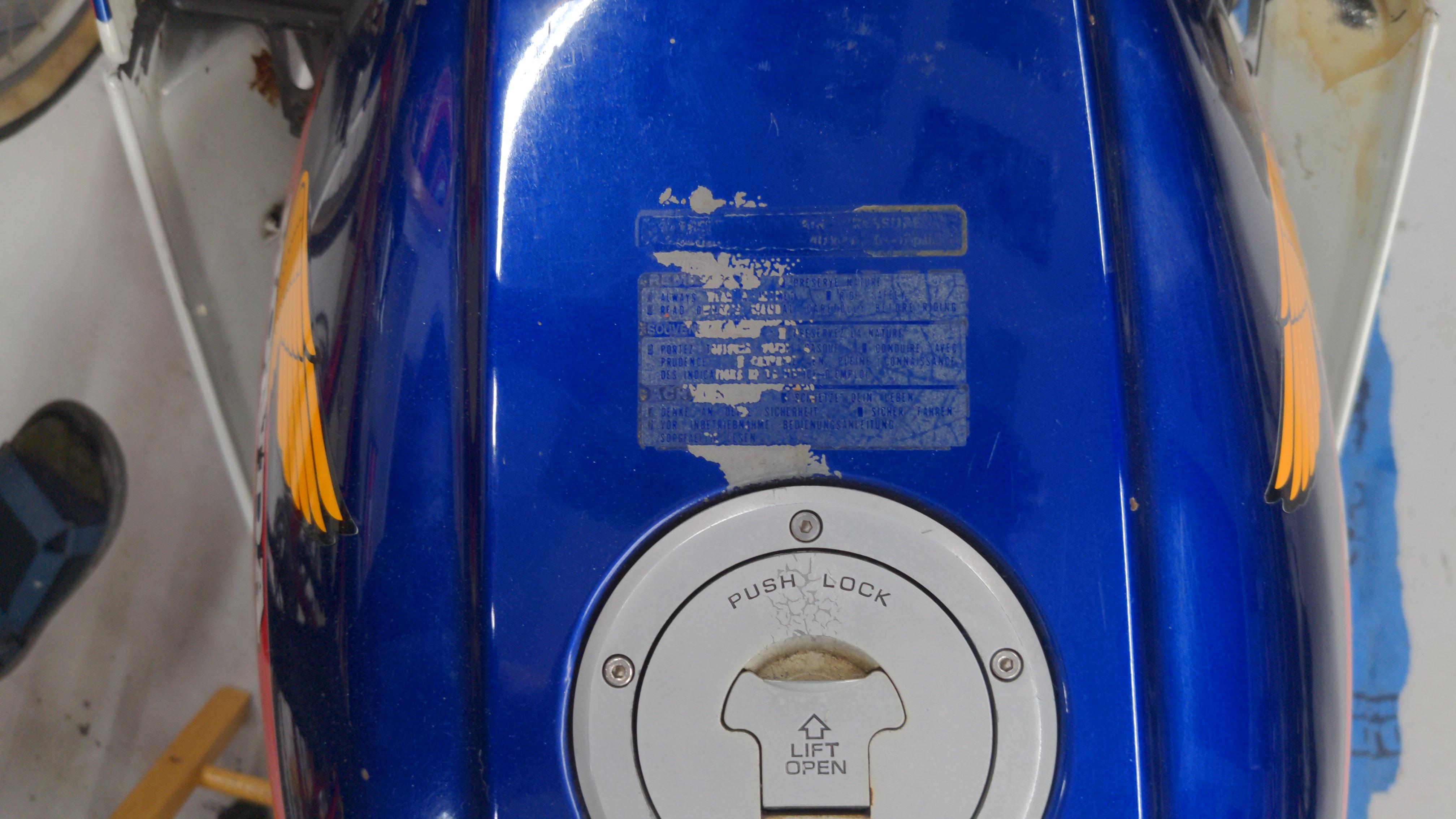

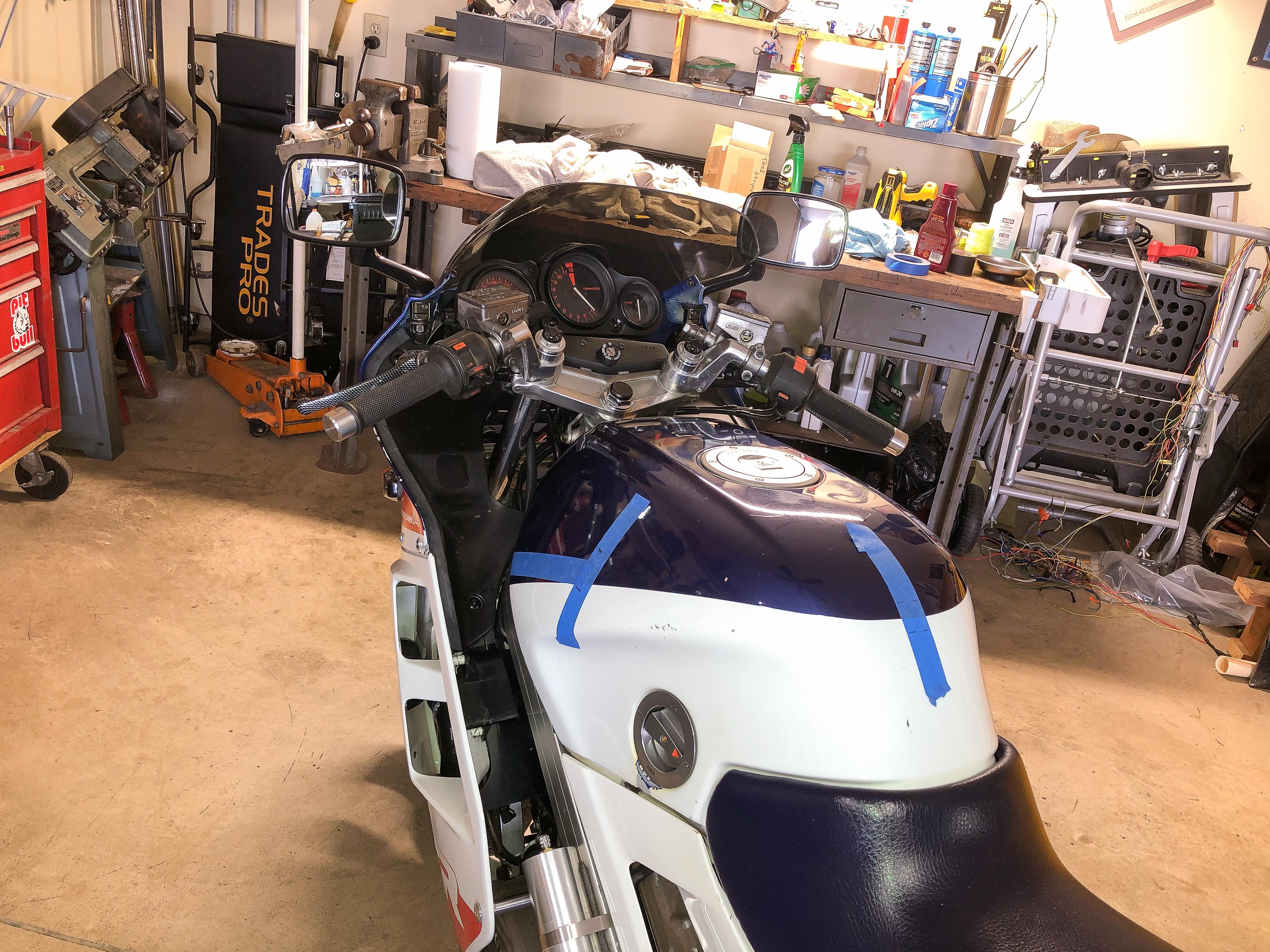

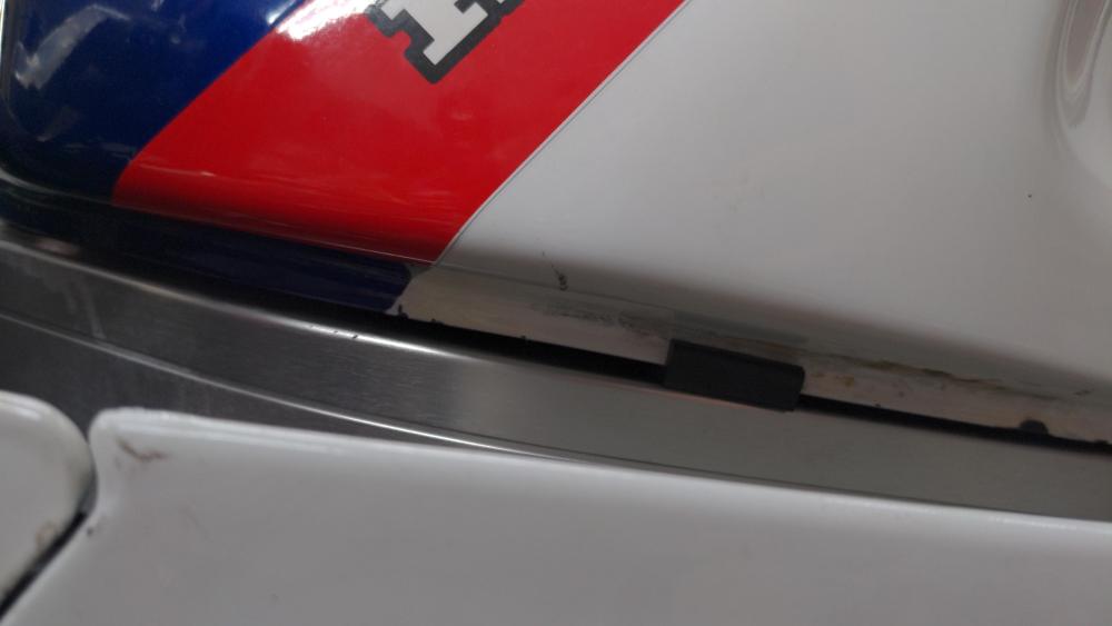

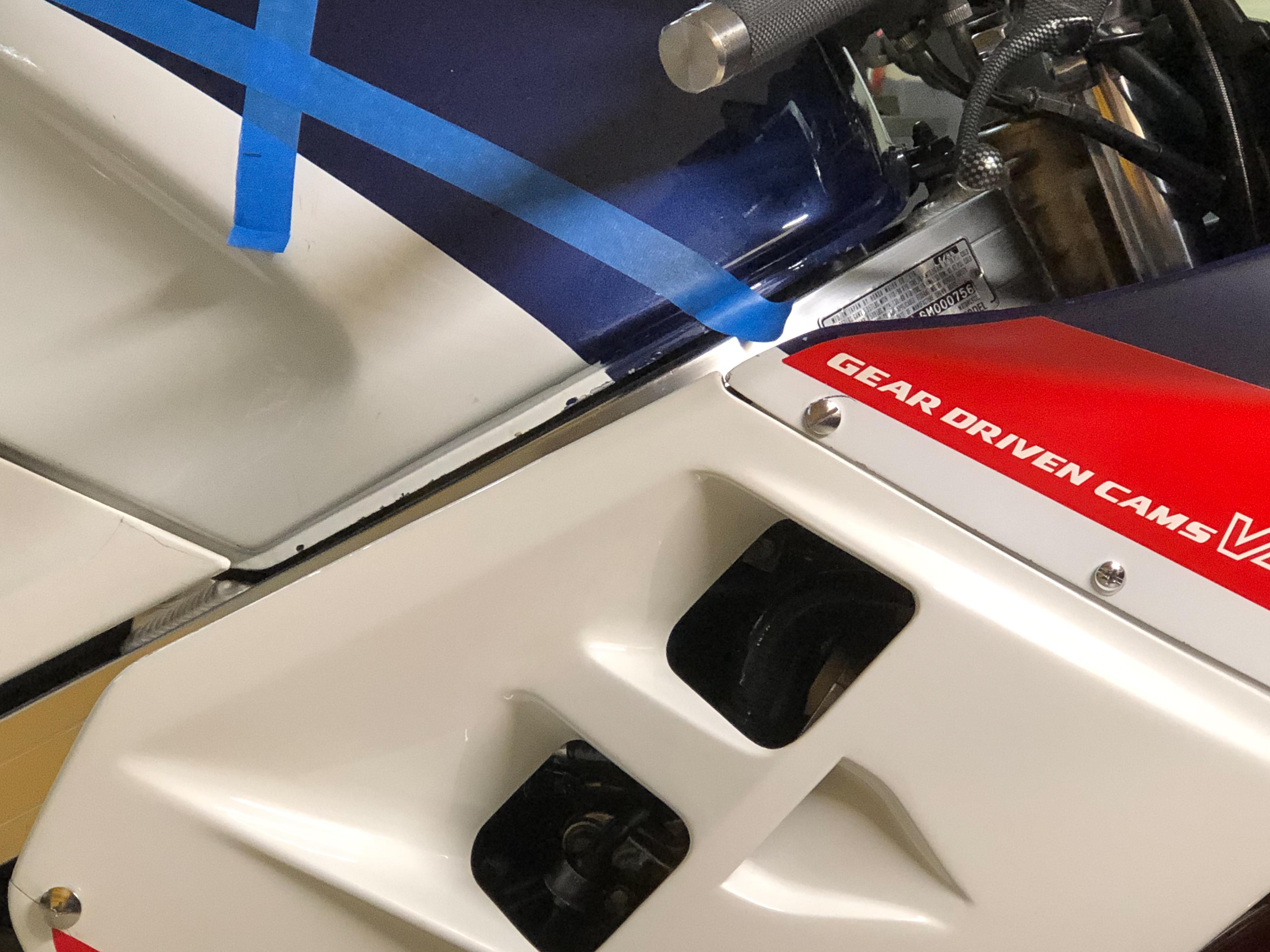

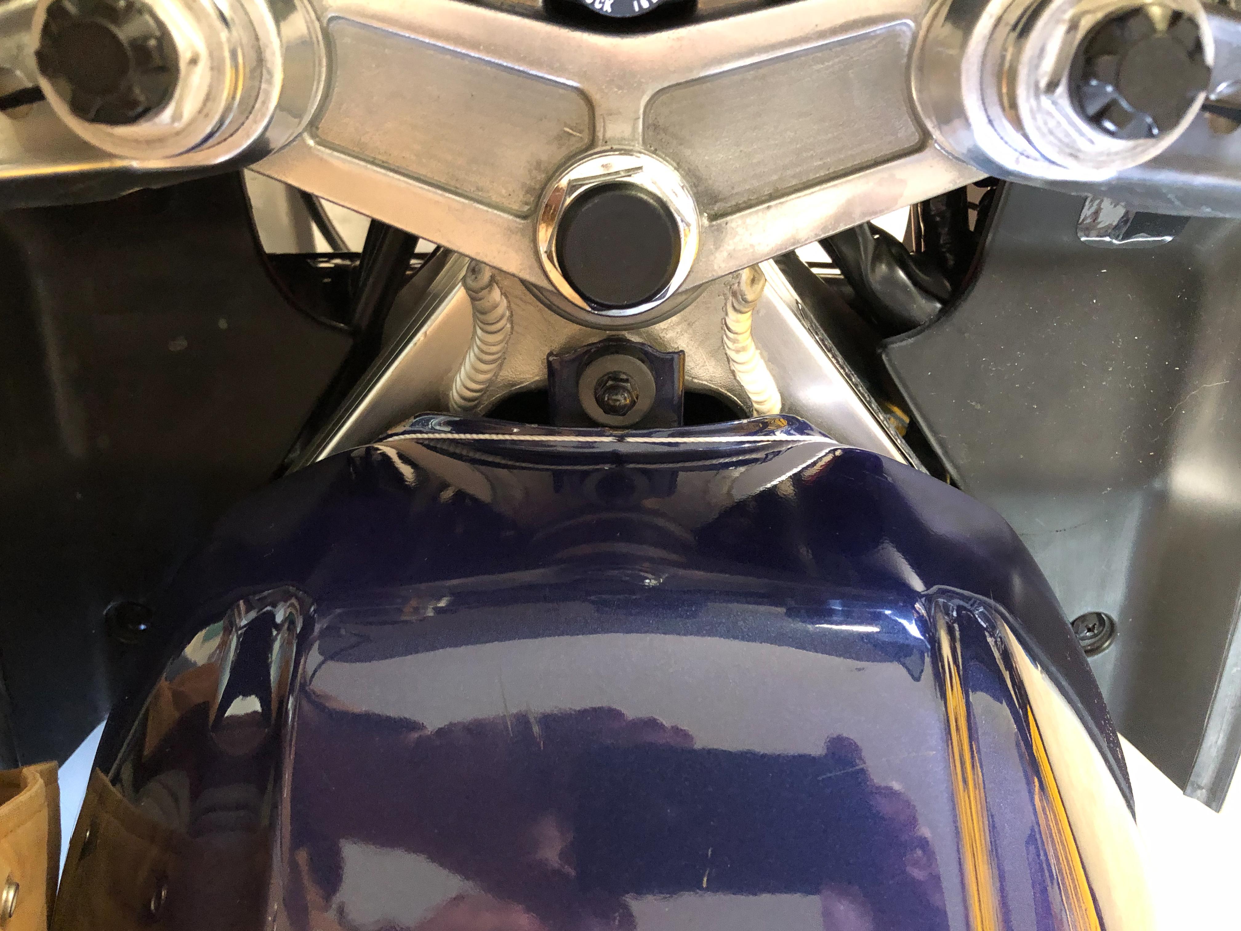

I need to wrap my head around the idea of repairing or respraying the two tone paint on my fuel tank then applying the trim stripe with the "Honda" wings. The biggest problem is the blue/white color transition on the tank as it sits now is off location in the front; the blue will be showing above and below the decal.

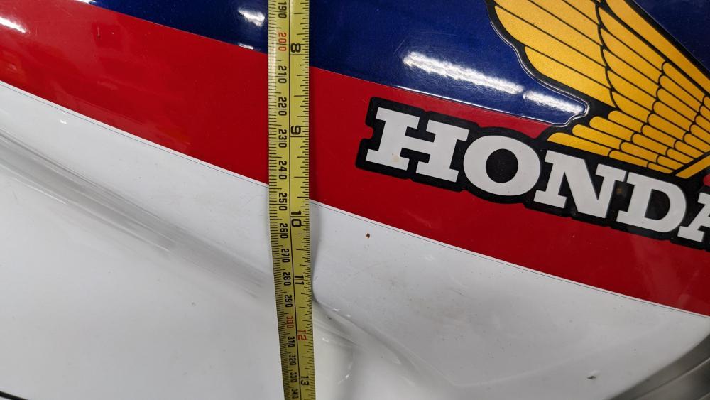

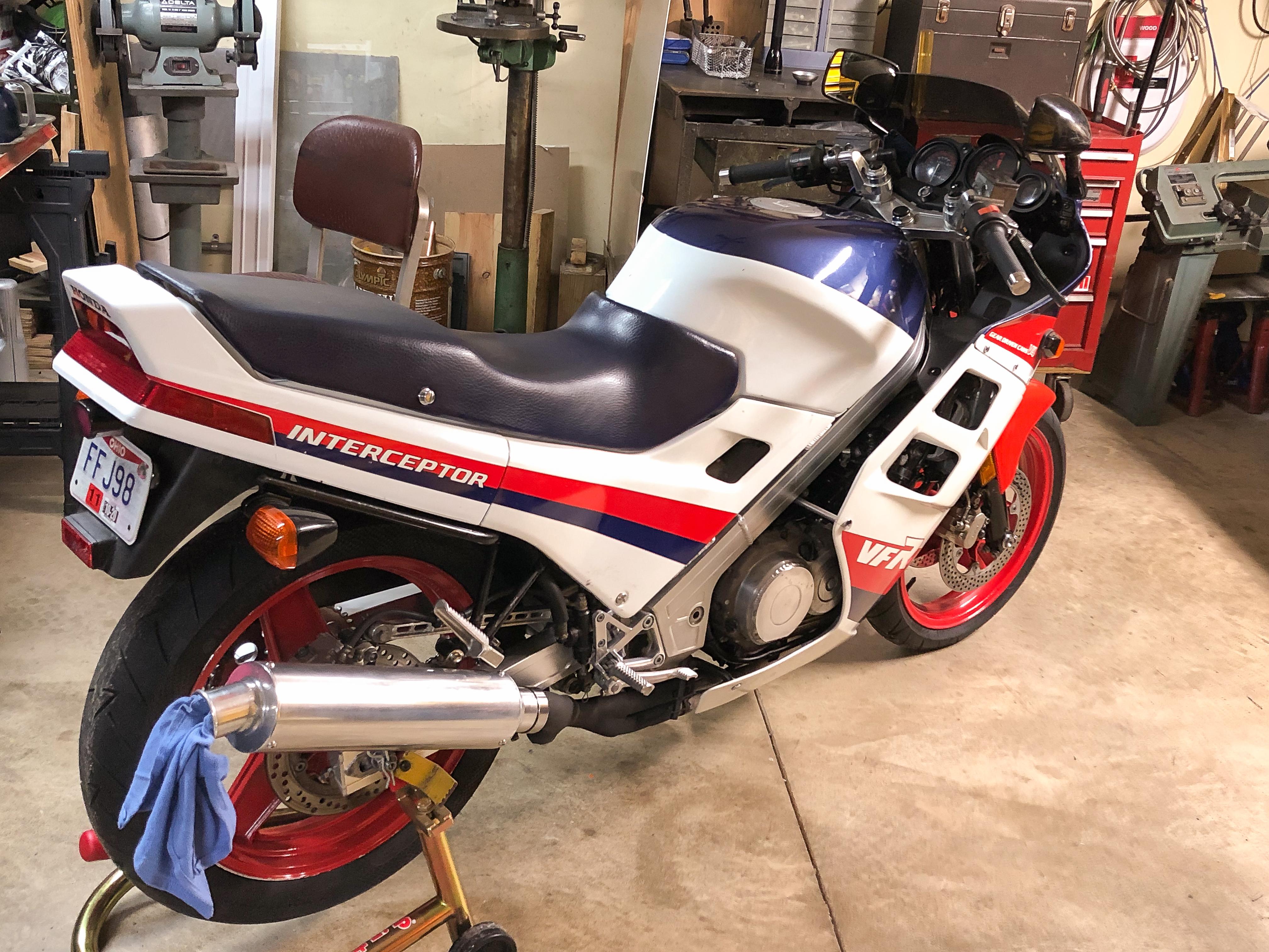

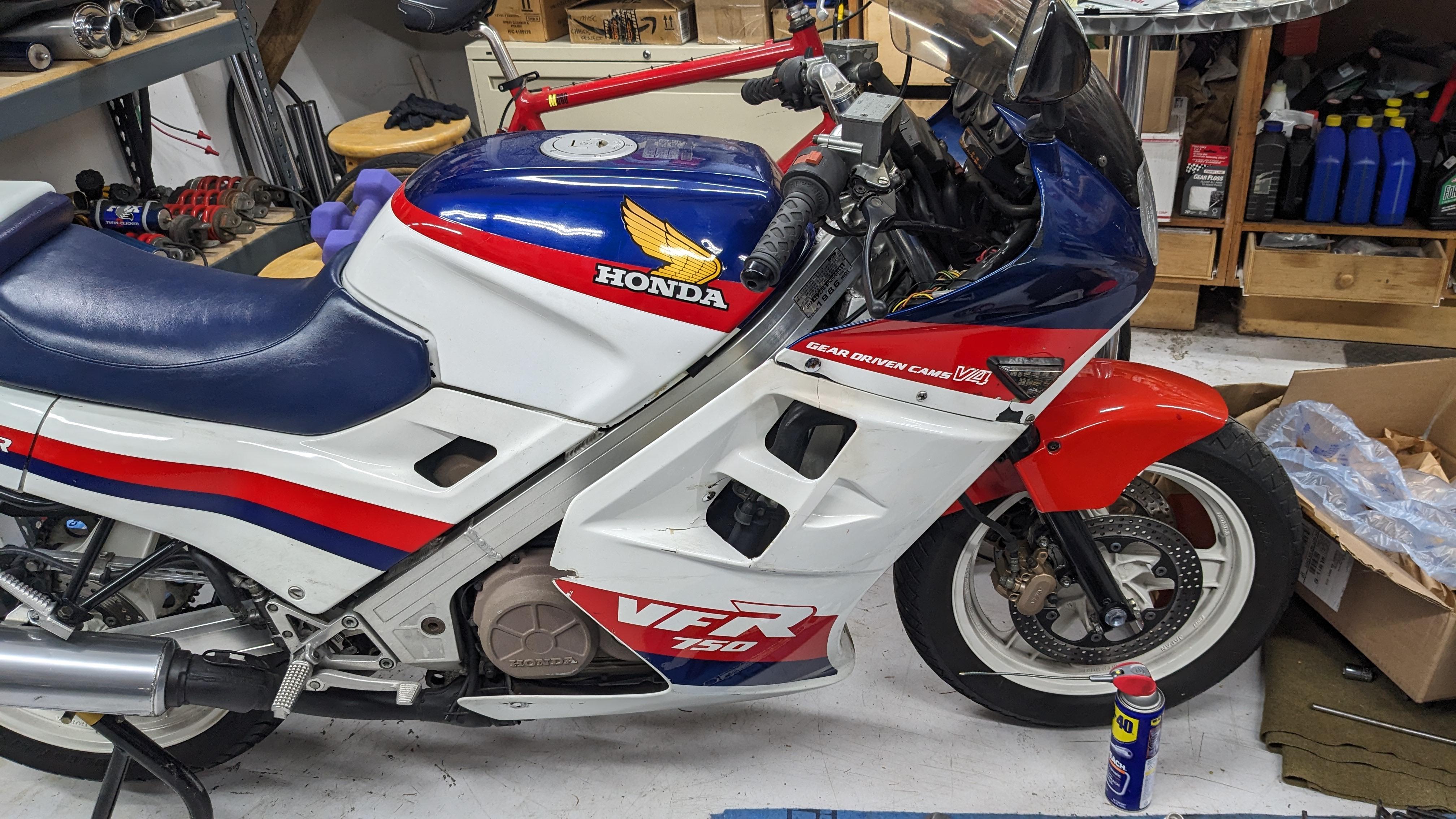

Below are three pics Captain80 send me for reference, then a series of pictures of my bike and the PO's carnage.
So, I'm thinking the "big" picture is Paint repair, apply decal and then clear coat.
Its all the "little" pictures that are unclear and frightening me. I have very little paint experience.
The fuel tank is not original paint; I think it was painted with the aftermarket front cowl and those graphics are replaced as well and their placement is probably less than stellar.
Any thoughts?
The stripe I have is from a CB Decals set and have a Left and Right side with the wings incorporated.

I see two options.

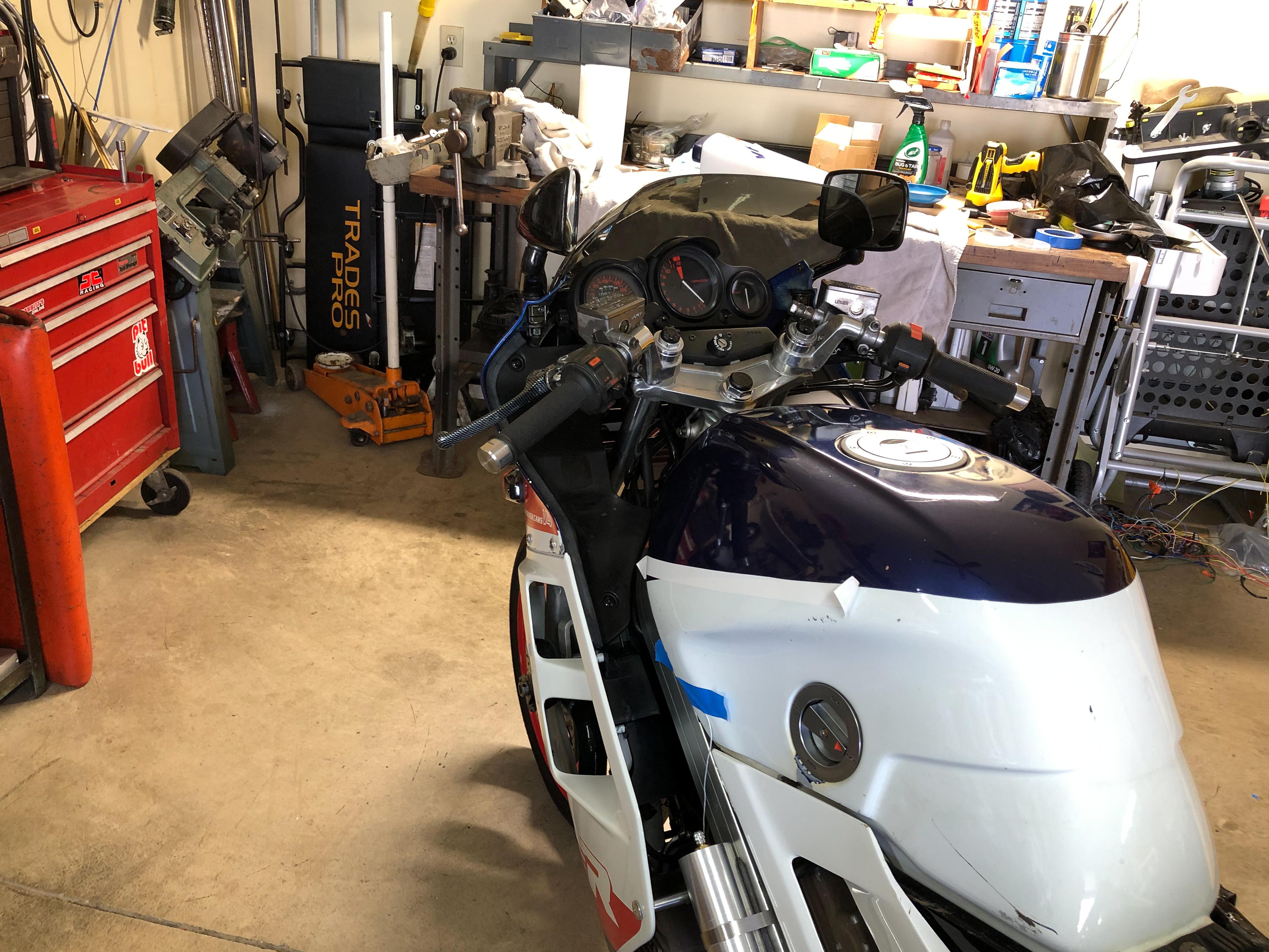

Best fit it to just cover the blue.  It will be "off" a little to the cowl, obviously. Maybe get some red tape and see how off it really looks.
You last photo...   Very off.
Scuff and repaint the white in the correct configuration.  Apply graphics.
I think option 2 is the way
How well will the white cover the blue?

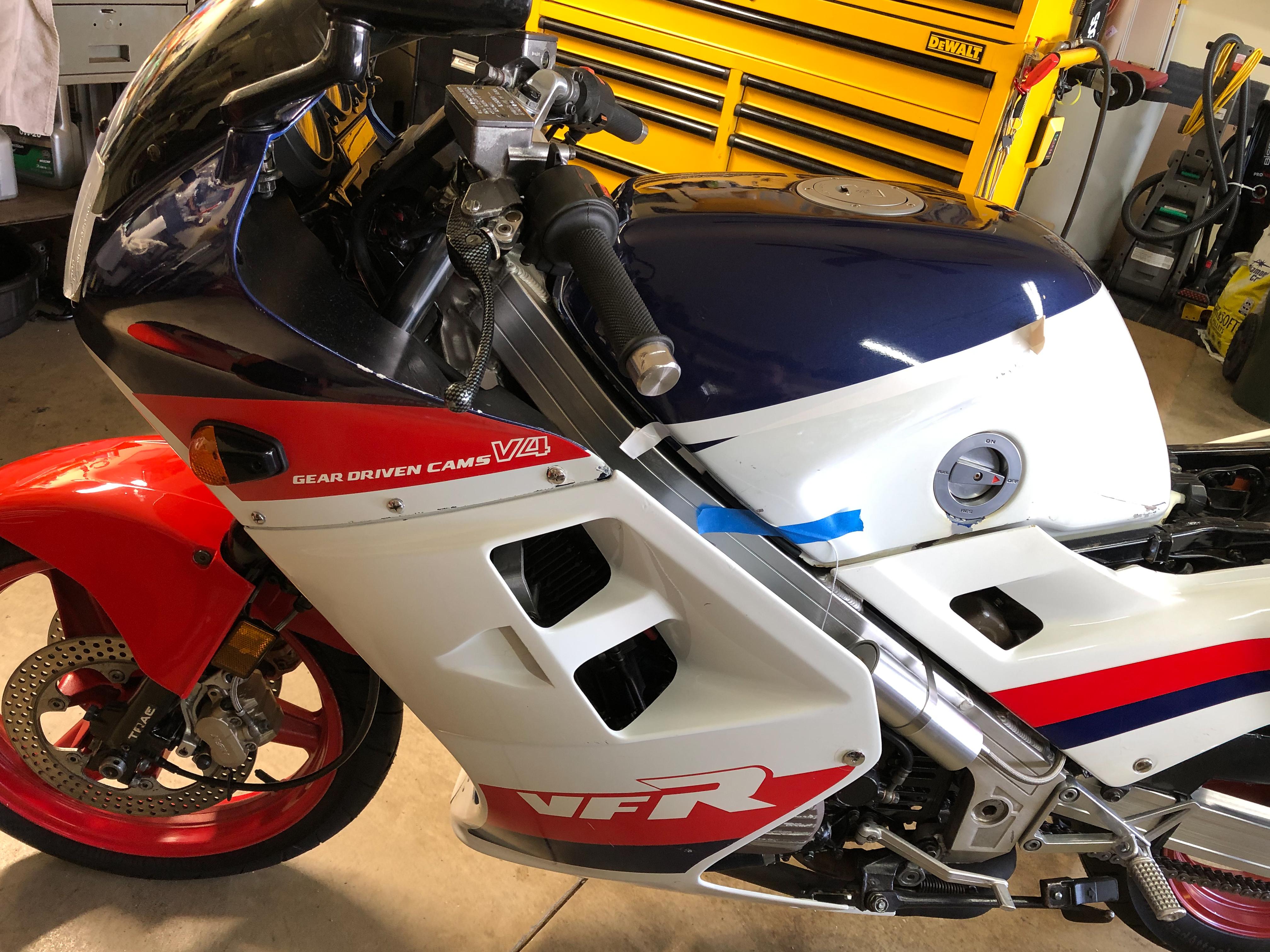

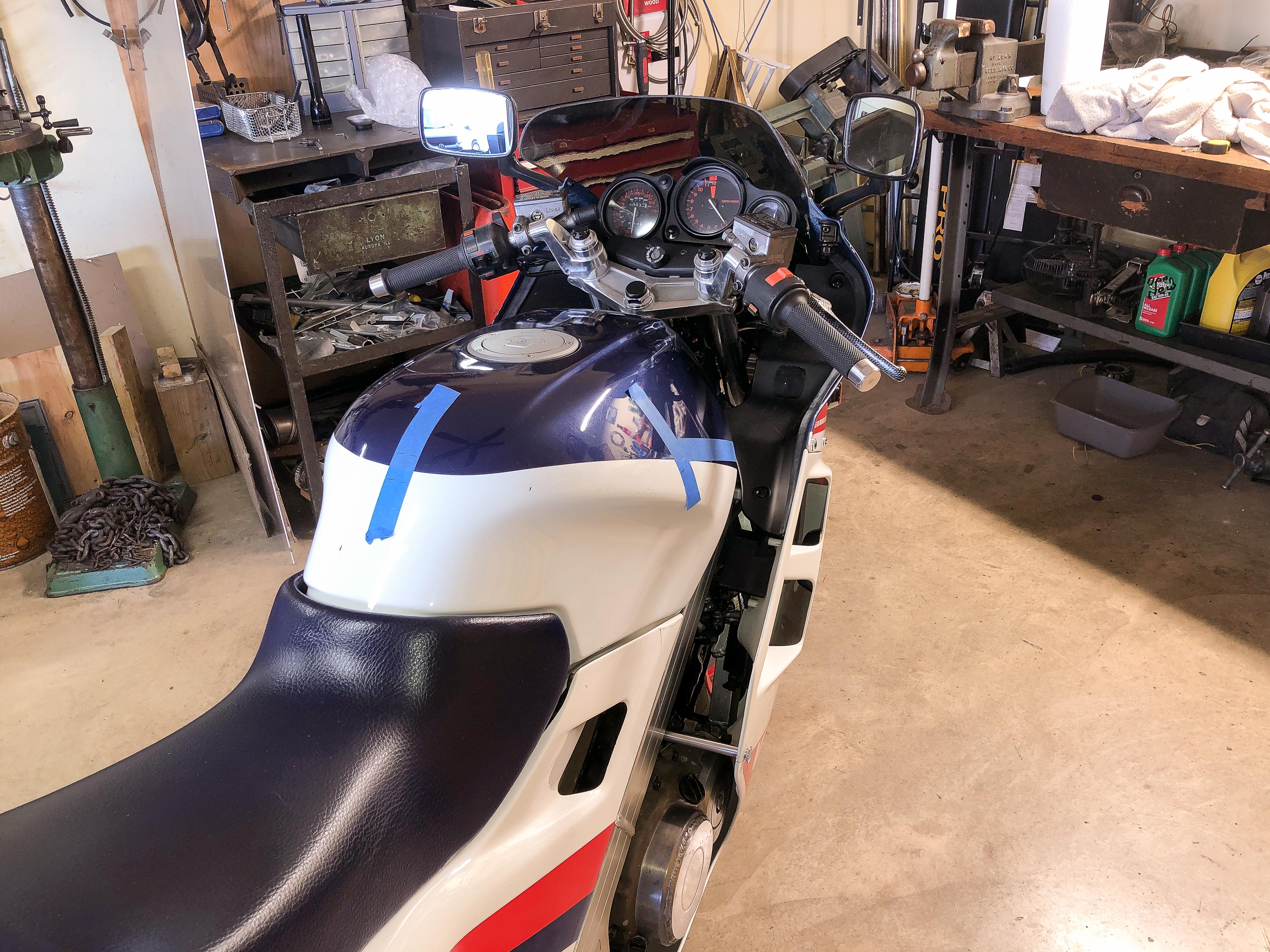

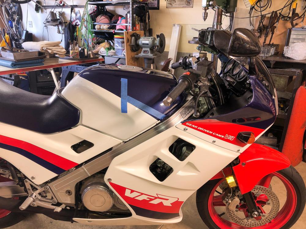

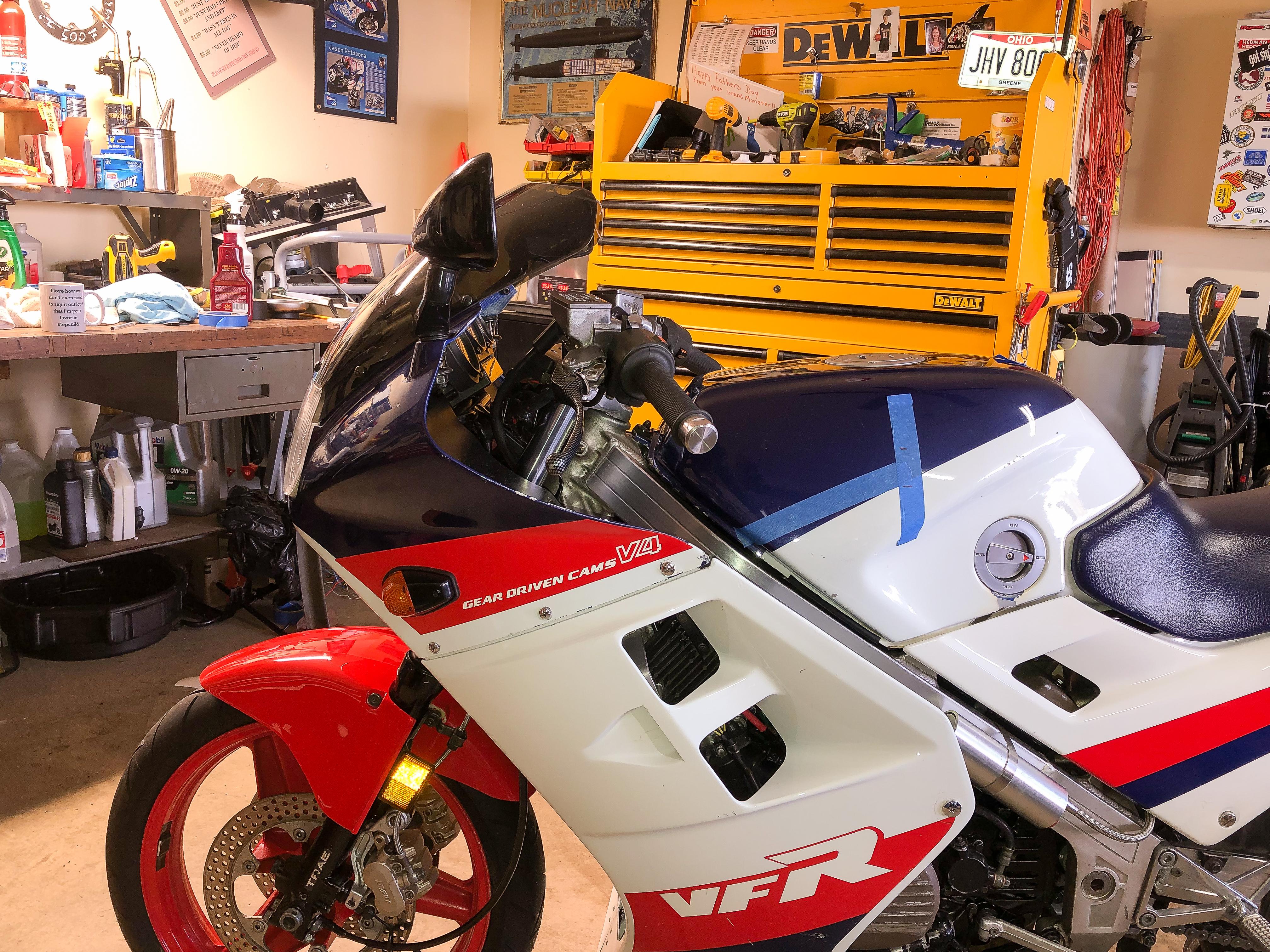

Some more playing around with masking tape. I'll get some white and red vinyl tape.
Ouch.
I see some white paint in your future.  The good news...   single stage solid white is usually the easiest to shoot and have look good.
What is "single stage" and are you talking shaker can paint?
Does the masking look right to you?! That blue is so far off!

Your tape lines look pretty on.   I'll compare a straight side look on my 86, but Honda usually has it's stripes configured for straight from the side.

ok, i mask everything off scuff up the white, Do I prime the blue areas that will be painted as well as the petcock area?
After all that, after pealing the masking away, that ridge we just created between the blue and white paint does that have to be made smooth again? Then apply the decal then clear everything? Blue, decal, white?

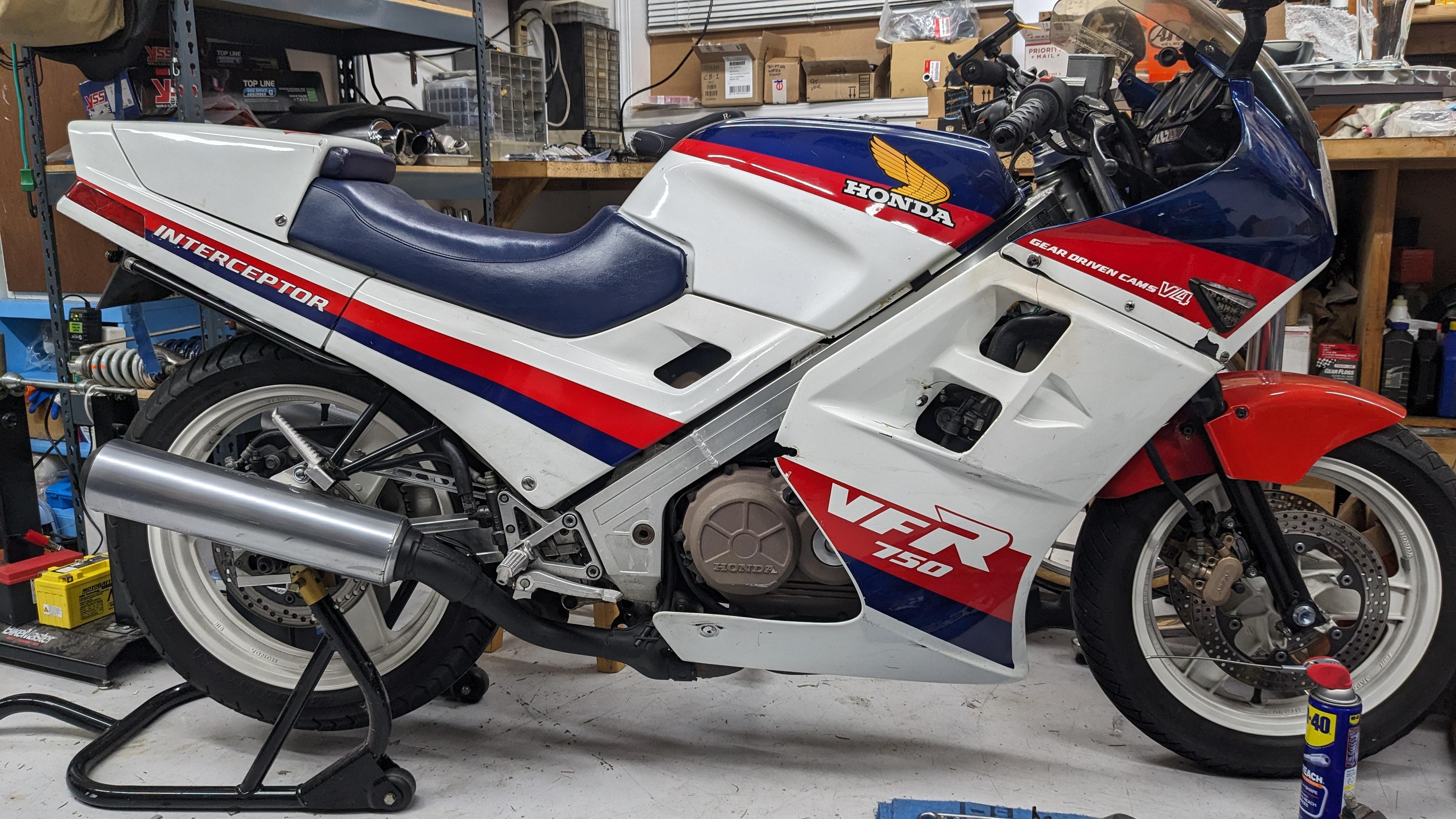

Actually...  hold on!
You have to standing above for the lines to match.

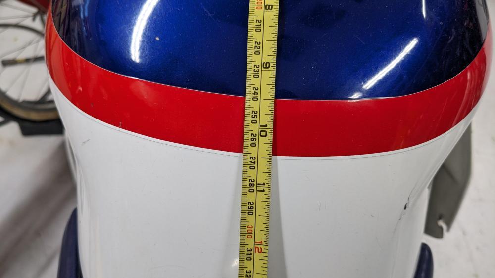

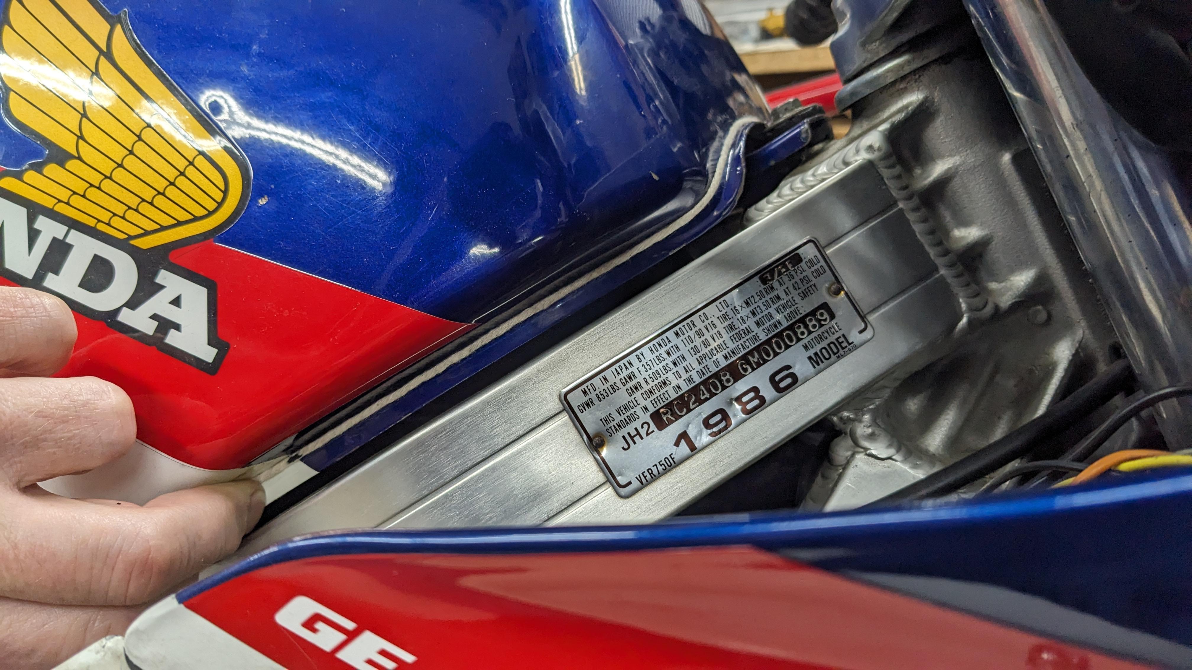

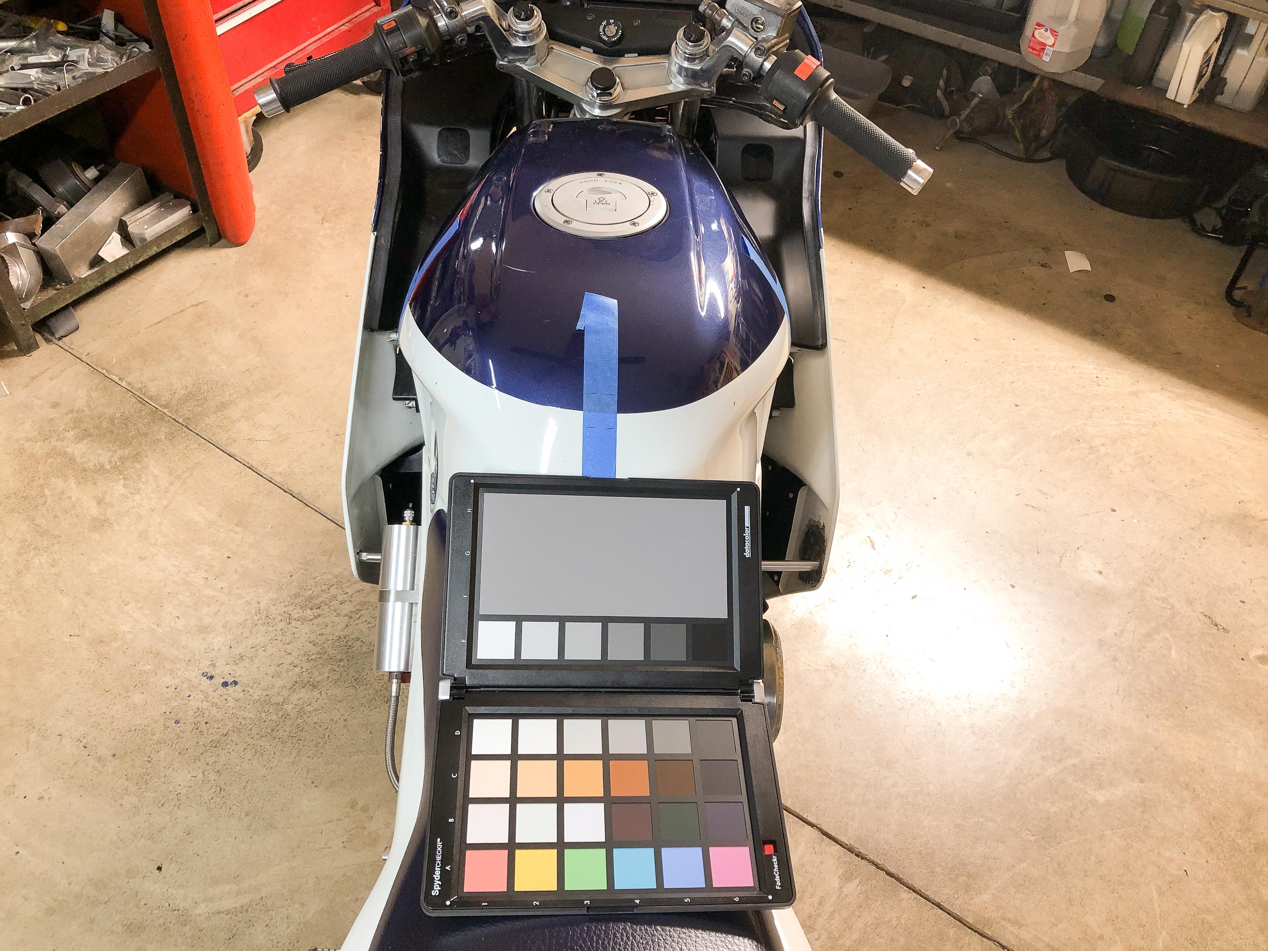

All original paint and graphics.

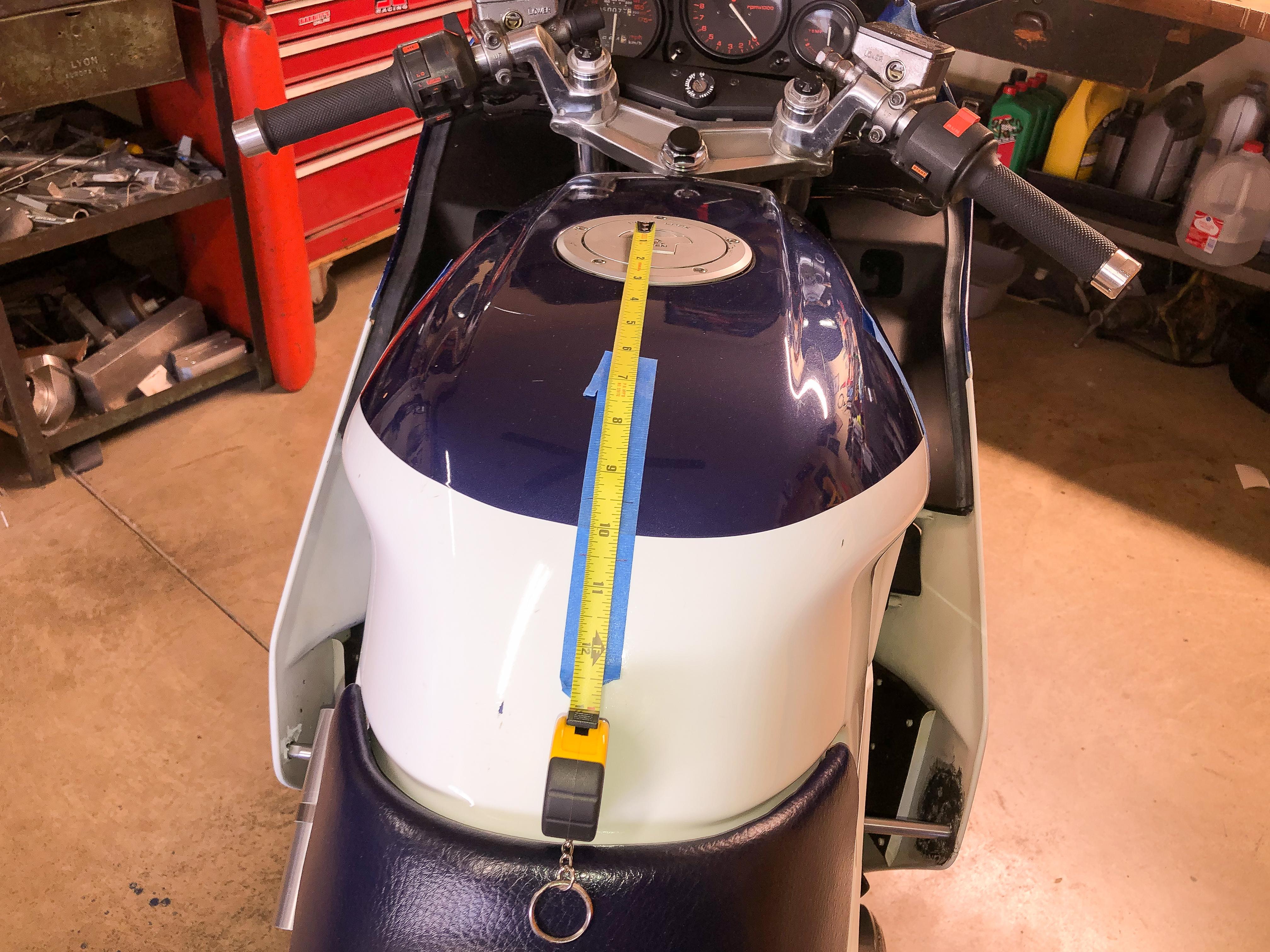

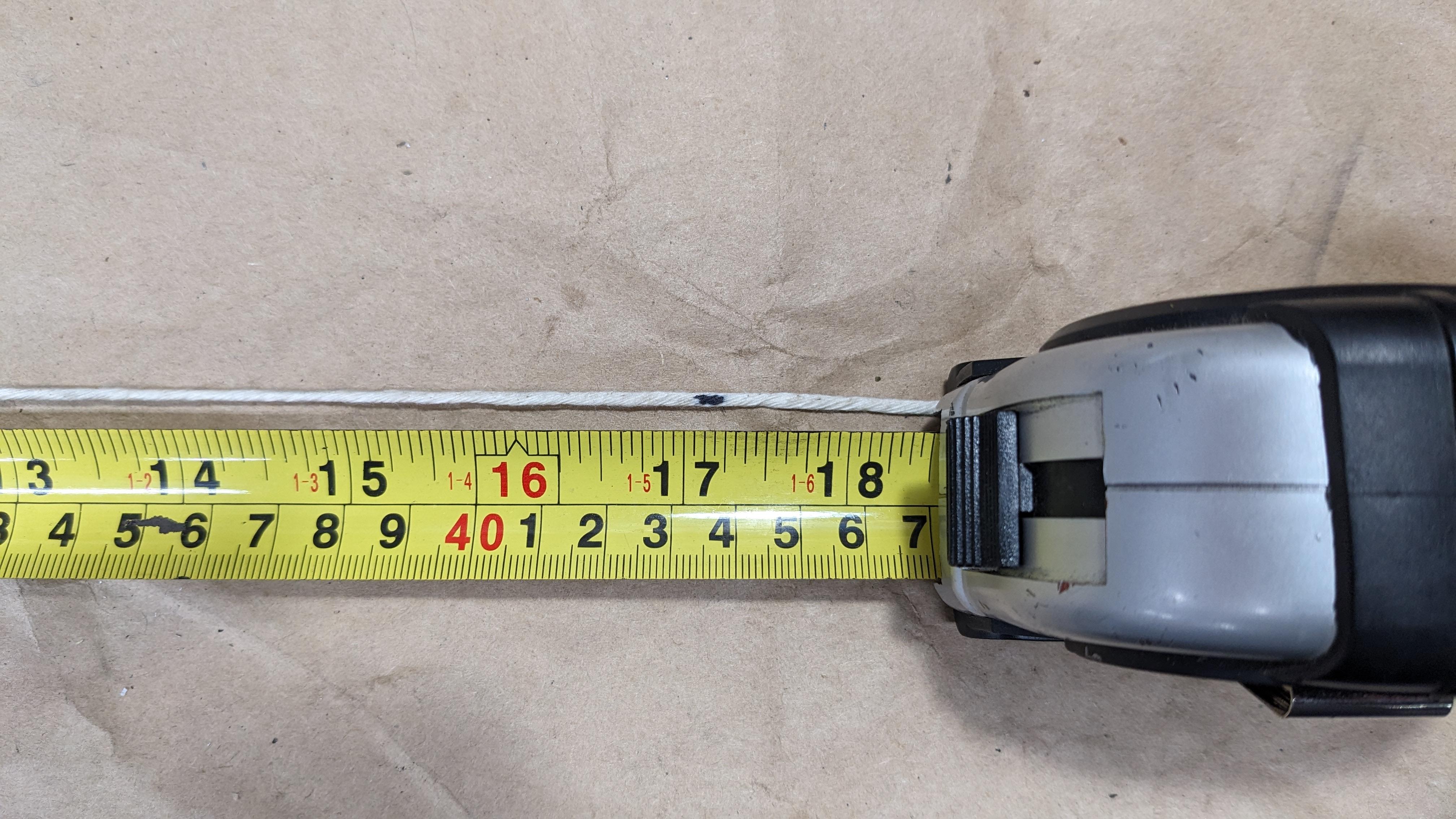

If I run a string along the front seam groove...
The blue / white transitions are this far apart...
Nice! Good one!
I'm in no hurry with this one Captain.

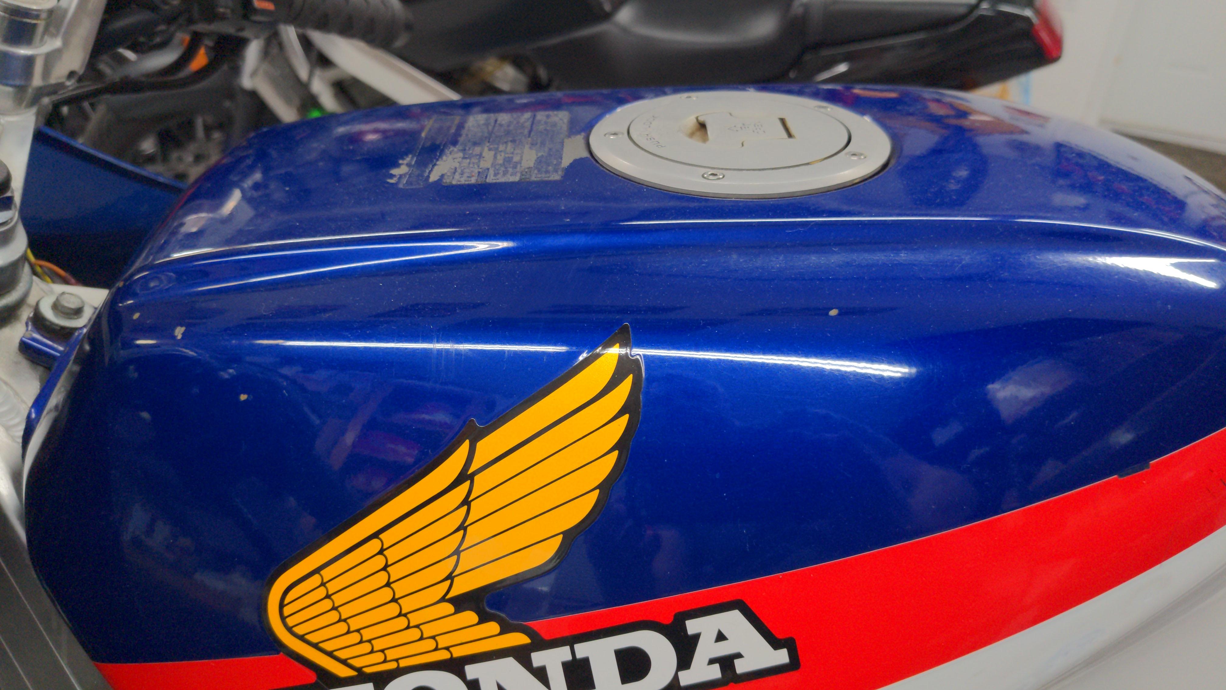

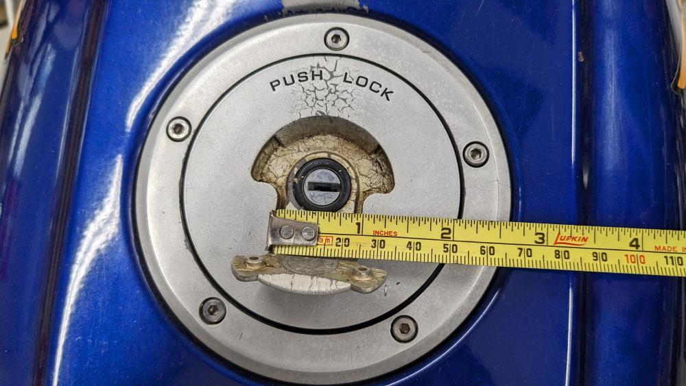

How about ref. pic of wing tips in relation to tank cap please.
I can't think of a way this can't work, perfect! And the red stripe probably overhangs that by an 1/8 or so each side.
I'm on the bike trainer watching Supercross right now.  I happen to be in a good vantage point.
The lower edge of the red stripe is pretty much riding the transition line, barely over lapping.

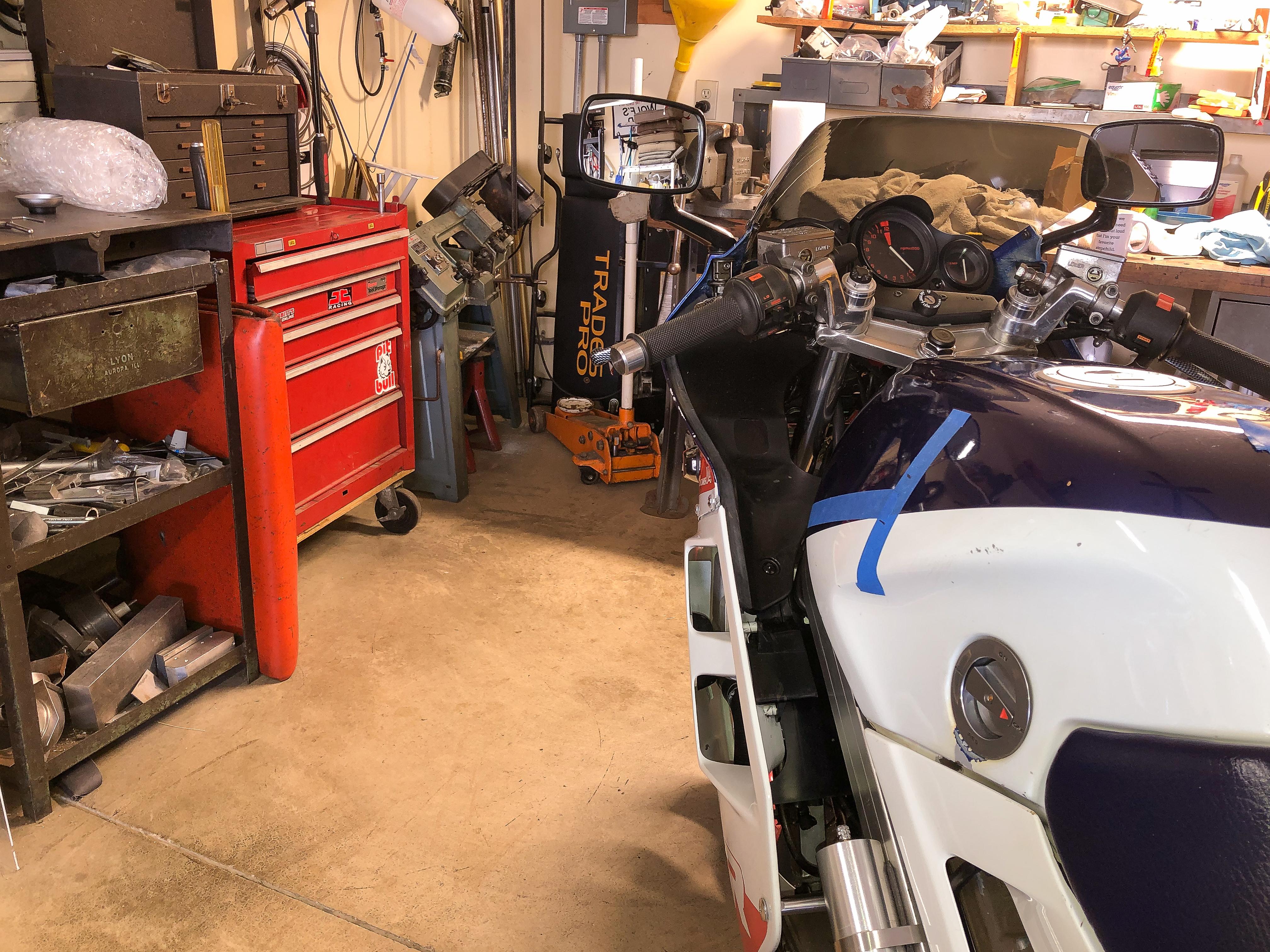

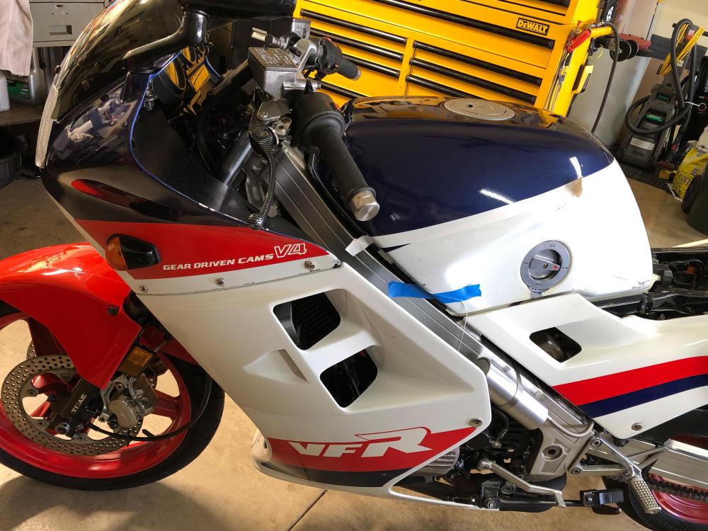

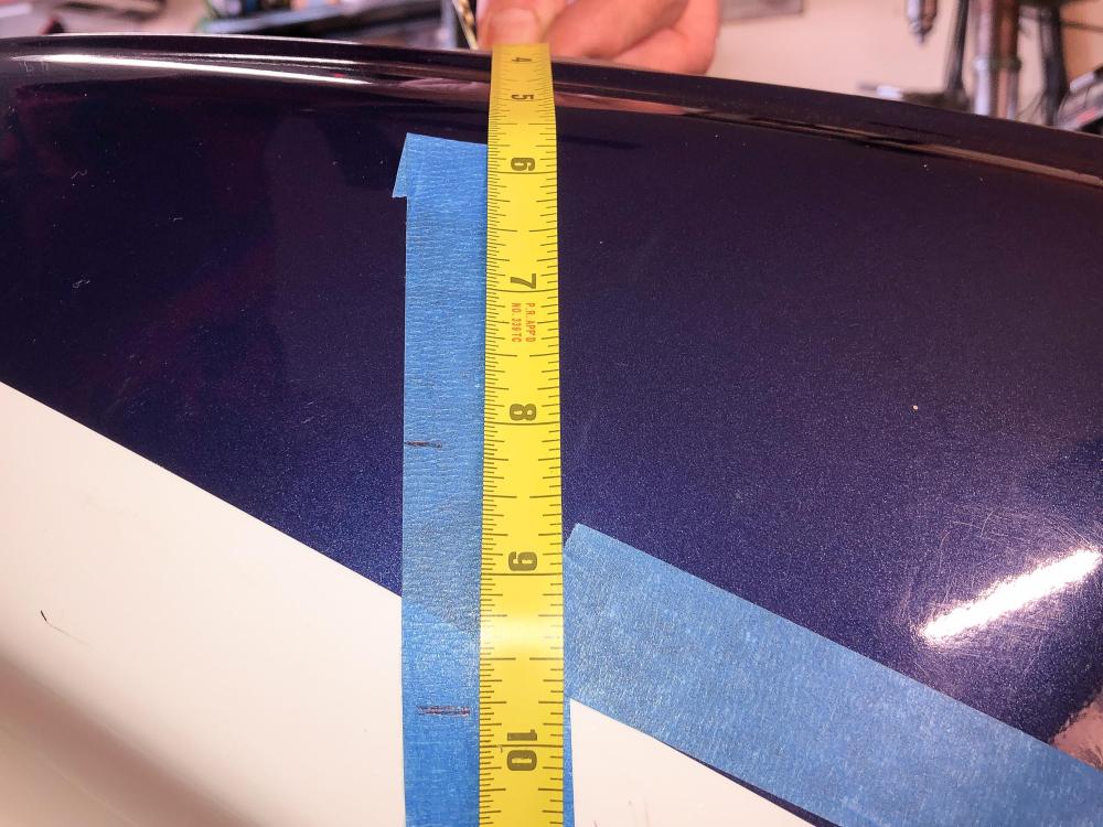

Captain your "string theory" looks pretty bullet proof; I marked center of the string, taped it to the tank, put white electrical tape to the string marks and literally stepped back and took these pics.
