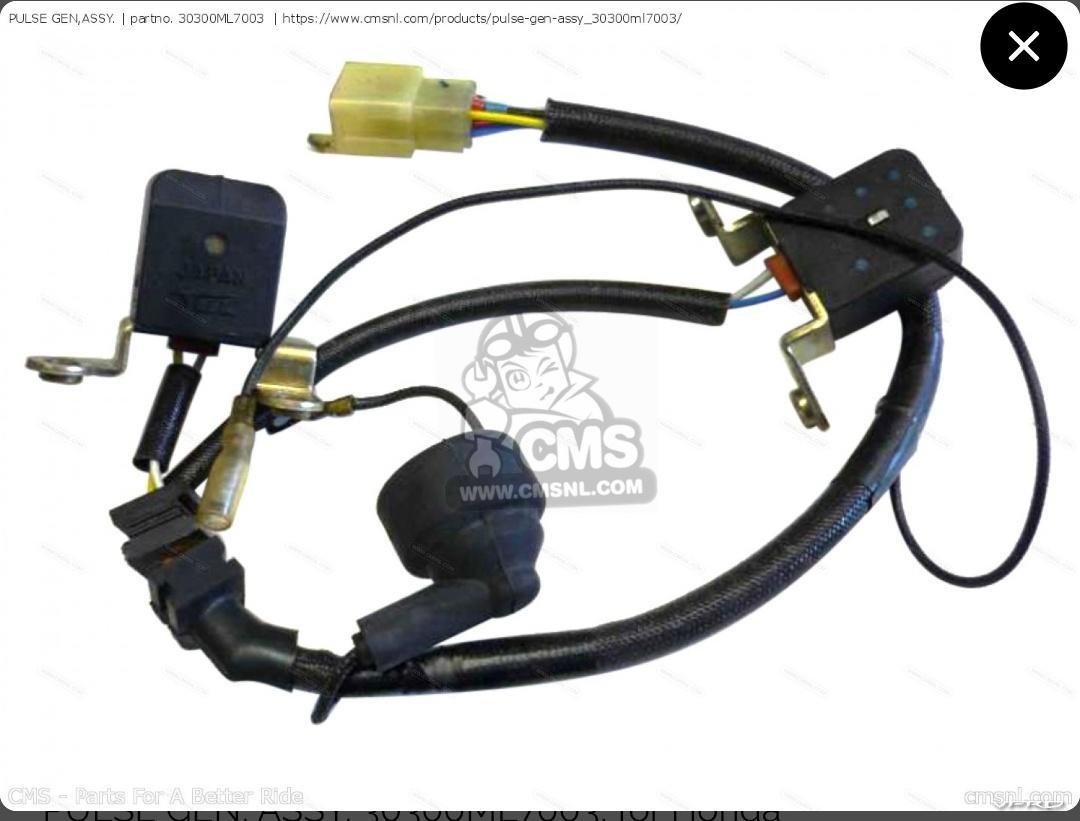

keny Posted September 12, 2023 Author Posted September 12, 2023 Well it's now confirmd it's the pulse generators that is reason bike stops. Sadly a one year only part and new is not in stock anywhere 😞 Even a working used would be great to find! Anyone has something in the drawer? OEM par number is 30300-ML7-003 Hope to find one or I have to score hole ignition system from a 87-89 one completely whit trigger wheel. 1 Quote
Fastdruid Posted September 12, 2023 Posted September 12, 2023 Are they totally failing when hot or are shorting to earth? My 86 manual says they should be 450-550 Ohm. I guess there is little risk in taking it off and investigating the wiring itself or even investigating aftermarket replacements of just the coils themselves. Might be worth asking Electrex for example if any they make would work. https://www.electrexworld.co.uk/acatalog/Online_Catalogue_Pick_up_Coils_403-p1.html Between the pickups failing and the trigger wheel/sprag clutch housings breaking there are a few common failing but unobtainium parts for the 86 bikes now in part because they updated them for the later bikes and then kept them the same for many years. It's not particularly helpful to you right now but I really should get my arse into gear and swap out the pickups and trigger wheel from my 86 engine for the ones out of a RC35 engine I have, if only because then I can sell them on to someone else who needs them to keep an 86 bike going! Personally in your shoes I'd go for the upgrade, pickups from a 88-89, trigger wheel from a 87-97 (unfortunately they *ALL* have a reputation of breaking the sprag so they're a bit in demand), a 88-89 ECU, fuel cut relay and tacho. Rewiring is pretty trivial as you can pickup the connector shells easily pop out the pins and swap them over to match. You could probably even go for RC36 pickups and ECU as well, despite what the HBoL says, timing is the same on all of them (according to the Honda manuals) although the wiring would be harder as it's a totally different connector. Not entirely sure what the difference between 88-89 and 90-97 pickups are, different part numbers but might just be in the connectors/wiring and even work with an 88-89 ECU as well. 2 Quote

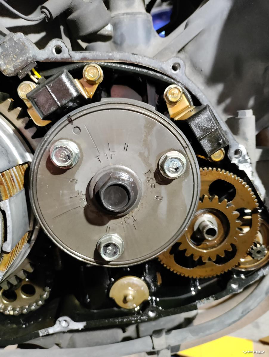

keny Posted September 15, 2023 Author Posted September 15, 2023 So I did test fit the 88-89 pulse generator and sadly they do not angel up so didn't bother try to stay engine OEM 86 And 88-89 Marked the OEM location on the starter clutch from where the difference show quit clearly. So on the hut after 88-89 part's.... Quote
Member Contributer Captain 80s Posted September 15, 2023 Member Contributer Posted September 15, 2023 Can the pickups/pulser coils be transferred over to the 86 brackets? 2 Quote
Member Contributer Thumbs Posted September 15, 2023 Member Contributer Posted September 15, 2023 Just what I was thinking, judicious use of a hacksaw and dremel is worth trying Alternatively this might be useful https://www.rexs-speedshop.com/product-category/ignition-system/replacement-pick-ups/honda-pick-ups/ 1 Quote
Member Contributer tsmitty Posted September 15, 2023 Member Contributer Posted September 15, 2023 Don't forget to keep an eye on the pick-up/trigger .013 - .014 sounds about right. Quote
Member Contributer Captain 80s Posted September 15, 2023 Member Contributer Posted September 15, 2023 23 hours ago, Fastdruid said: Did you get a new gasket too? Chances of it popping off cleanly are slim (certainly mine ripped into many pieces last time) and I've been led to believe the tolerances are critical enough that leaving it off and just using sealant can lock up the starter idler gear (or worse). ....Although that said I guess you could just put it back on and try it if it does rip! It won't leak badly enough to be that big a deal for a test and if it doesn't work you'll need to take it all off again anyway! I had to take the clutch cover off of my Hawk GT after installing a new gasket the season prior. It tore in a couple places. I didn't touch a thing, but gave both sides a gentle wipe with some contact cleaner on a rag, and put a nice, thin even smear of Hondabond 4 around the whole cover side (cuz that was the easiest on the bench), perhaps giving a little extra attention at the breaks. Let it dry overnight before adding oil (and not tilting it vertical) and not one leak all Summer long. 1 Quote
