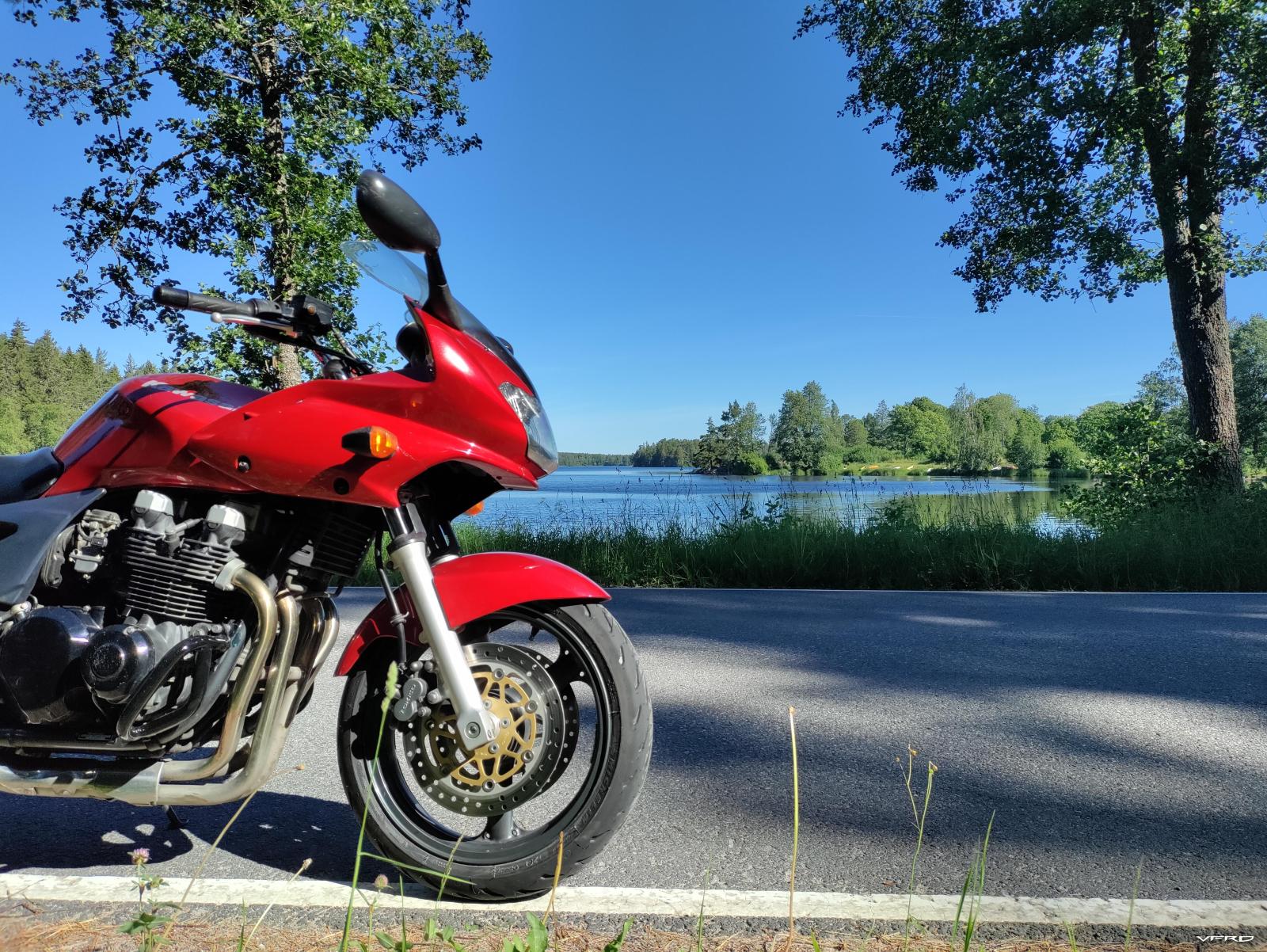

Talking of the ZR7S
Had a spin on it today
large.IMG_20240623_100928.jpg.24d35cc64c5ee5e2e1b839eed8aac067.jpglarge.IMG_20240623_094753.jpg.9dbb37fba81f3fa27460b8a66521c7bd.jpglarge.IMG_20240623_095034.jpg.739f2a5bc844f7512958ef67207d58cc.jpg
Great bike!
Best feel is 32-36:1 ratio between M/C piston area & calliper piston area IMO. I use CBR929/954 or CBR600F4 callipers with CBR600F4 M/C, its the best Axial brake setup.
Picture of today
Didn't hit it
Instead just enjoyed twisty road's, a bit longer from home

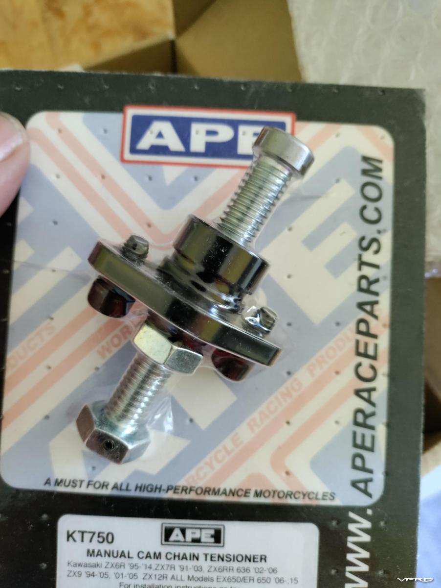

Well the ZR7S cam chain started to make noise at times, so did put in a manual cam tensioner as the OEM is known to fail
It needed trimming in other end to fit but otherwise a good part. Cam chain worries are gone.

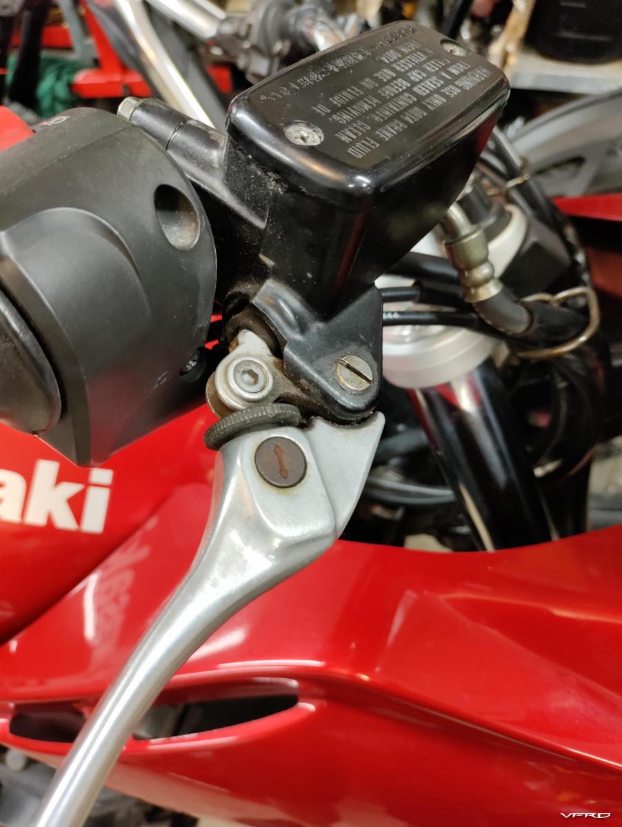

Decided to test the CBR1000F brake M/C I have (14mm), now mounted but test ride still to do, hope to get better feel in level compared to orginal that is ⅝ (~16mm).
So the smaller M/C sure did do wonders to the front brake, more feel in level as slightly less pull needed for higher brake force.

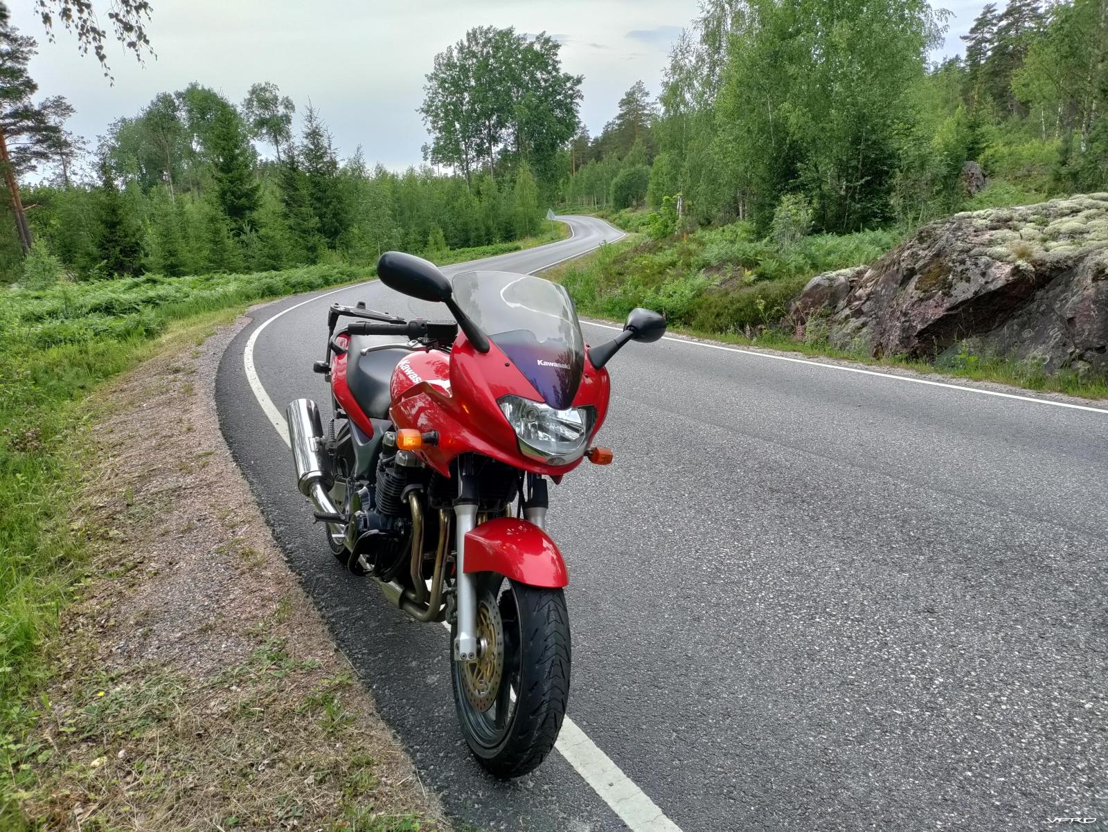

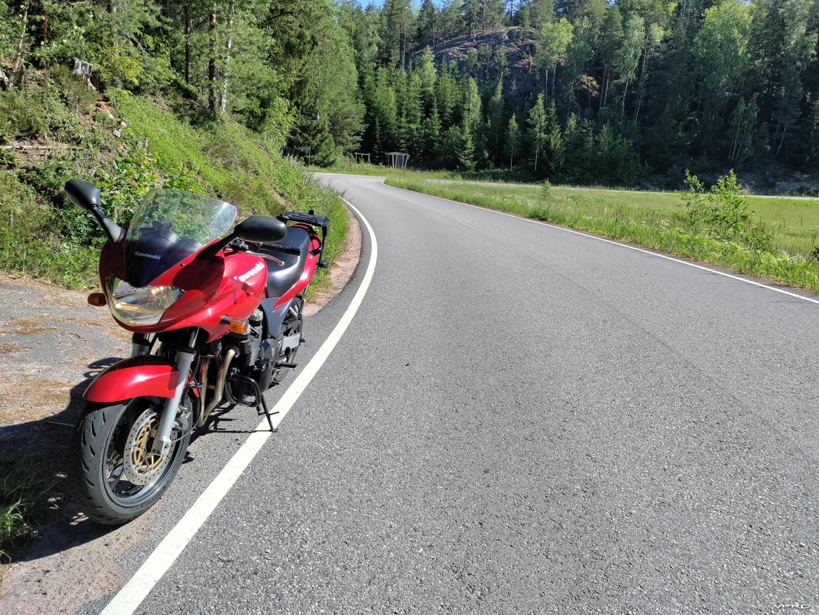

A few pictures from the last rides
large.IMG_20240630_175218.jpg.4f6f4f1e02d6e40391c2f2a6edde09a8.jpglarge.IMG_20240630_180555.jpg.00c80a09c8ed35cff0dfa3b1812a6355.jpg
Still like the bike a lot

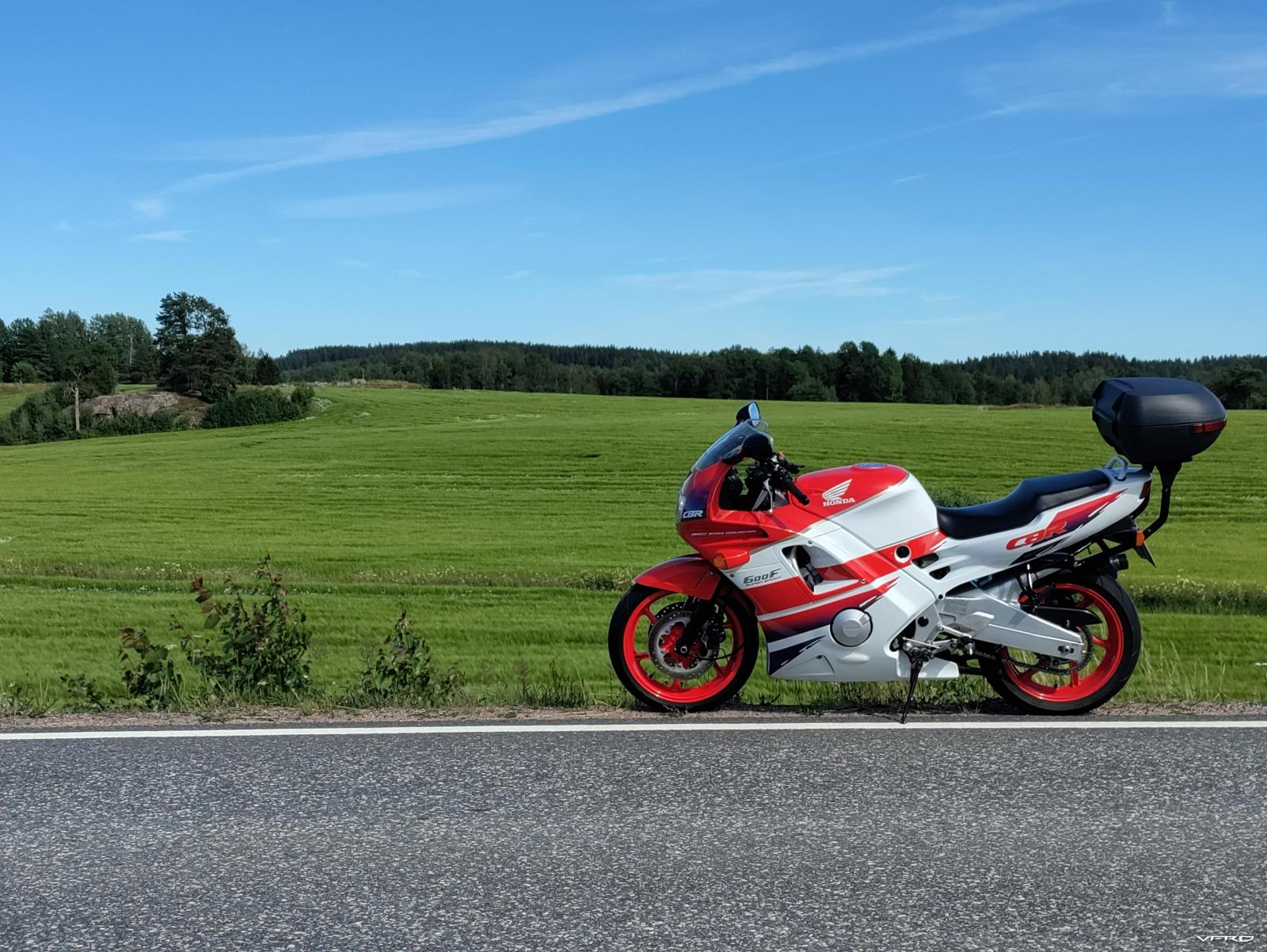

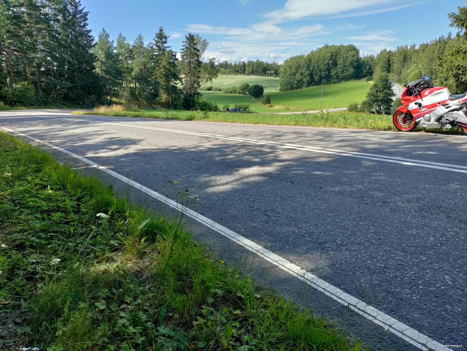

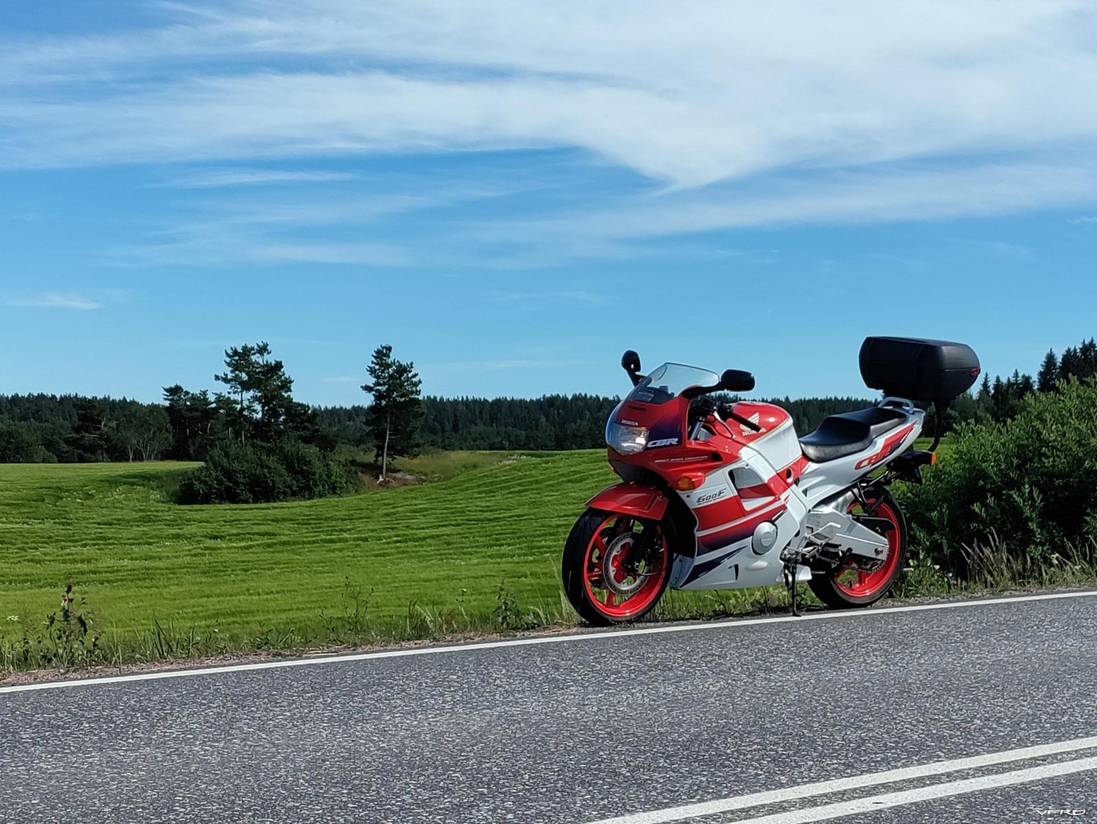

Some pictures from ride home from work yesterday
large.IMG_20240710_162919.jpg.a583e4df6c72d0ec5611192db98ba75e.jpglarge.IMG_20240710_162930.jpg.aa25d5226524582c62cffbcba5f14e1a.jpg
CBR is indeed a joy to ride as my ride to work is not that long, but on nice road's
One of my favorite spots on my dayly commute ride

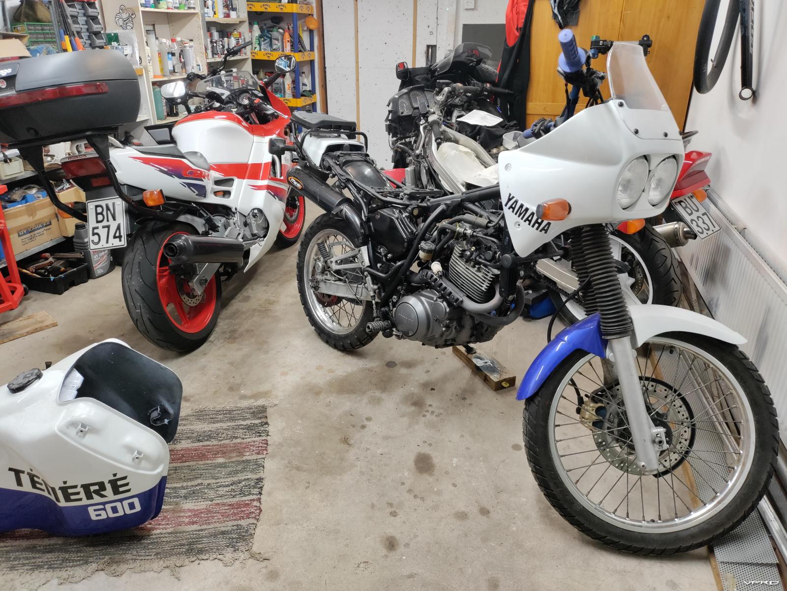

One of my former motorcycle's, that I sold as part's in boxes, came back to my garage
The 1989 Yamaha XT600Z Tenere, it's only in for a visit through, offered to help out whit electric issues.
The second (1VJ )model  1986-1987 ruined the reputation of the 34L/55W engine.
Placing the oil cooler in front of the engine proved a bad idea... Adding air cut out in the lower part of the front mudguard would be a start..
So this being a 1989 is good

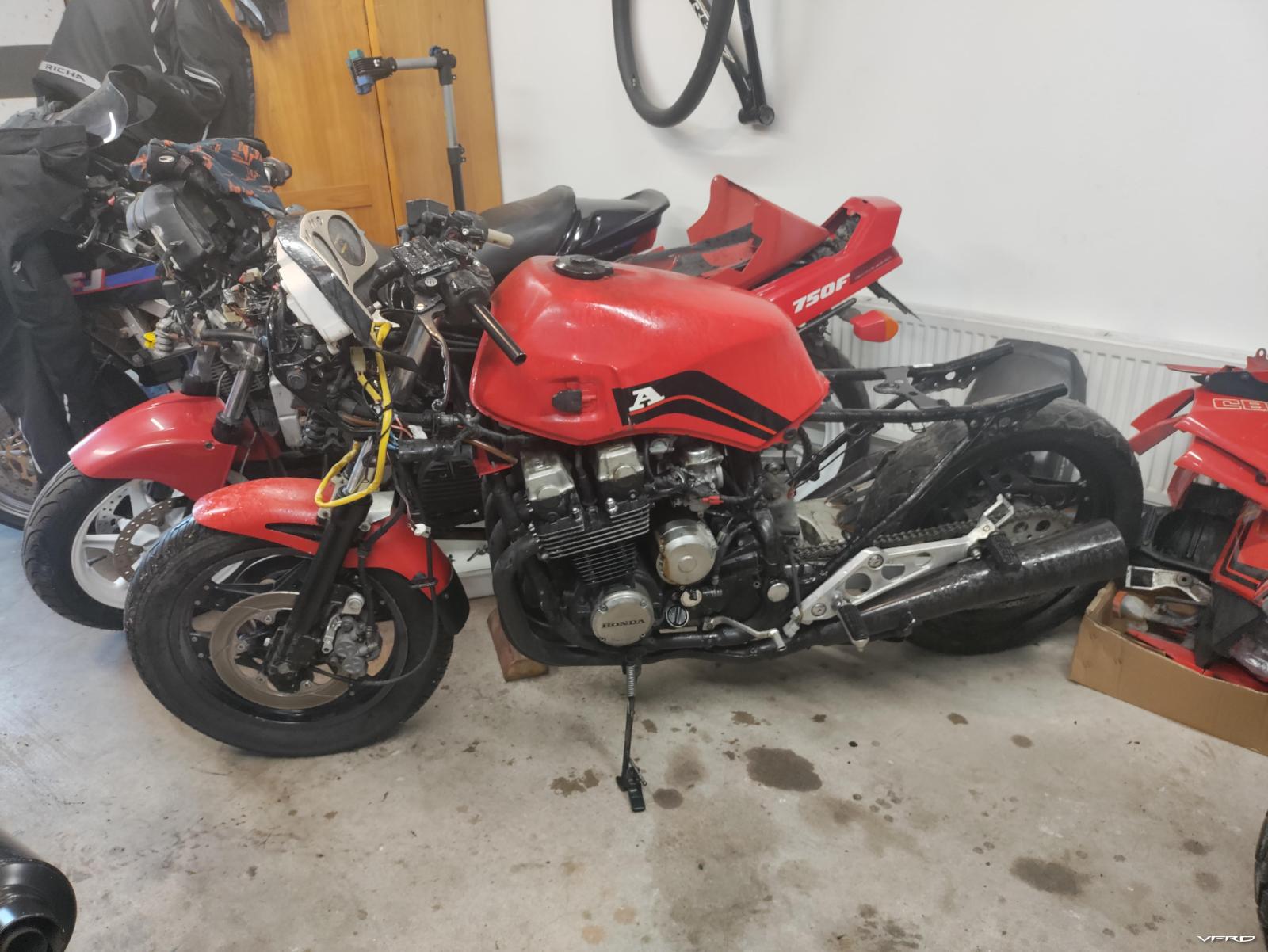

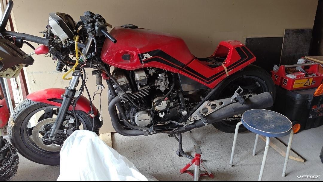

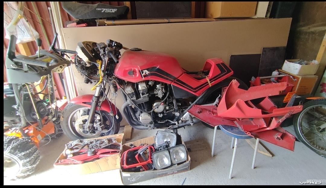

But the other day same bike did appear on local sale site
large.Screenshot_20240730-205303.jpg.7f59d0194d02fb09124b588dd95dd16a.jpglarge.Screenshot_20240730-205325.jpg.87e0be200b0b3ed68f439c68aa444432.jpg
The add pictures above.
Seller was same guy that bought it from me 7 years ago. He had started to do a cafe racer project of it, but don't have time, to many other projects as newborn baby as a other kid in house.
So I'm a crazy man, I did buy it back!
Sold it for 900€ 7 years ago, bought back for 300€ 🙈
So now in my garage, rear of frame cut but the part cut off exist, many panels cut also, but all should be there.

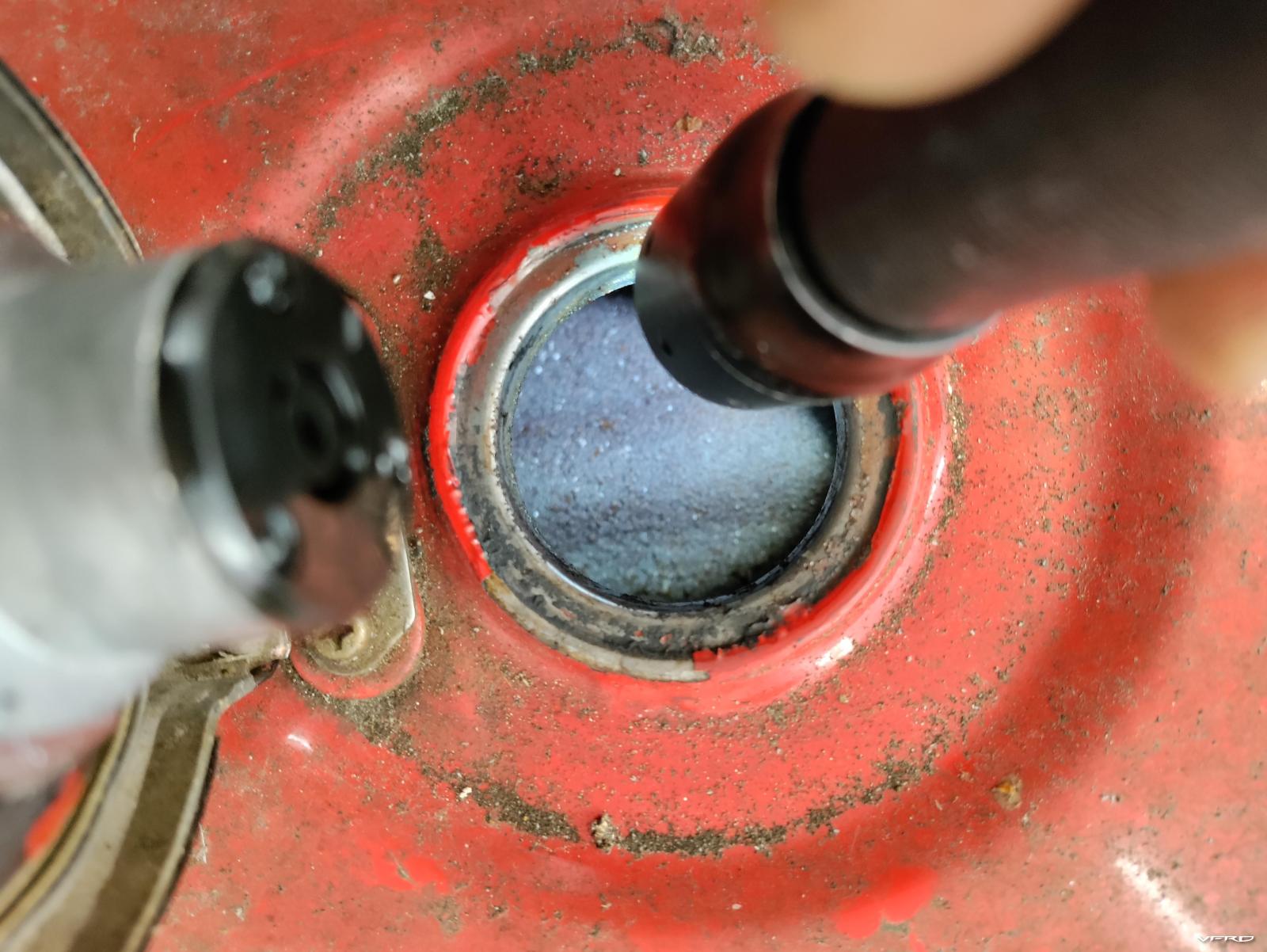

Well before pushing it to back end of garage decided to see if it runs, nope, didn't start even all plugs are connected and gets fresh fuel. Didn't let fuel under it that is a good sign, reason not starting is no spark, so need to check why, CDI box is suspected reason as rattles inside it ..
Did a peak inside fuel tank, not good looking
Led light make it blueish, but just rust inside....

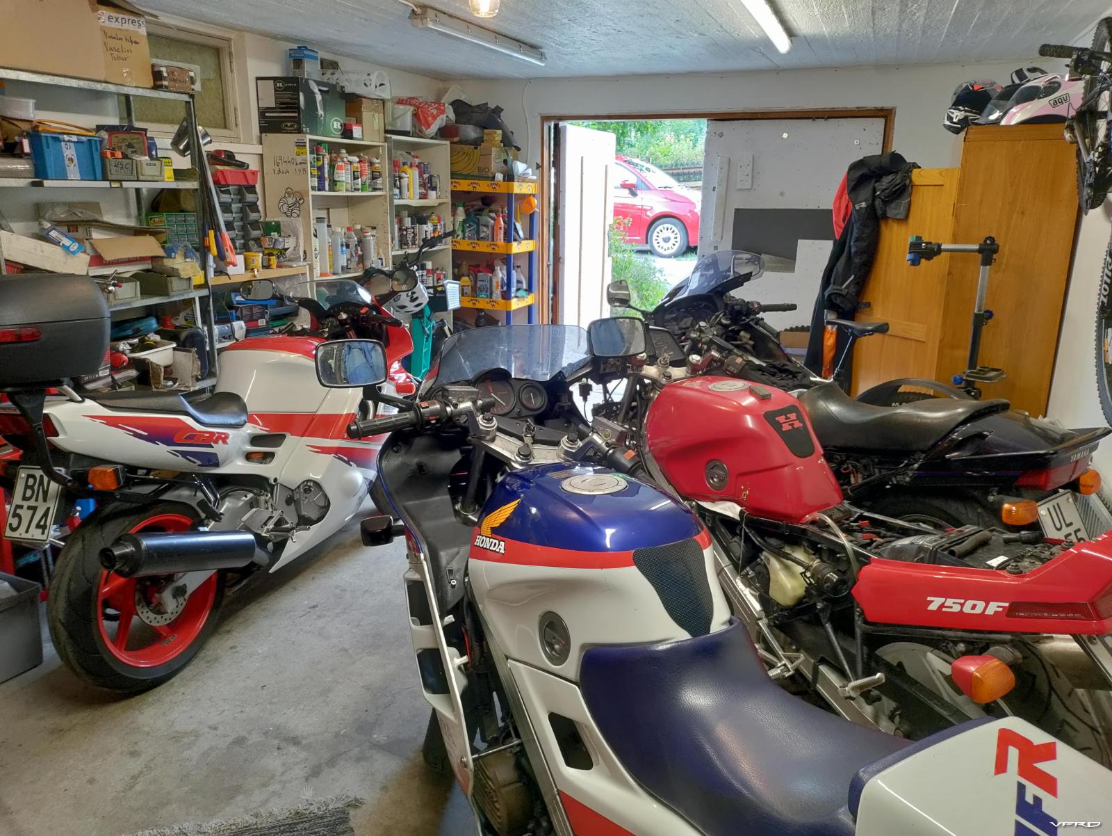

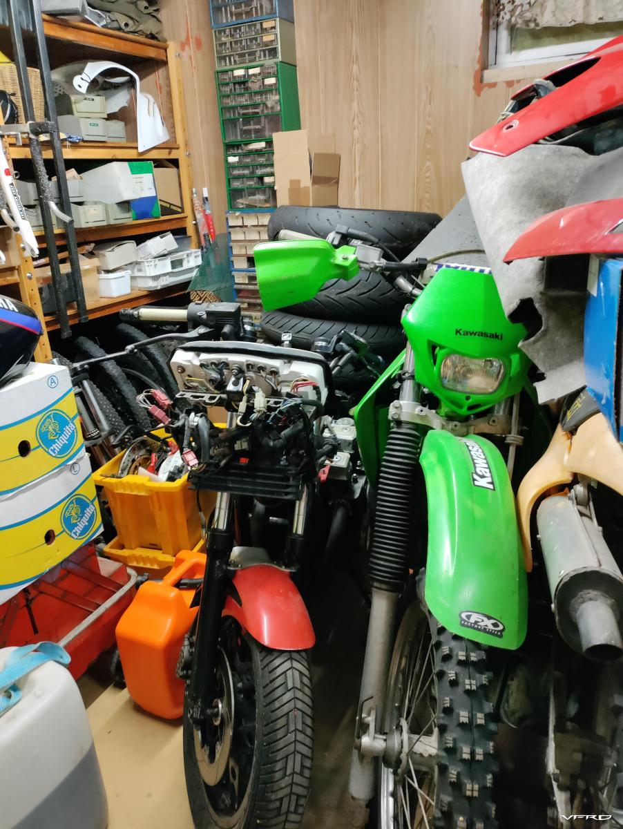

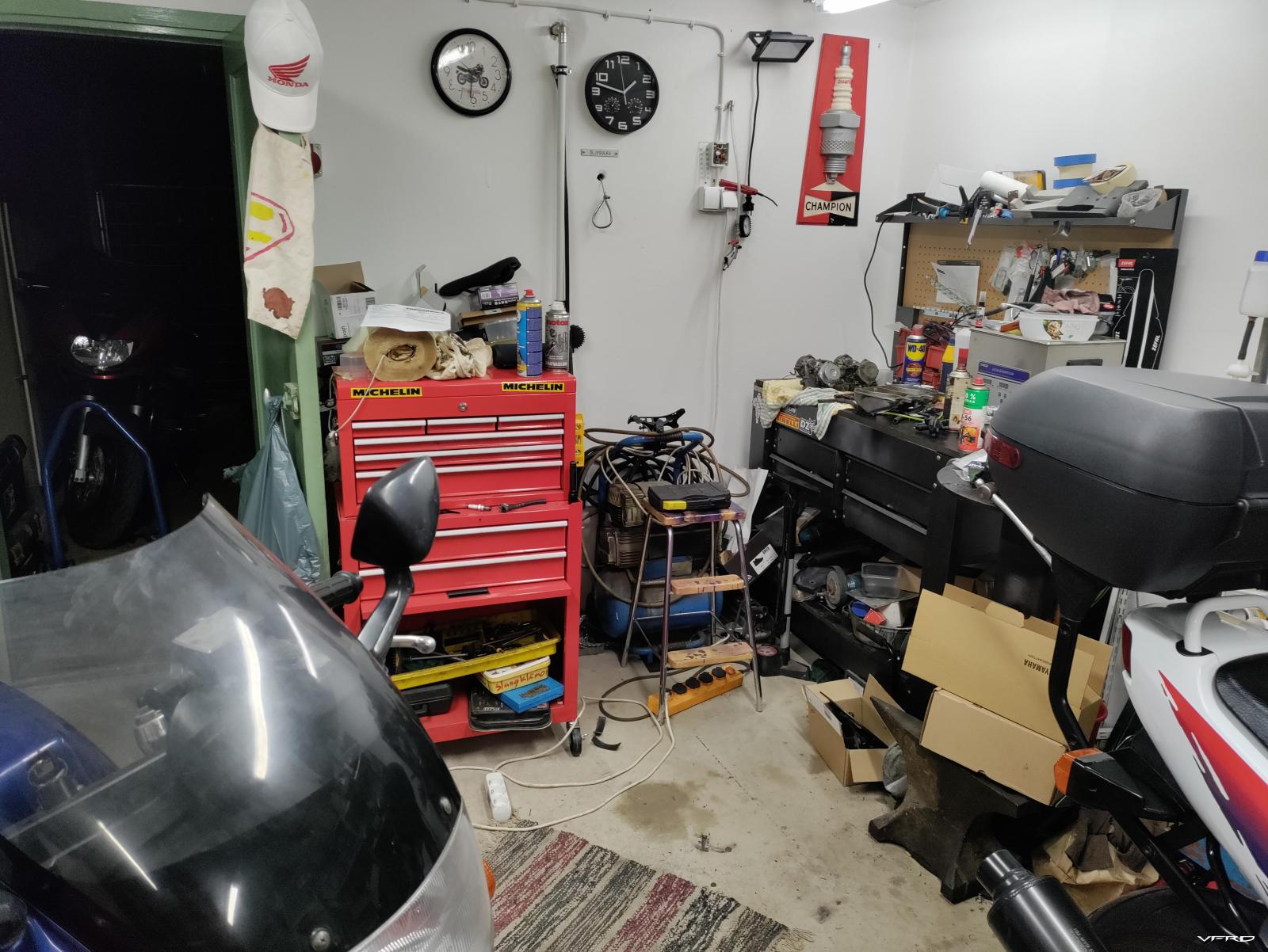

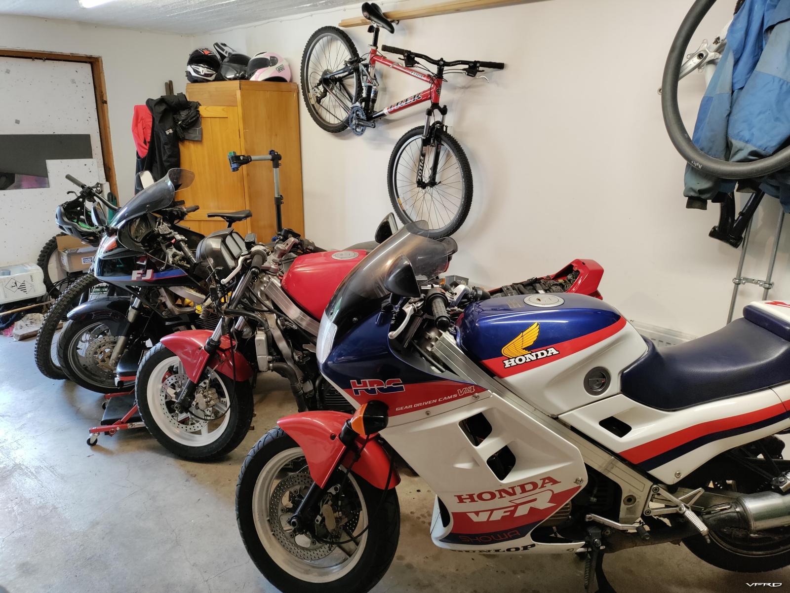

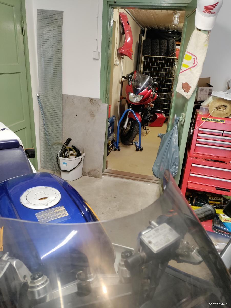

A peak inside my man Cave
2in project stage, 2 running. Well FJ only wait for a friend, a Yamaha shop owner, to have time to come one evening over and adjust the valves whit it's special tool as chims.
large.IMG_20240817_101835.jpg.11c838710f41d186a710ef8fc8ce6f9d.jpglarge.IMG_20240817_101844.jpg.0e7d4b9593c0d1a61f3ec819da0c1f21.jpglarge.IMG_20240817_213144.jpg.822aea9a4d56c73e652599fdda809412.jpg
Main garage, then the room next to where the ZR7S wait for cam chain change
And the CBX750 is pushed to the back of it awaiting restauration whit the 2 dirt bikes, a 92 Kawasaki KDX200 that is mine and a 1996 KTM 400 LC4 that is a friend's
The KDX actually just needs a gearbox bearing change, but as I'm not in condition to ride a dirt bike it been staying un touch, guess I should do it and just sell it.....

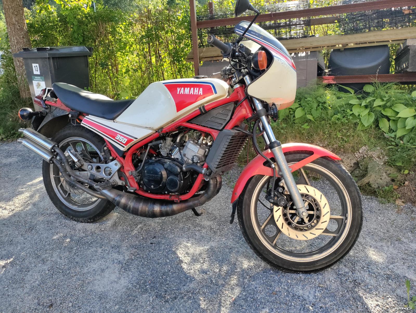

A friend visited today whit one of his rides, a Yamaha RD350 YPVS, also known as RZ350 in some parts of the world
RD350LC - One of my first loves. Totally bonkers but great fun. Had a fully faired one at one point. Made me feel like Rainey - hero in my own lunchtime!
My friend actually have 2 of them
He say RD stands for Race Dayly 😜

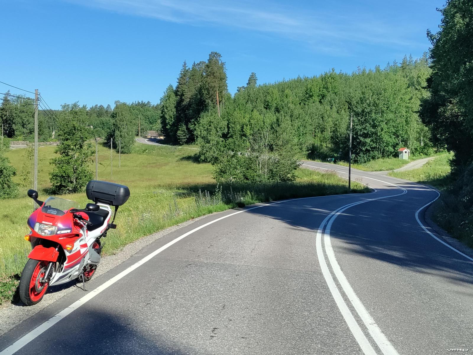

A spin on the 92 CBR600 always give you a smile on the face, as does this lovely cafe on a lovely twisty road
It was a warm day here today, and CBR running better than chilly mornings last week. Maybe crabs needs a overhaul next winter, or perhaps the reason engine temp gauge is not working is not the sensor but the thermostat stuck open?

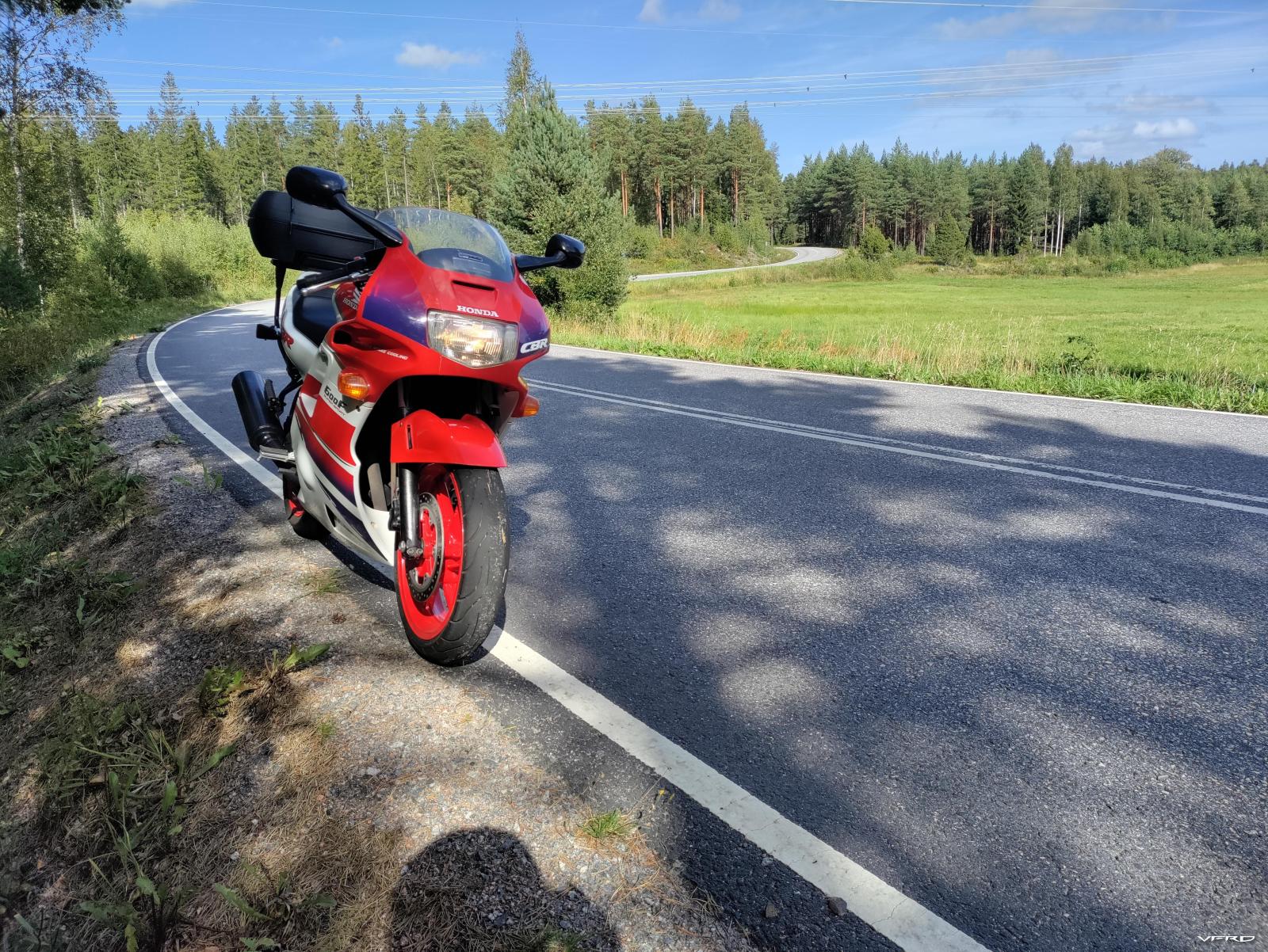

A great day today also for a ride whit the CBR600 on twisty road's
I must do a video to show you this lovely road. I need to dig my GOPRo to get some footage....

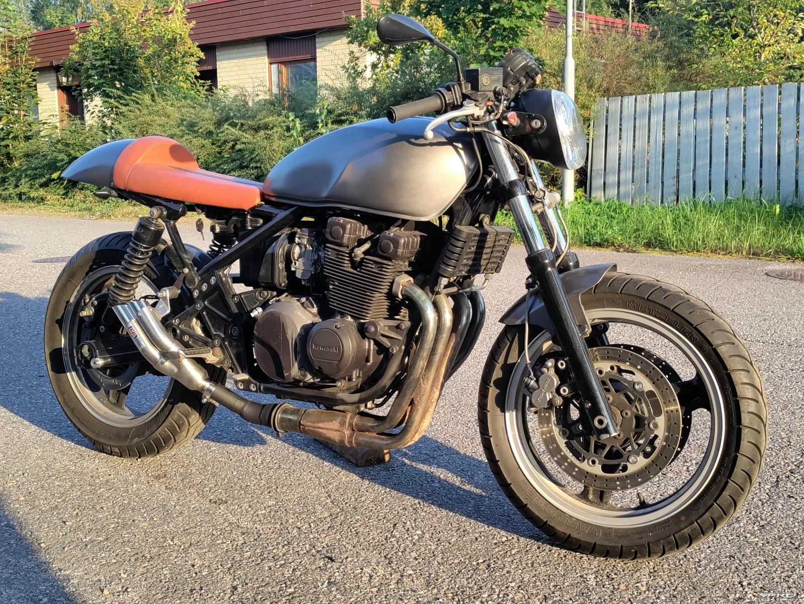

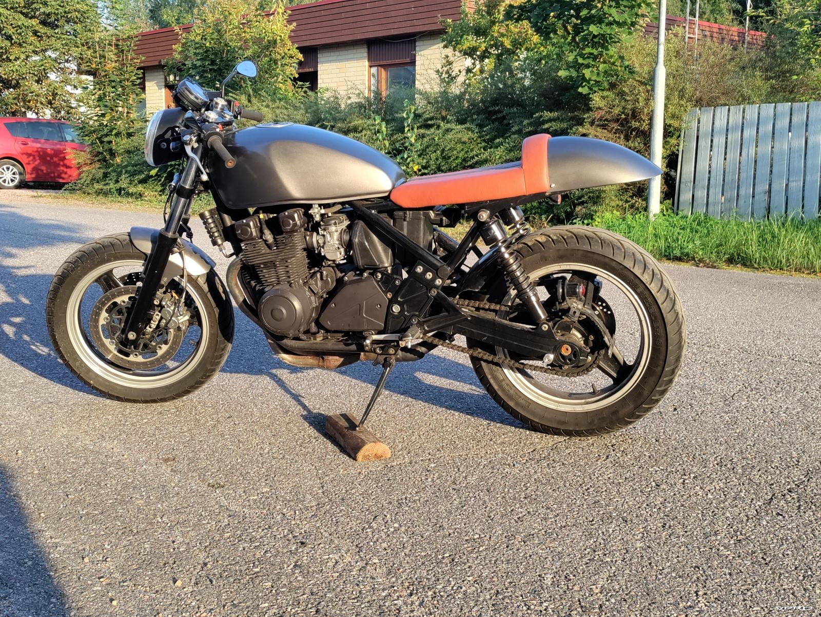

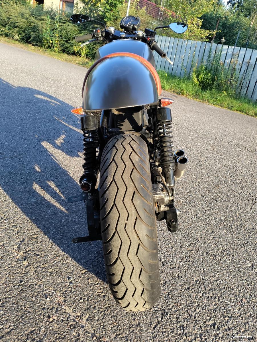

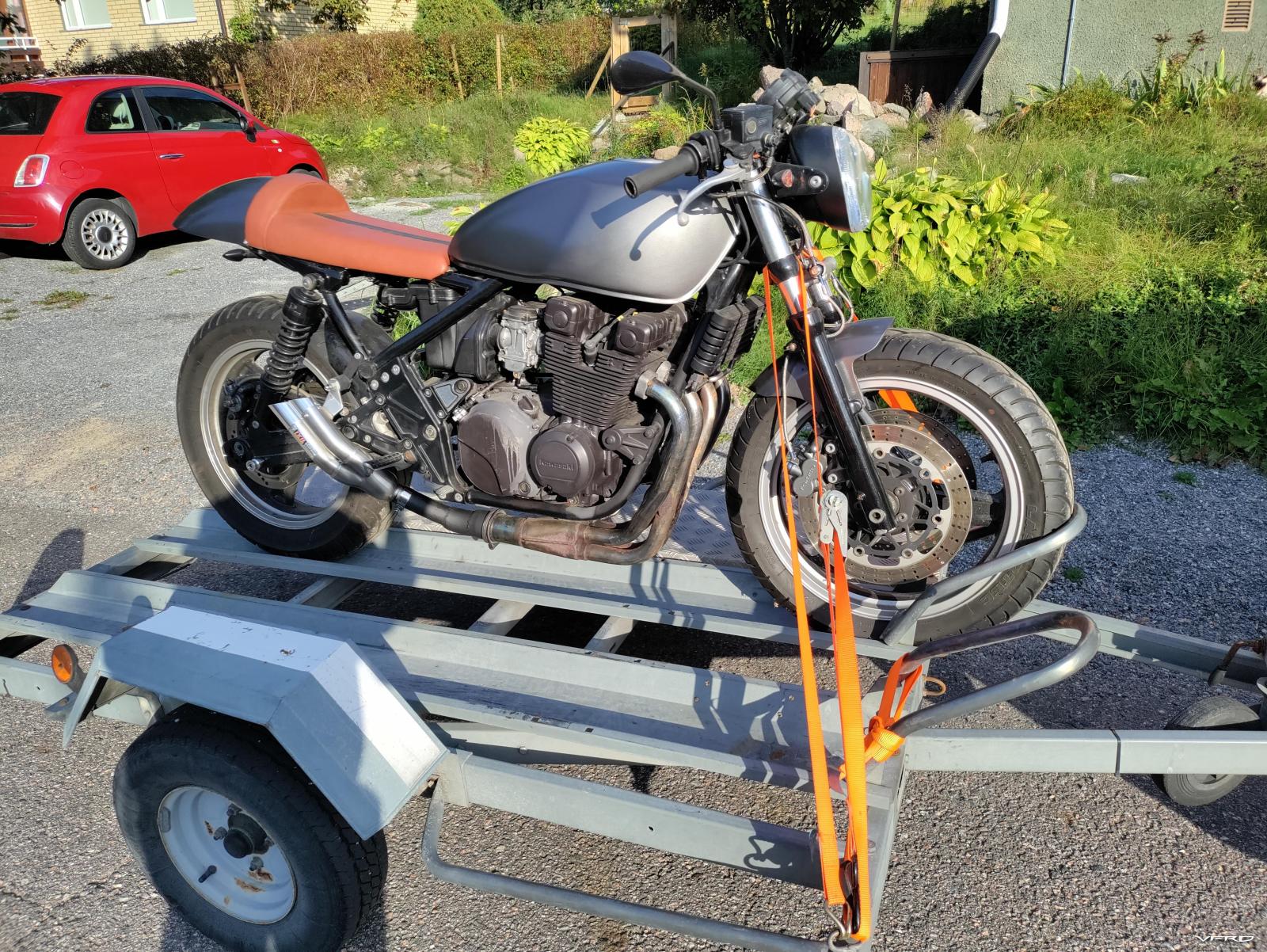

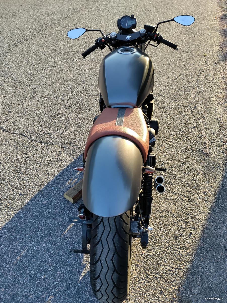

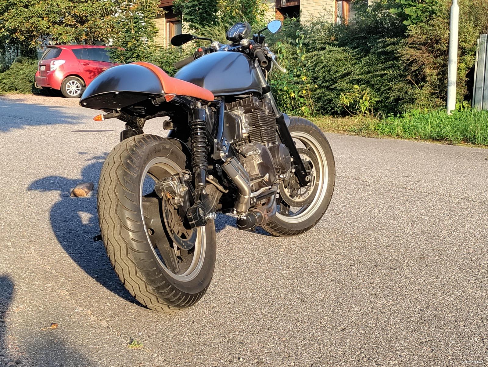

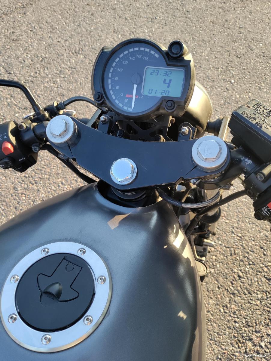

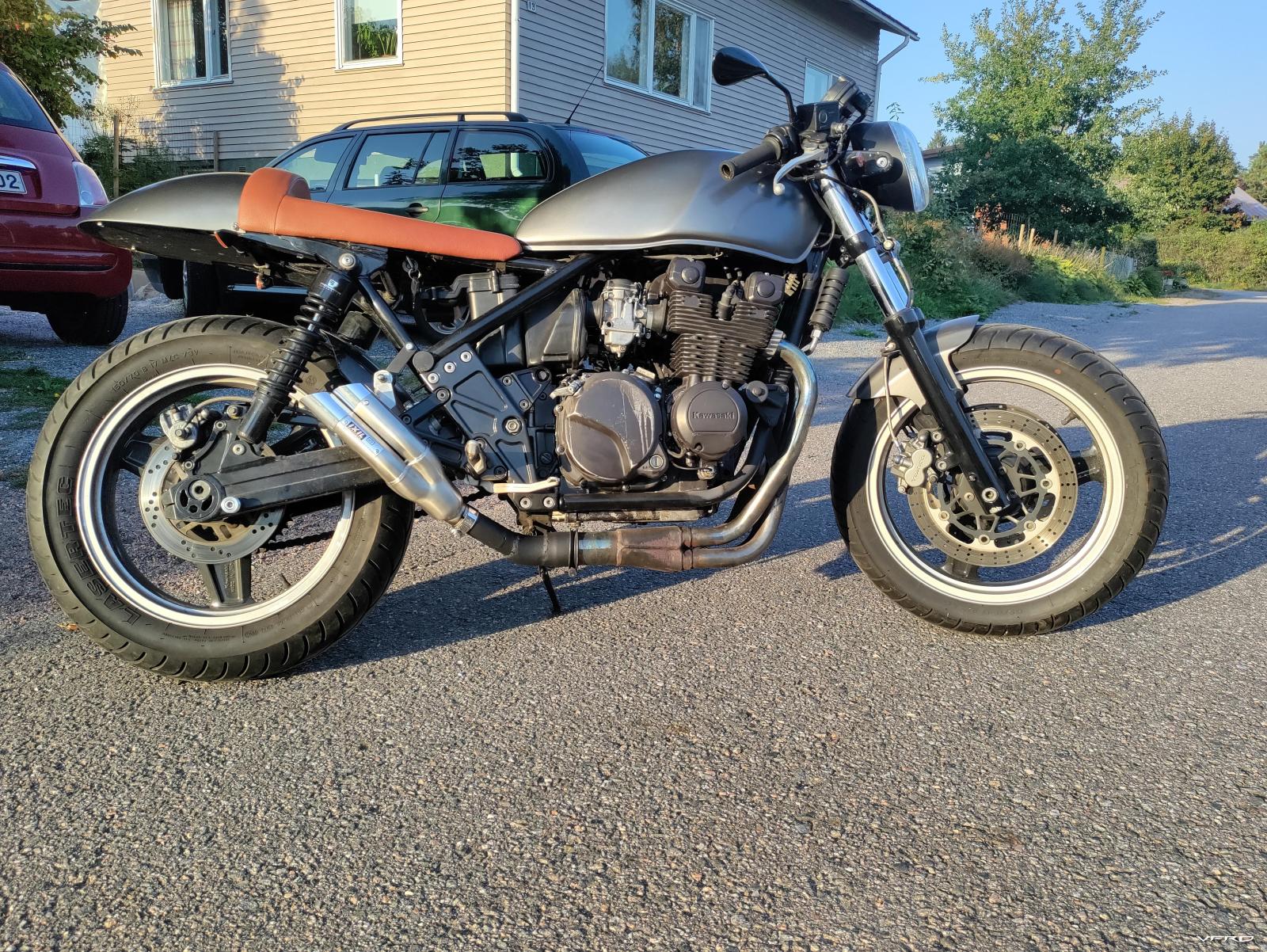

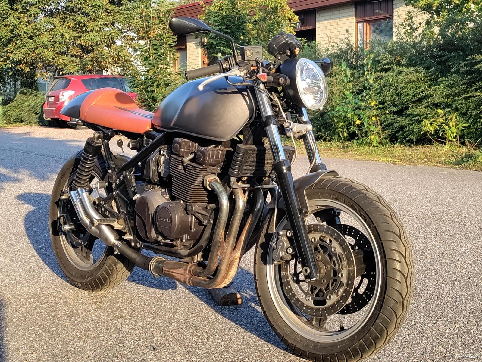

This one followed me home today
large.IMG_20240907_085812.jpg.73a0532411d5e279d3925d4565f26341.jpglarge.IMG_20240907_093023.jpg.29efd889e7b9df9a41186b8284c7c6aa.jpg
1995 Kawasaki Zephyr 550 that someone has modded to a cafe racer.
Seems to have Zephyr 750 wheels as fork.
So front 41mm forks as a 3x17" rim instead of 39mm and 2,5x17, rear is a 4x17" rim compared to orginal 3,5x18". Shocks are 10mm longer than orginal. Orginal airfilterbox 👍 but crazy loud silencer and looks like made for a smaller cc engine to. Koso instrument cluster, aftermarket lights, license plate as rear light next to rear wheel on left side like a Harley 🙈, ignition switch under seat even orginal, battery behind seat. Clip on handel bars that restrict turning quit a bit! Needs some tweaks, but running, new clutch, valves adjustment as carb rebuild. Way wrong size tire front, a 130/70 rear specific Metzler Lasertec, the rear 160/70 will be mounted on my RC24 whit the CBR600F2 rear rim I have.
Think this will turn into a Scrambler 🤔
This is motorcycle #49 I bought if I also count my dirt bikes

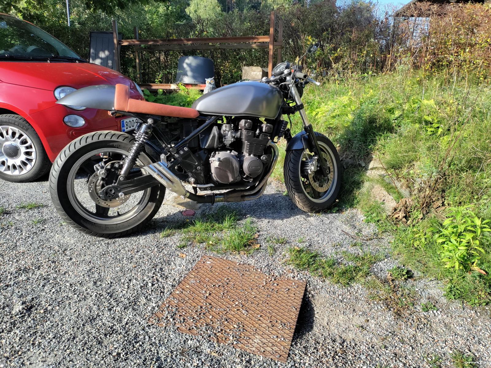

Some better pictures of yesterday's score
large.IMG_20240908_182409.jpg.d1ec657ca8085a80677f0d348a3026ed.jpglarge.IMG_20240908_182630.jpg.13077de1f068fbd428d0f5401c15d995.jpglarge.IMG_20240908_182603.jpg.2efed7a63ace4ba3b50a18435a6d167c.jpglarge.IMG_20240908_182539.jpg.dfdfa02a80d5d0ce225bfe888477fbd2.jpglarge.IMG_20240908_182433.jpg.cd7546a8c1c0b8989681c09f32c6113f.jpglarge.IMG_20240908_182356.jpg.6ac0f0f455ec838ab2213f2dfb458bf0.jpglarge.IMG_20240908_182254.jpg.9cf0241bd65dfb55a1236842a0126f29.jpglarge.IMG_20240908_182442.jpg.5111237281f7b547a66288fbed58dd7a.jpg
Thoughts are welcome 😁

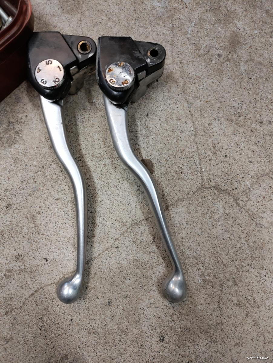

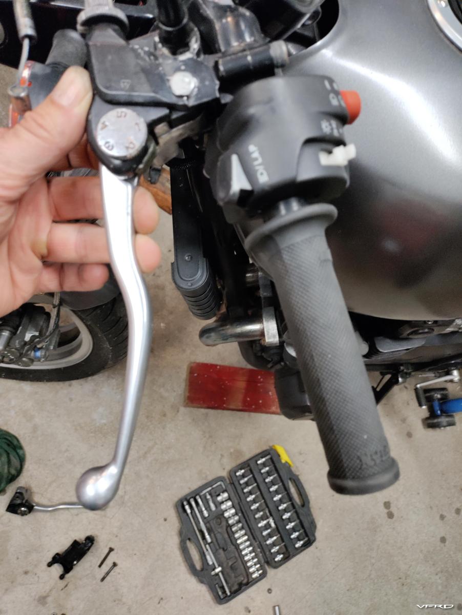

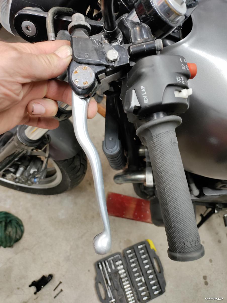

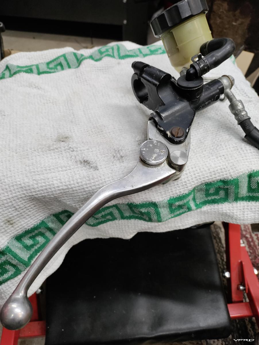

So I have found out why the Zephyr 550 "cafe" clutch, that is just rebuilt, did go toast, and should so had  soon again if not this had been done, a good clutch level
It's actually amazing that someone would be using a bent level that makes the pull so short that it has to be adjusted so tight it's crazy! Well I guess it's how you cut costs as you rebuild a wracked bike into something to sell...this bike has been written off after a accident in 2012, but I know the frame has been measured and in spec, a reason I could think of buying this bike.
large.IMG_20240913_180548.jpg.ee830c62028276315fe3d0ffdc7ee41f.jpglarge.IMG_20240913_180614__01.jpg.c7ee2d59f4077c7bbfe0f31a529778e6.jpg
More visual, bent level in upper picture, orginal shape in lower

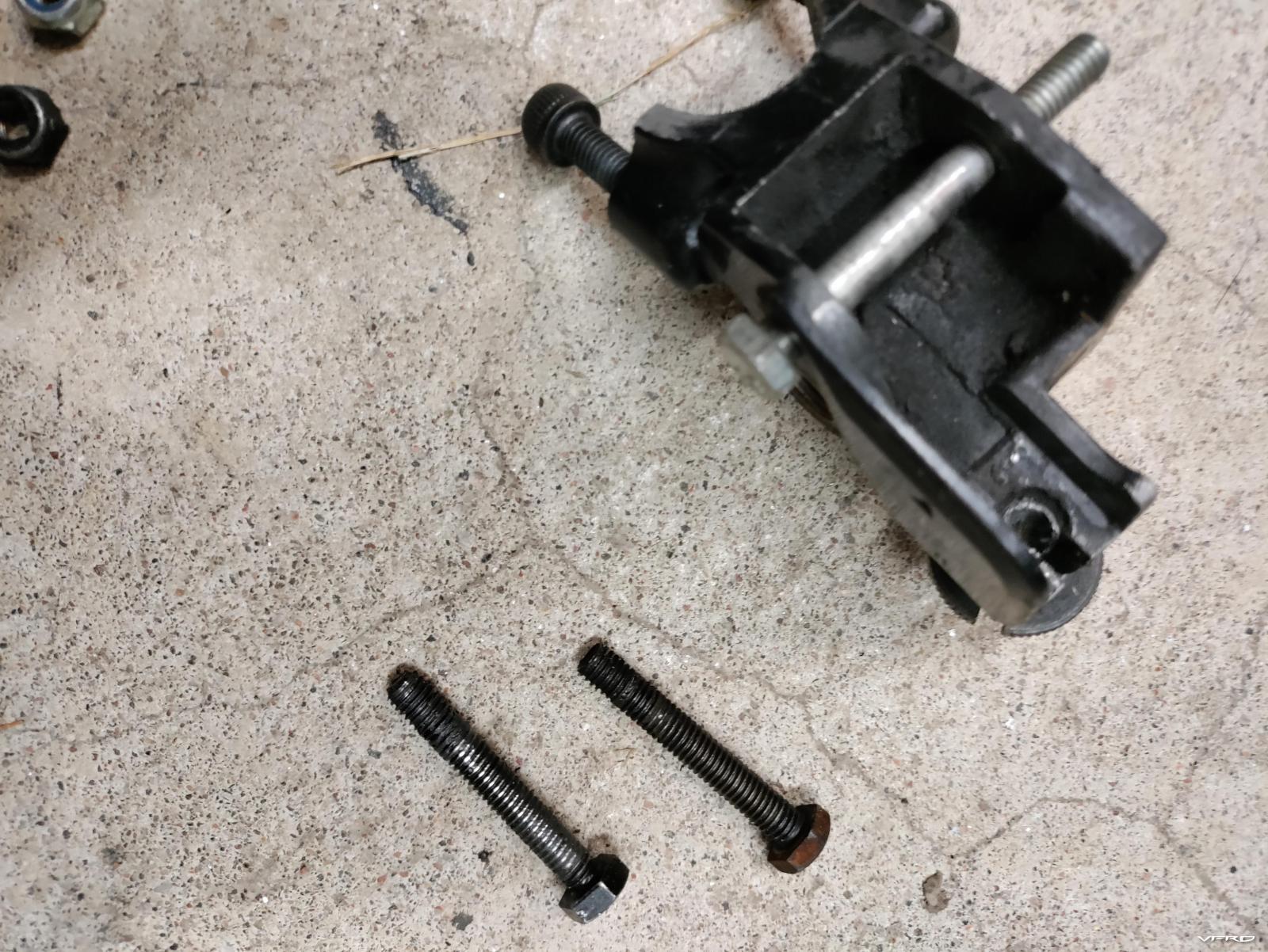

Then a other crazy thing, why put a long treaded bolt in a level as it needs one whit a flat area where the level movers!
Both the level on bike as the second hand I bought had so, now whit a more correct bolt. Next I need a new clutch wire, current to sticky for my taste.

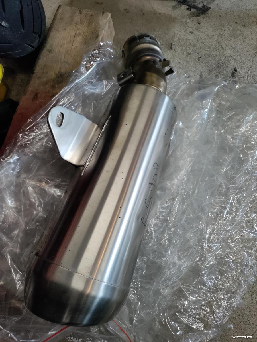

I hope to mount this silencer as I don't like the one now on the cafe.
It's actually a OEM Kawasaki one in the picture that I like to mount, it's from a 2020 Z900RS

Well sadly, decided the CBX750 would be a to big project, at least not economic wise, and as I have other bikes whit higher priority I decided to pass the CBX750 on,
Well the turn signals did stay for my 1986 VFR750F's, as did the cable loom for the twin headlights but still sold today whit a small profit 😎
