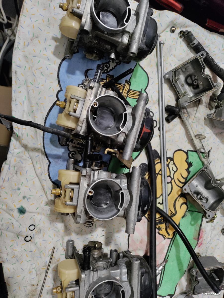

Working on the Bandit 600 today.
Carbs off and apart
large.IMG_20240408_085226.jpg.026007ff1d46aced1d93f3ccce5fd741.jpglarge.IMG_20240408_093342.jpg.74459e99a87e5ce14661324dd4b5d661.jpg

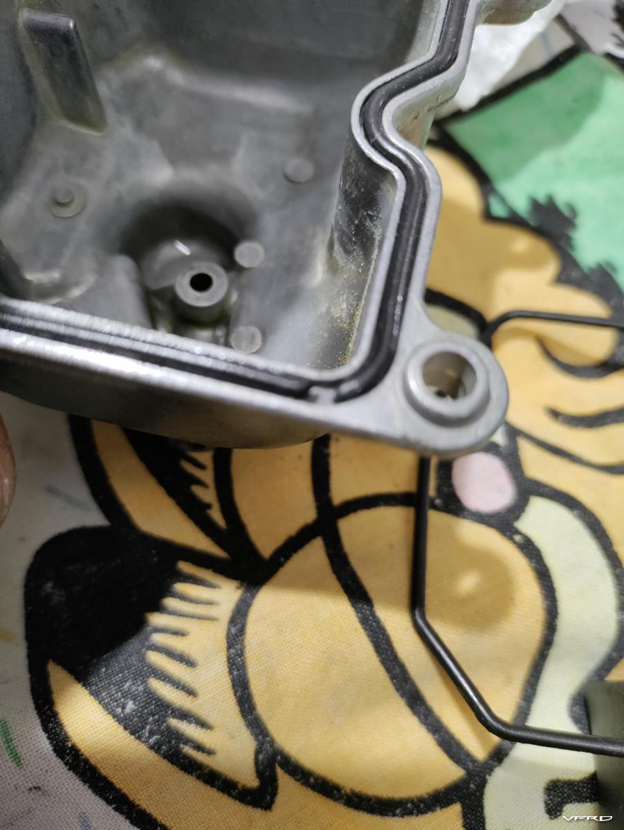

Looks like someone had glued the float chambers to the crabs as one failed and started to leak
So got new, as all O rings as well

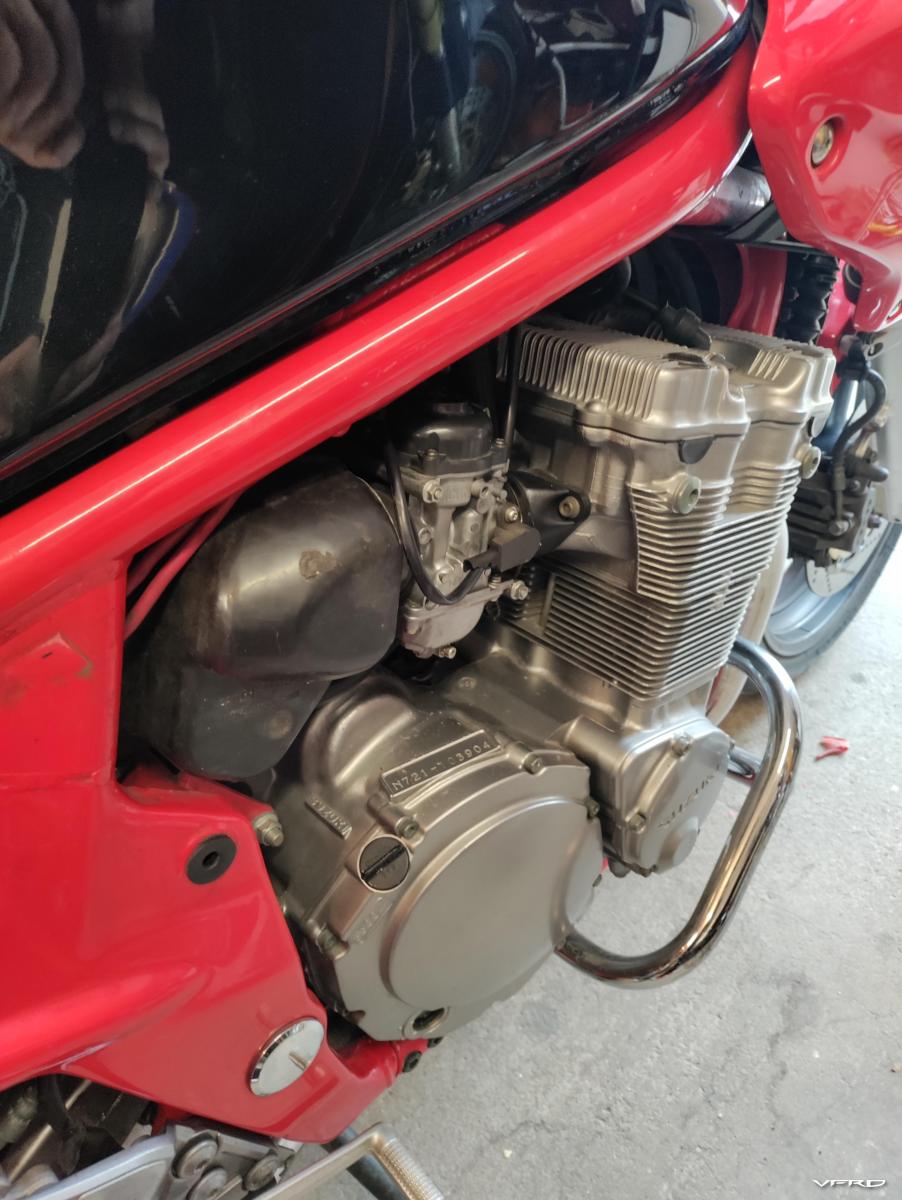

XT350, carburetors back together and back on bike
Also the tank paint damage repaired for now, maybe a full respray next winter?

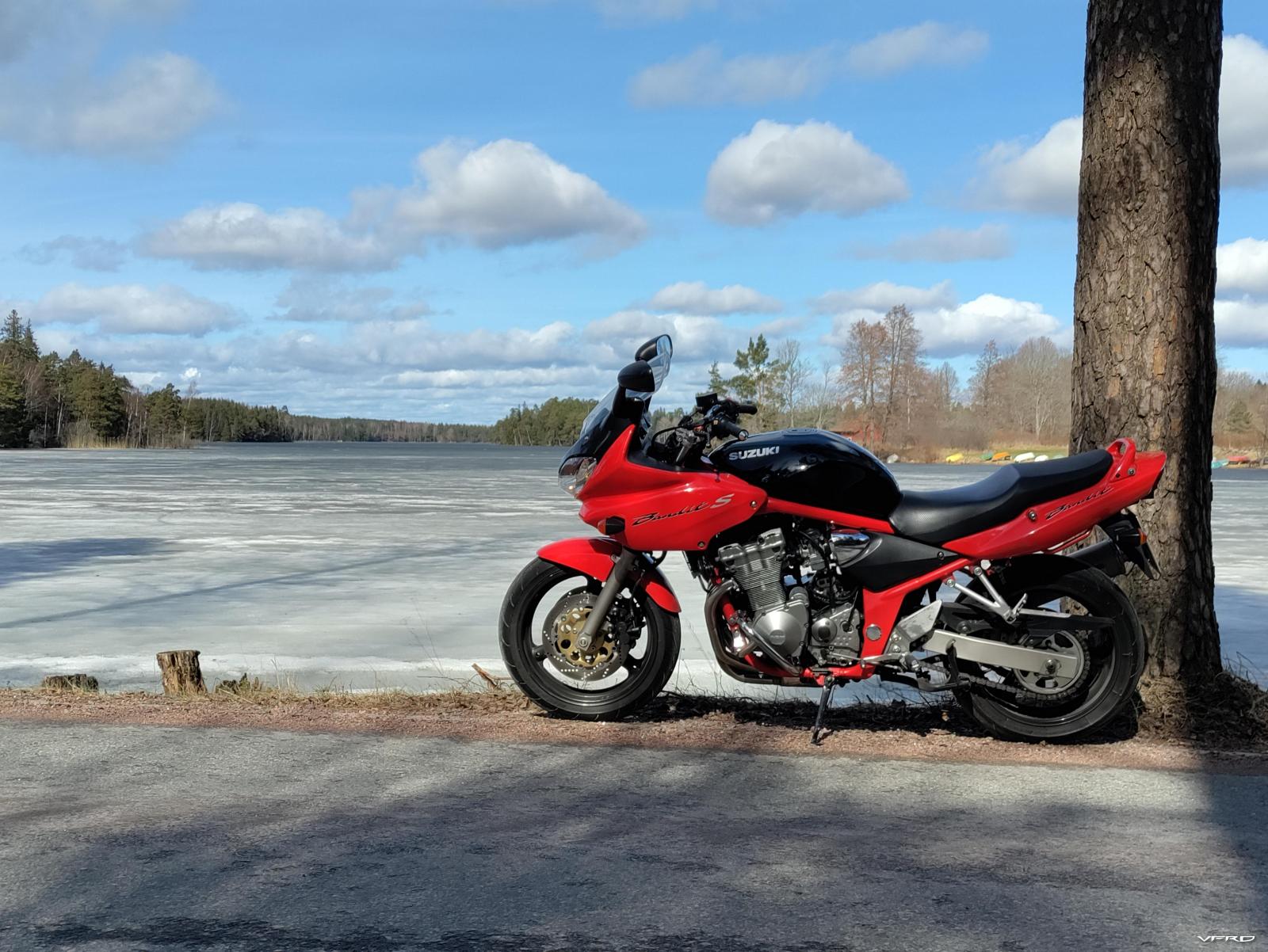

Today season opened
The Bandit was a positive surprise, ok the aftermarket can a bit louder to my taste but that's easy to fix. Rides good, engine more flexible than I had believe, no sky rocket but still fun.
Well it's still ice on local lakes
And you had to take it easy as roads partly covered whit light gravel from winter that has not been taken from the road yet

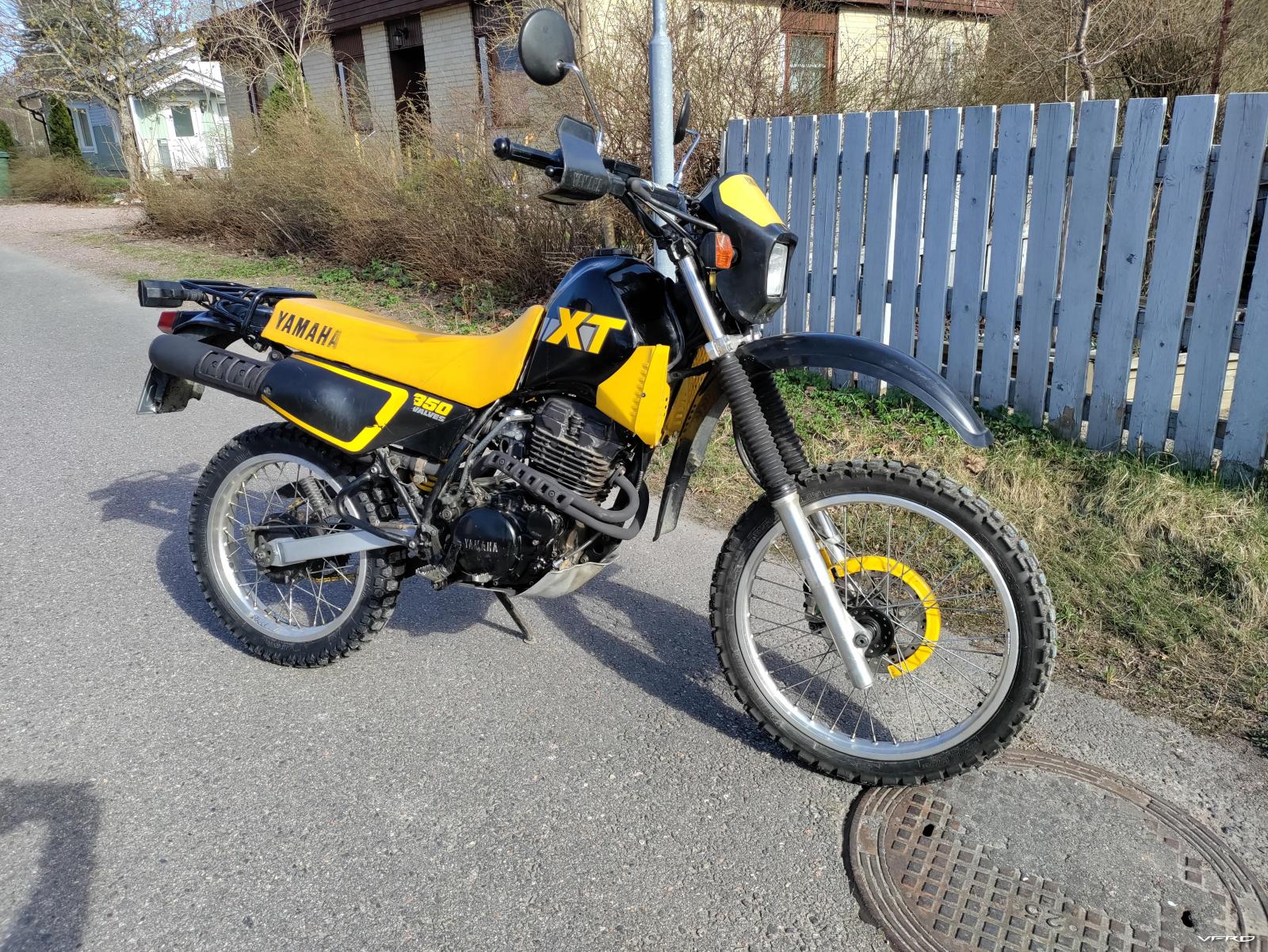

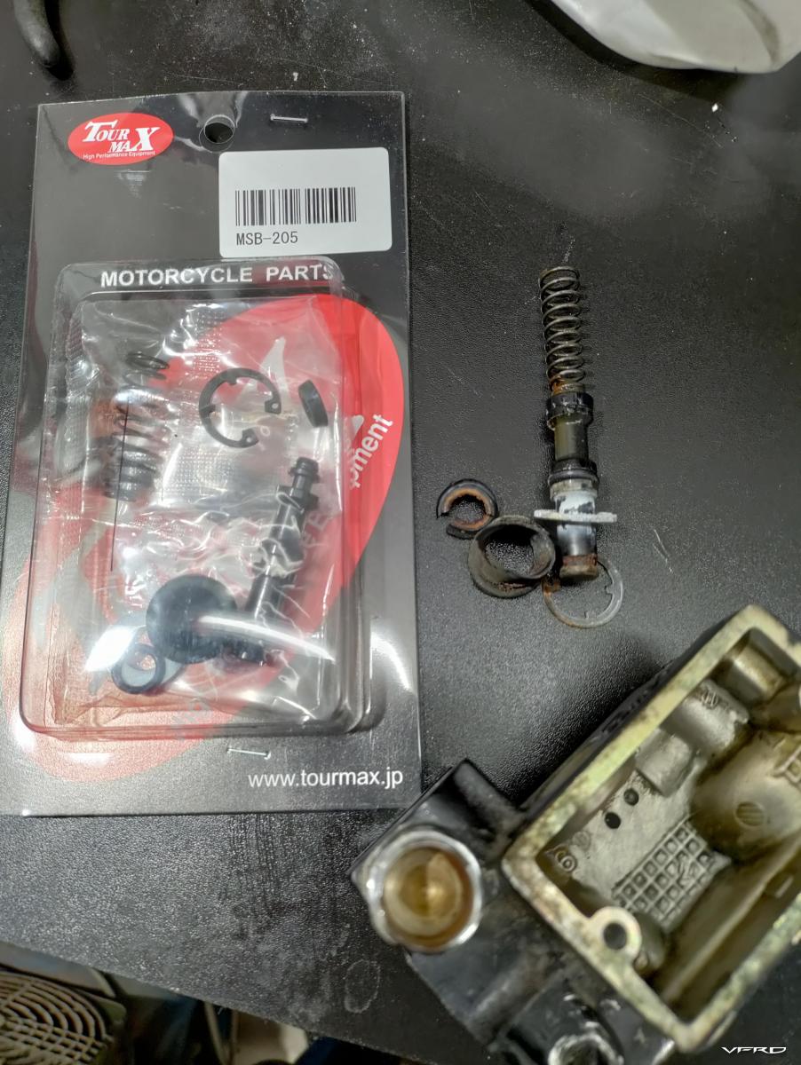

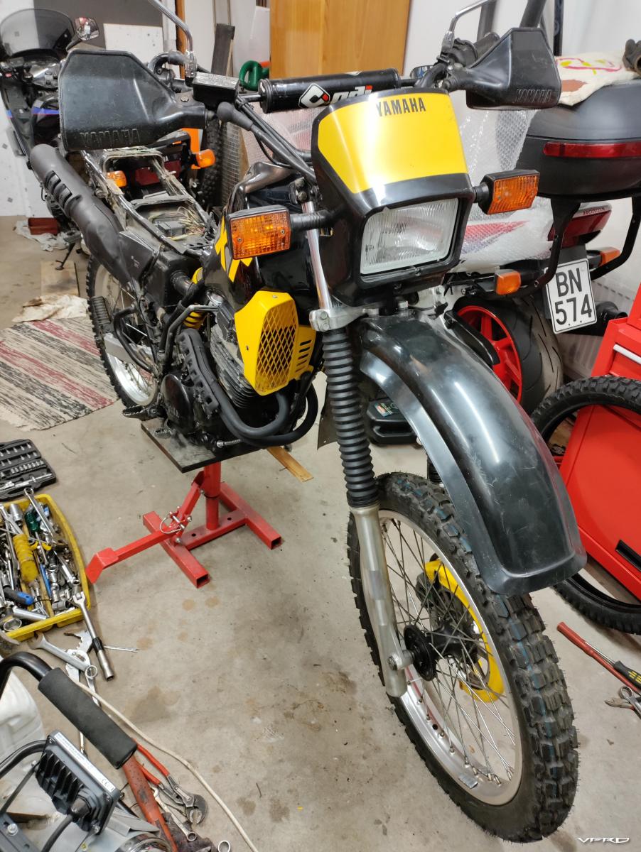

Got the rebuild kit for brake master cylinder, old out, new in

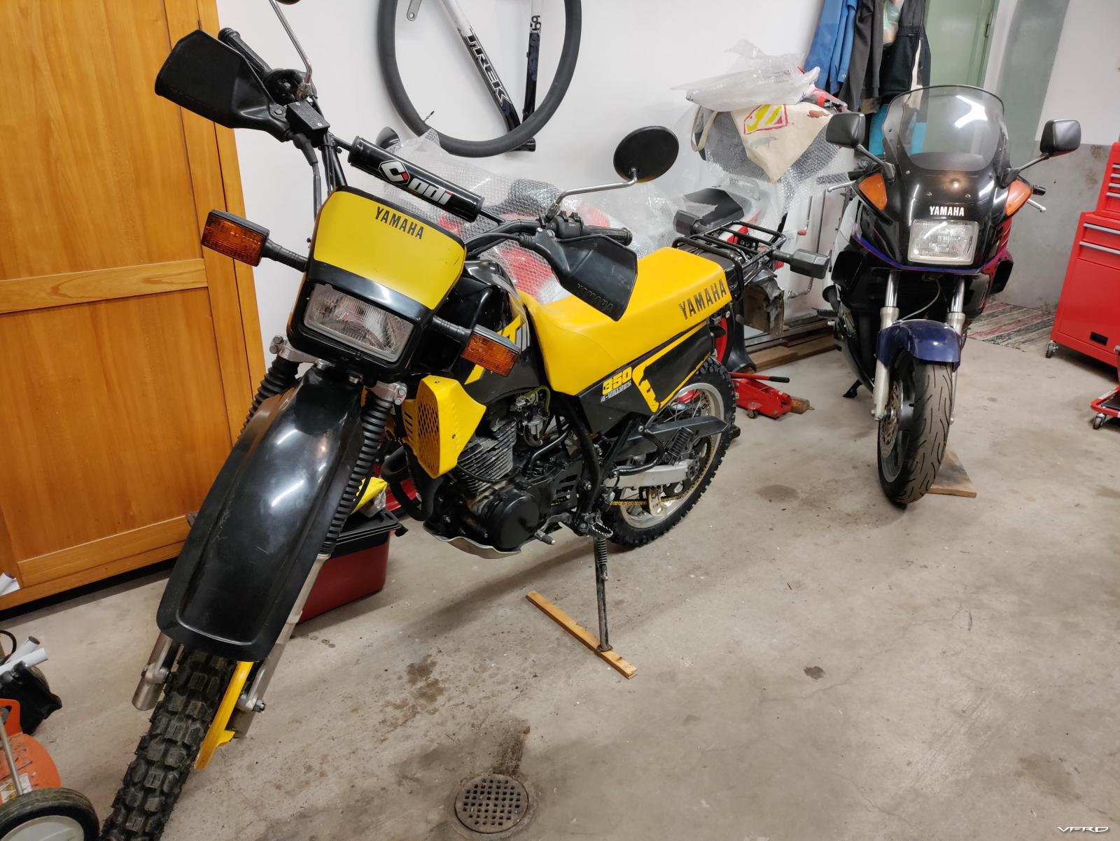

Then XT finally going together, Handel bar weighs on as orginal grips, the air scoops on as tank, front brake bleeded, painted exhaust on
Don't know if you notice but the front tire has been changed, as I bought new the shop only had size 80/90-21 in stock, orginal size is a not so common 3.00-21, the rim is only a 1.60 so to small for a 90/90-21 that needs a 1.85 wide rim.
But the 80/90-21 is quite a bit smaller than the orginal 3.00-21, even the 90/90 is slightly smaller in outer diameter. But then I found one selling orginal takeoffs from a Yamaha WR250R, 80/100-21 is its size, and its very close in size to the original 3.00-21! So as I got a new tire that just been on rim, well ridden home 20ish kms for 30€ I could not resist, it's a Bridgestone TW301, had before on my Tenere 600, know it's ok rubber.

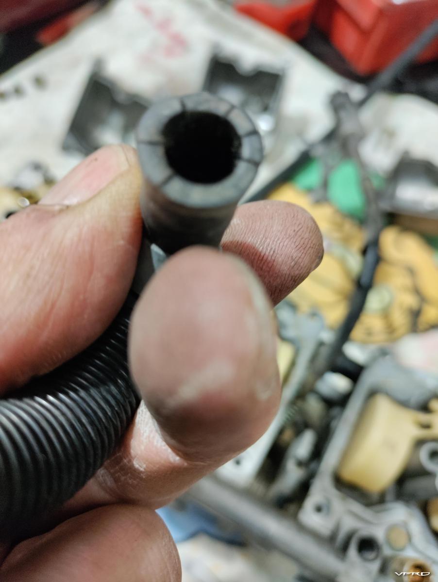

And this picture is after having it running for a while, needs some final touches as carburetor's off one more time as tube between primary as secondary carb is slightly leaking. But it rains today so I'm not that keen for a test ride, even looking forward for it!
The XT350 has now the small fuel tube between primary and secondary carb changed
So it's ready for a test ride, need to get a insurance for it that is surprising costly for this model sadly. Also the fact that winter has strike back where I live also delay a test ride

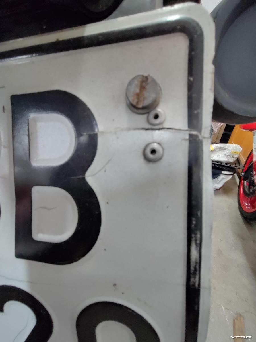

I have ordered a new license plate for it also, the old one is cracked

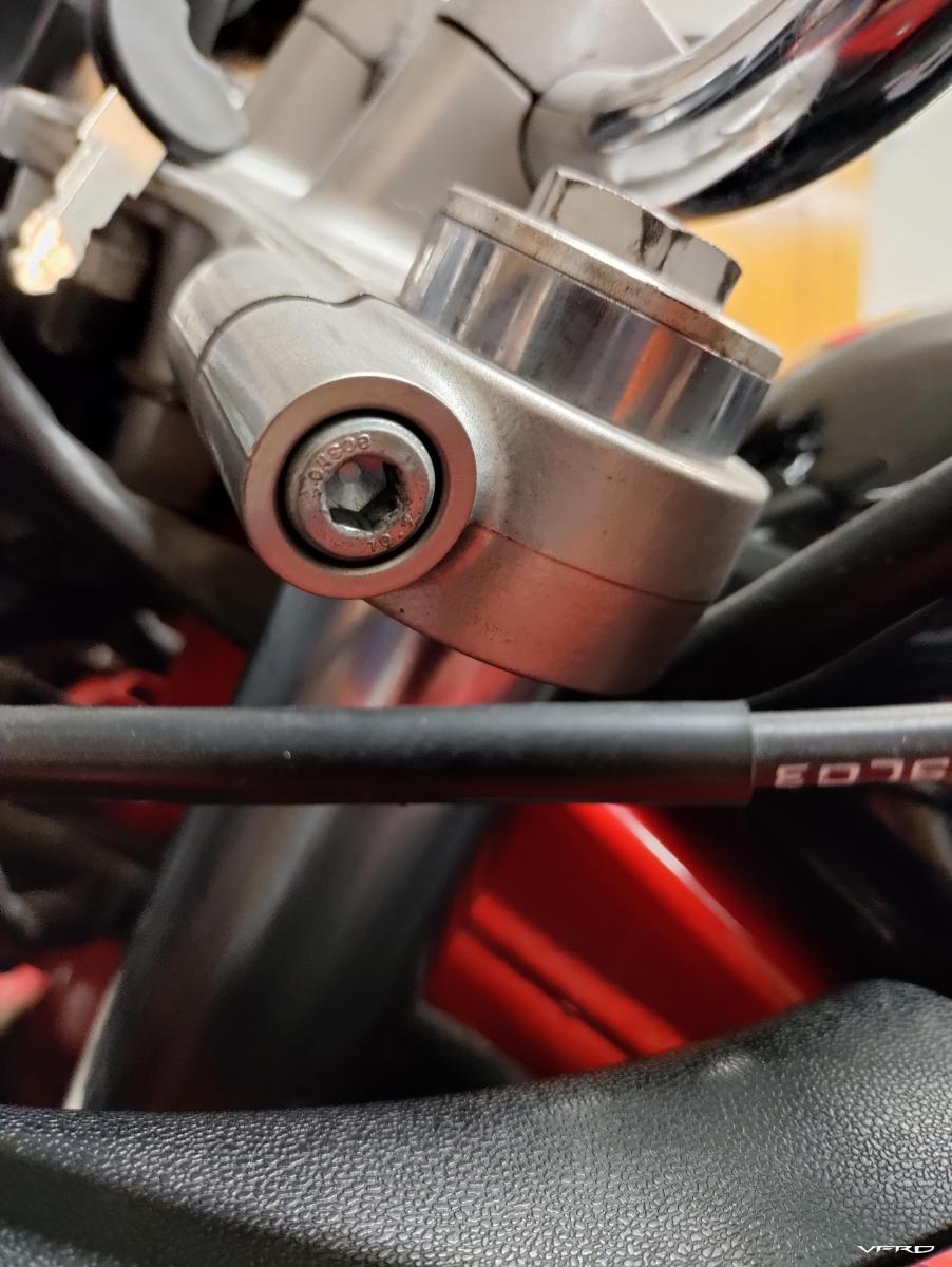

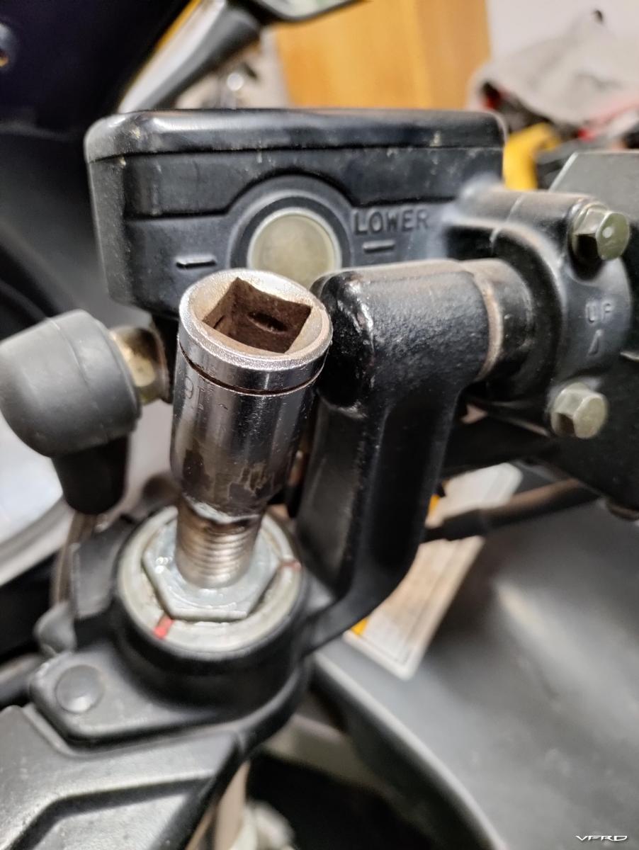

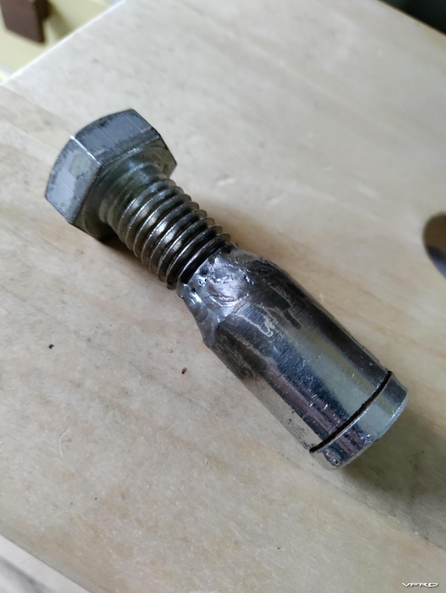

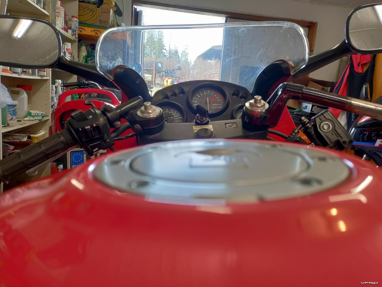

So next I thought I should give the FJ some love, but there came up a issue straight away

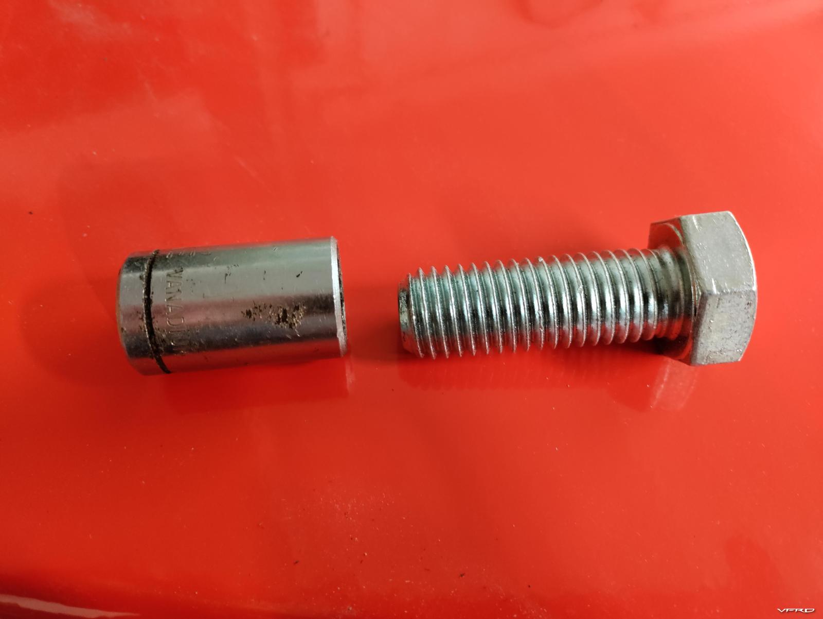

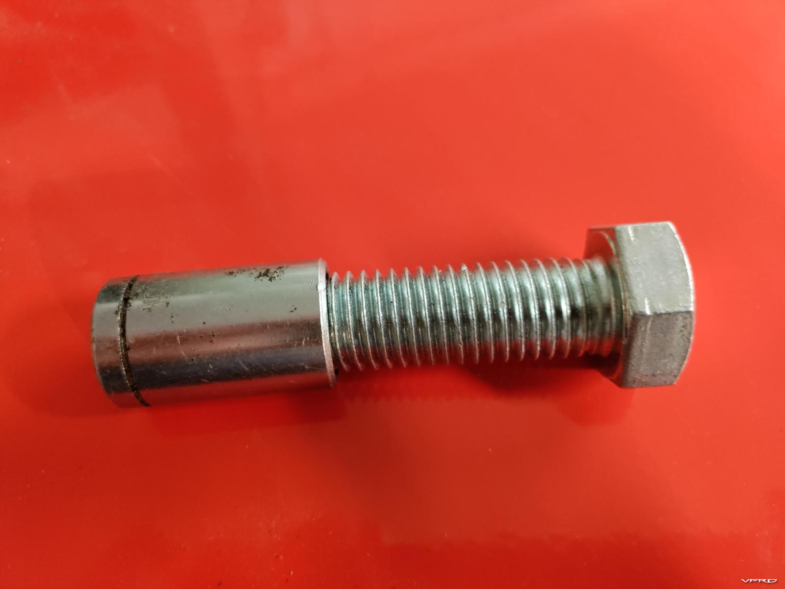

As you si in the picture the fork upper has a unique fasting, you need a 27mm alien key to open then, biggest I had was a 25mm...
As I have mixed feeling for the FJ, and don't know if I just should list it as I get it running, I didn't want to spend a lot of money on a tool. So a friend will weld (as I don't have a weld device) this socket to a bolt whit 27mm head to make a tool.
large.IMG_20240420_135650.jpg.618c26efbc717715bdaf9ab24a7f0b93.jpglarge.IMG_20240420_135656.jpg.e59ee964632048cec2d51a34f97bd726.jpg
So have to wait...
Nice! I still have some FJ ABS parts for sale. Seems like there are far fewer out there these days.
Tool is ready
large.IMG_20240422_165650.jpg.160b904a41669e3fbde43b6babe42d9d.jpglarge.IMG_20240422_171500.jpg.a9aa2877e258bc268fb4708733190cd0.jpg

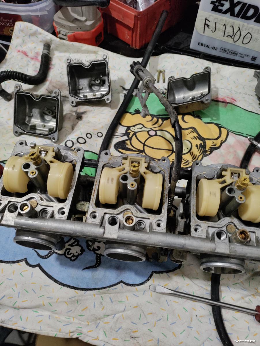

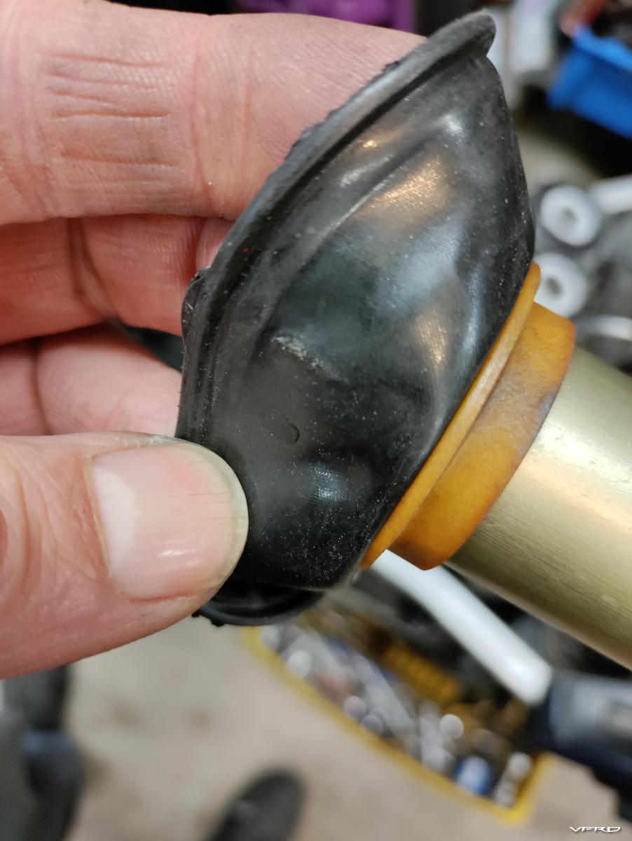

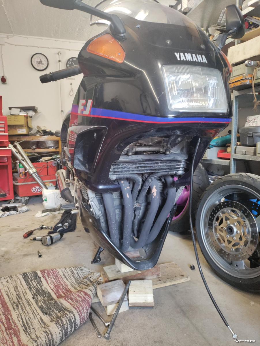

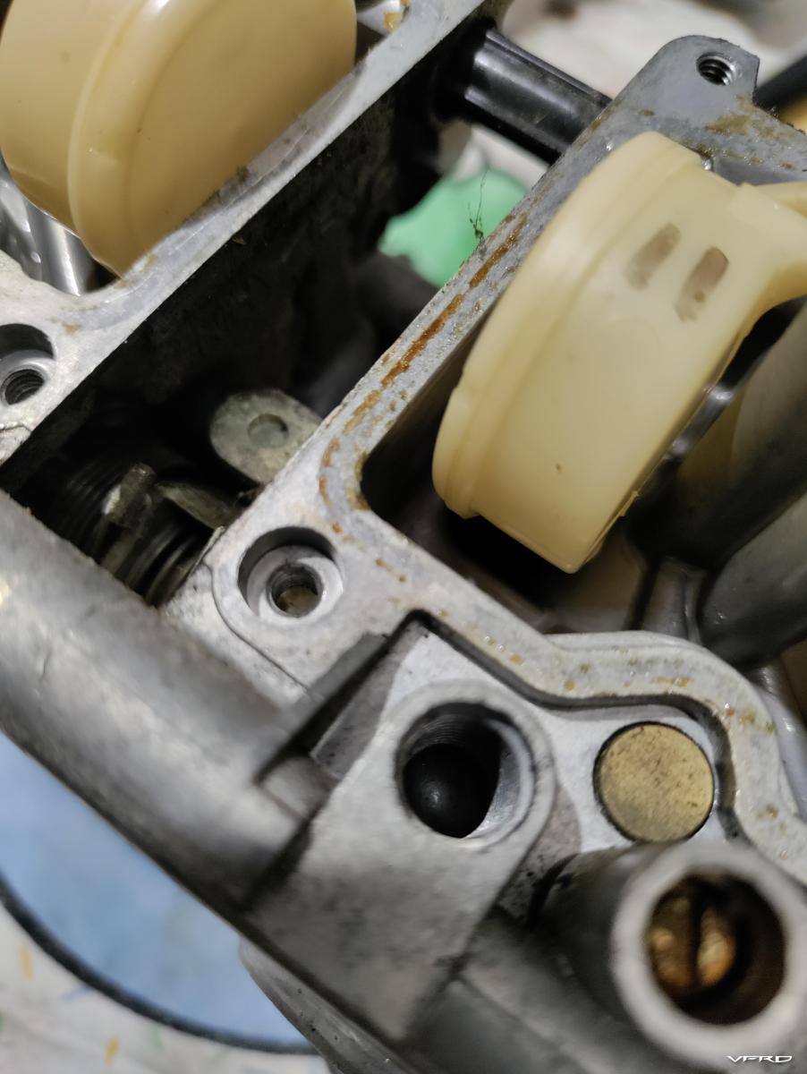

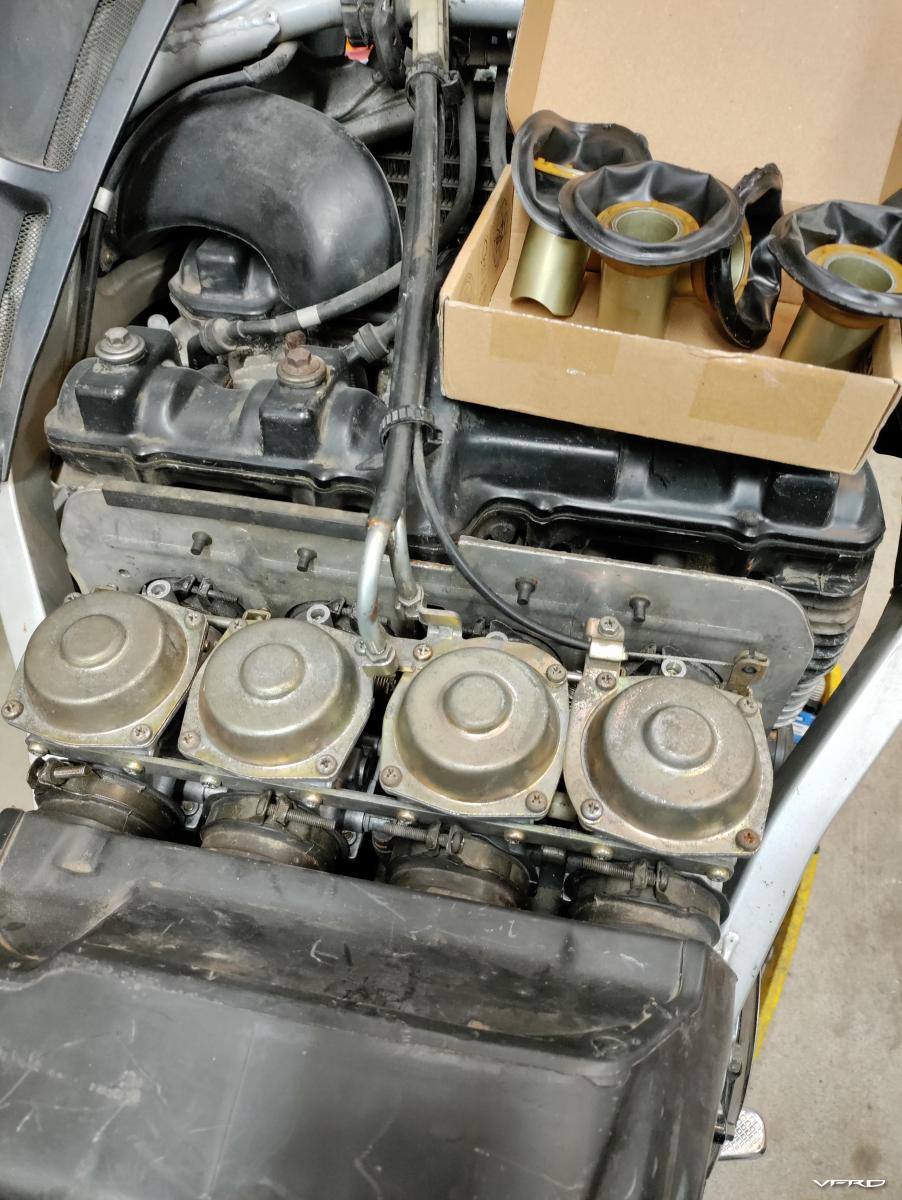

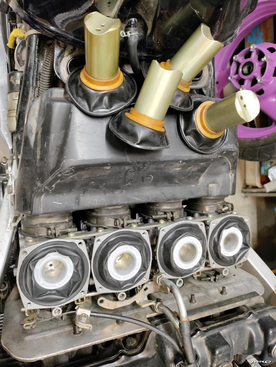

FJ still, but not fork yet, but carb diagrams.
large.IMG_20240428_091804.jpg.52c1895fc6cb907750d1ed72fb15905c.jpglarge.IMG_20240428_091810.jpg.a5aa86be0eb8956aa31e8a1d5bb9b549.jpglarge.IMG_20240428_095500.jpg.7987da61f0c55a80dc2e1a6cc1a78cc4.jpg
The old where no good anymore, even the plastic dip paint treatment didn't help, only worked for a day. Costly parts, OEM list price ~150€ each!, aftermarket parts locally in shop ~100€ each, managed to score these from ebay for 320€ for 4, and they are OEM mikuni ones!
large.IMG_20240428_095445.jpg.f9b77bd81bbf0e97d925246a6b1a4f35.jpglarge.IMG_20240428_100433.jpg.bc6e9f0165e9a77e41b4afc59eae343b.jpg
Have to say was quite tricky to get the needle plate in place as there is a spring under it to hold needle down, other a straight forward jobb.
I have never heard of this hack before.  I'll have to say, I am absolutely not surprised it didn't work.
Believe it or not, there are many that have been lucky to repair there diagrams this way! A guy I know on the Canarian islands have ridden many years whit his repaird this way, he has a FJ1200..... It only repair smaller holes thro, mine where to bad

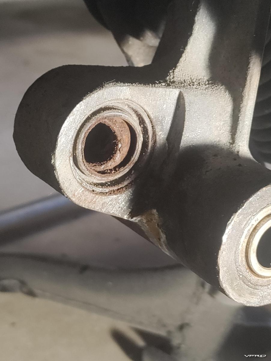

Today's jobb
First sorted the noice in the linkage, shock lower bearing, or uniball, was reason
Then forks off, new seals as oil in.

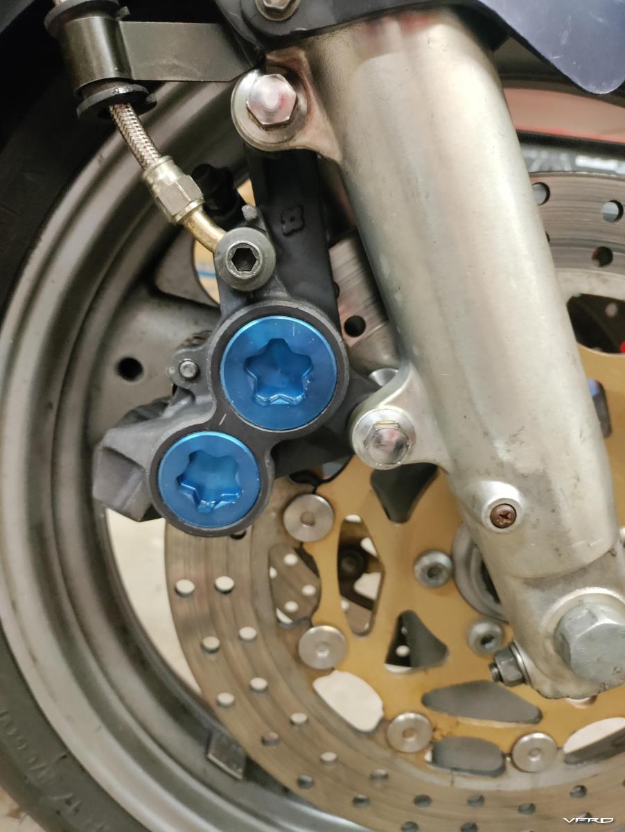

After forks back on and the rebuilt FZS600 Fazer brake calipers on
That whit fresh rebuilt OEM master cylinder for brake as clutch

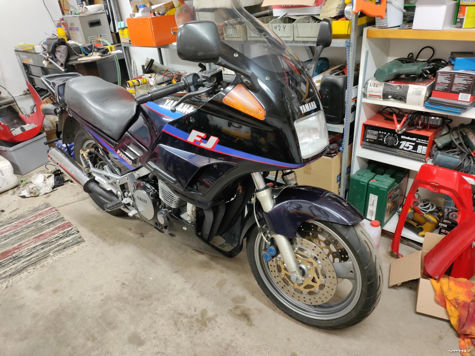

The FJ is alive, started good, didn't run that good at lower rpm at first but did start run better, did a Sync that might have helped.
Insurance is on from tomorrow so will do a spin on it, hopefully starts tu run better. It's been sitting almost 2 years, carbs been dry thro. However definitely have to many motorcycle's, so it's also listed. I had a few plans for it, but will not ba made, limited time as funds and just want to put all efforts on my RC24 VFR750
Ashame in one way but you can't have it all, and enjoying the Bandit 600 very much, only like to find a OEM muffler/silencer for reasonable money, the current aftermarket one is to loud for my licking, I guess I'm getting old 😅

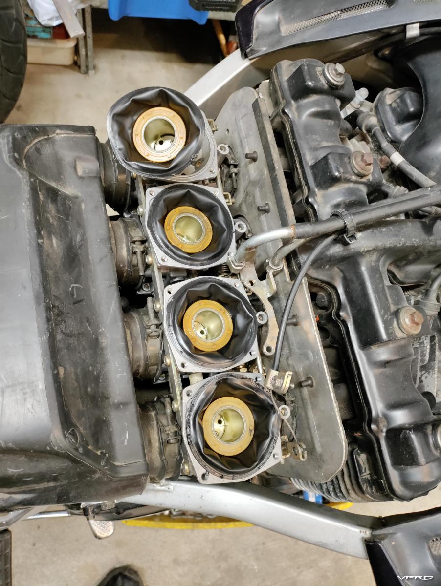

Well, eventually the FJ is not running as should, and even seems to ride a bit better at times decided I needed to pull carbs off to check, as aside the diagram issue it did run great 2 years back

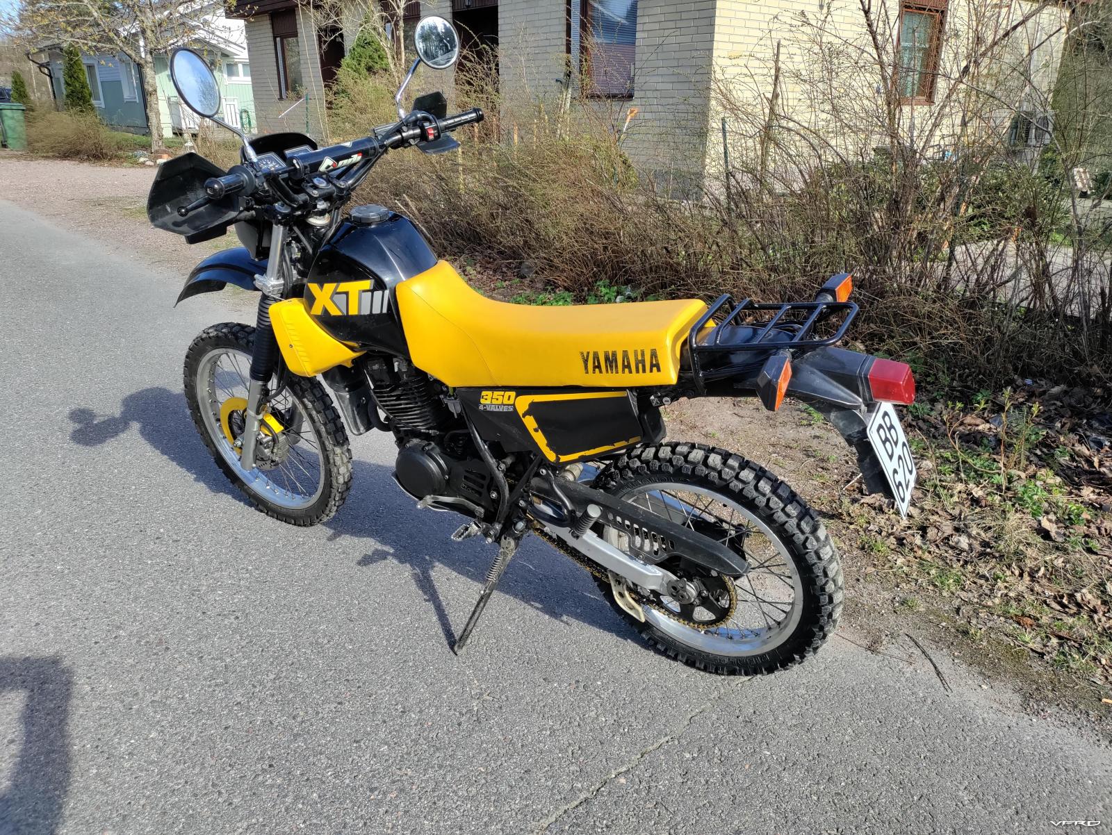

So decided to try the XT350

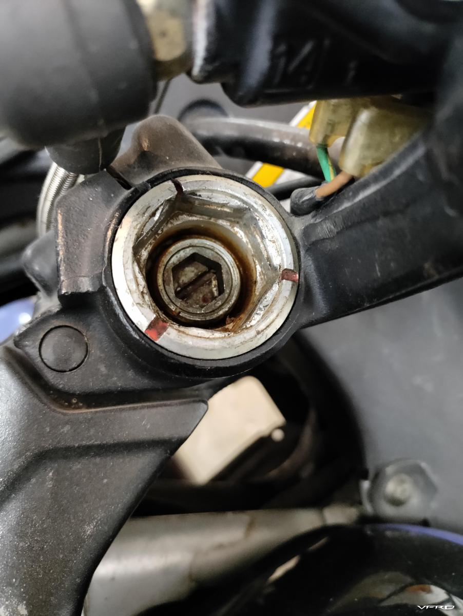

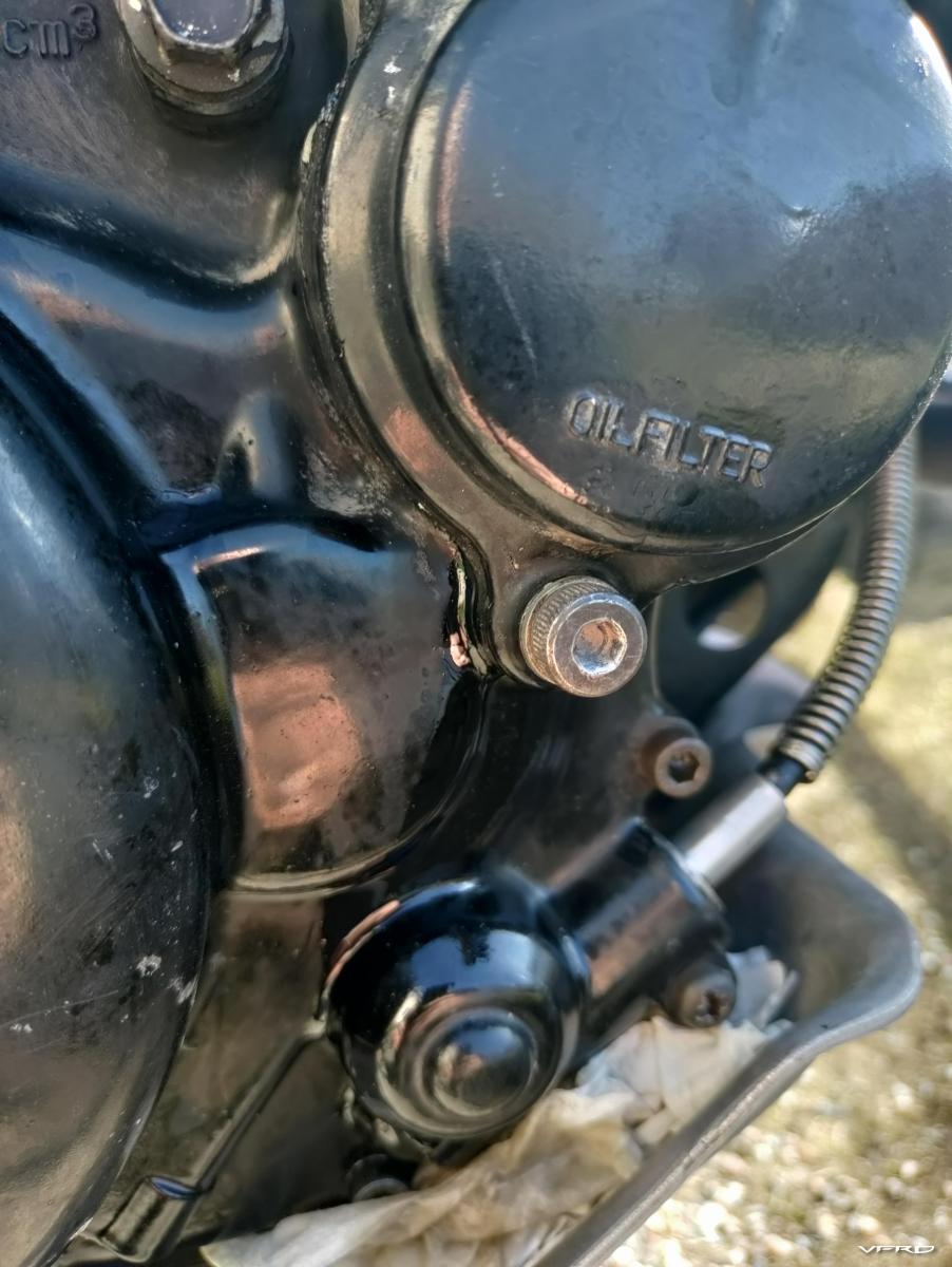

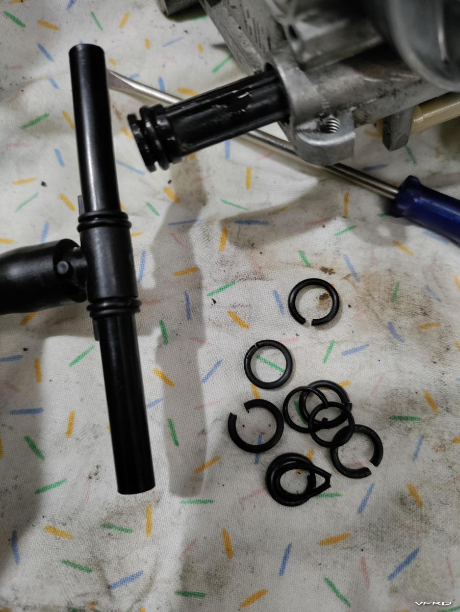

Did take it to work this Friday, Fortnite a short ride. Well a issue came up. First the front brake is not as good as should, second as I did go on lunch noticed something has leaked under it, turn's out the oil filter cap is leaking for some reason. Have to check out why. It hade been sealed whit some silicone aside the O ring before, have to look into reason.
Hopefully nothing major.
Might try fresh brake pads for the front brake.
A one more thing, a secondhand OEM silencer in on the way for the Bandit 600
Found oil leak reason of XT, a O ring missing at lower bolt.
But. After riding the XT some, must say it's a disappointed sadly. Not dirt bike enough, power could be more, and not a bike I would do big milage on, even looks are good so...

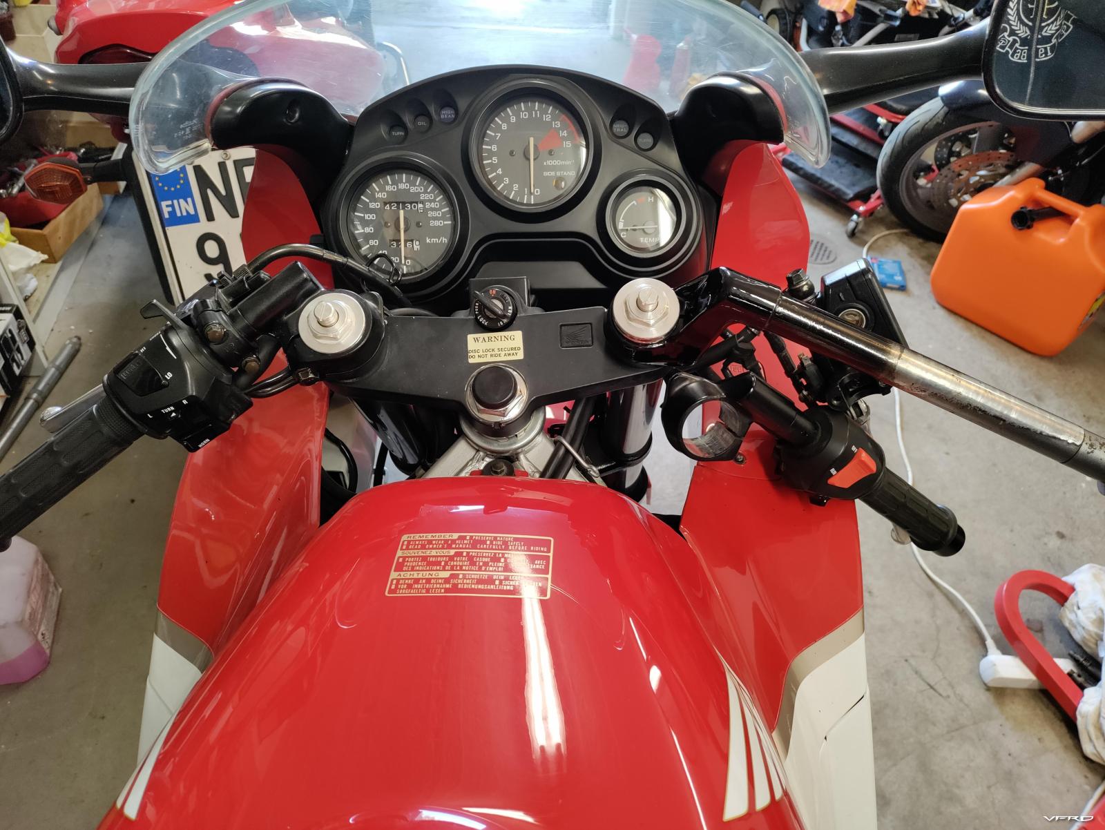

Also test fired the 88-89 RC24 clipons I have, could sure give a better (for me) riding position
large.IMG_20240505_101252.jpg.4bbfd2d147efe5972ee6ffa8cabe4145.jpglarge.IMG_20240505_101304.jpg.e1c9ef90e3db361383ec03b7e5d742a0.jpg
Only issue is it needs a longer brake line

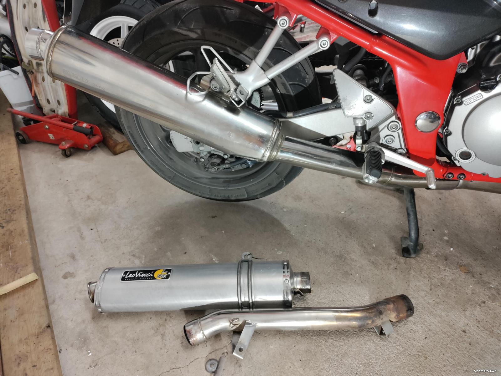

Bandit update, or some would say taking update off?
Off whit the to noisy after market exhaust muffler / silencer, on whit a orginal one, the orginal from a breaker, has small cosmic scratch but will do

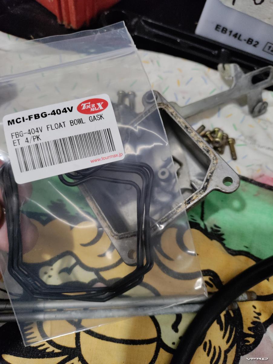

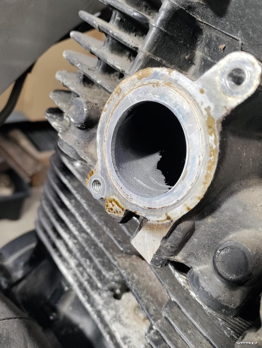

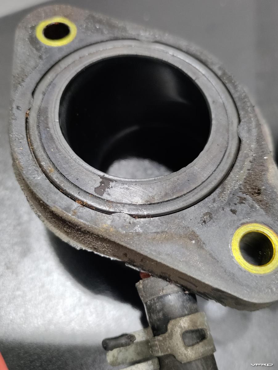

Might have found the running issue on the FJ1200
large.IMG_20240509_095631.jpg.425742800e9b1c1100e6a318bf291c0d.jpglarge.IMG_20240509_095639.jpg.f3733c1ca587644ff61058241769864d.jpglarge.IMG_20240509_095651.jpg.46d690cfbb56264aa28d2dcf6c625018.jpglarge.IMG_20240509_095712.jpg.d179658d1151415c65b42f3fc851b48e.jpglarge.IMG_20240509_095708.jpg.dc5db3117633a3c40bd8bf231c8f0086.jpglarge.IMG_20240509_095723.jpg.ded608eeeae3379bd4ecc96e5767ddf7.jpglarge.IMG_20240509_095733.jpg.0f9743ec7ab9f069549b9d0abac07136.jpg
New O rings needed for sure
Bandit now has a OEM silencer
Did a test ride whit XT today
Not so nice. Should top 135km/h bt actually doesn't do much more than 100km/h, ok on small twisty tarmac roads but awful on gravel bits. You have to keep taco between 6-8k to have some movement.
This was a bike I dorled after as a teenager, but a total disappointment for real, how can some folks love this bike? Not my cup of tea or this example does have some issues, strange through it starts ok, runs okay and has good compresson... Bike is listed

Well got the O rings for the inlet rubbers for the FJ1200
Did also change the float needle as housings as I had new as carbs off

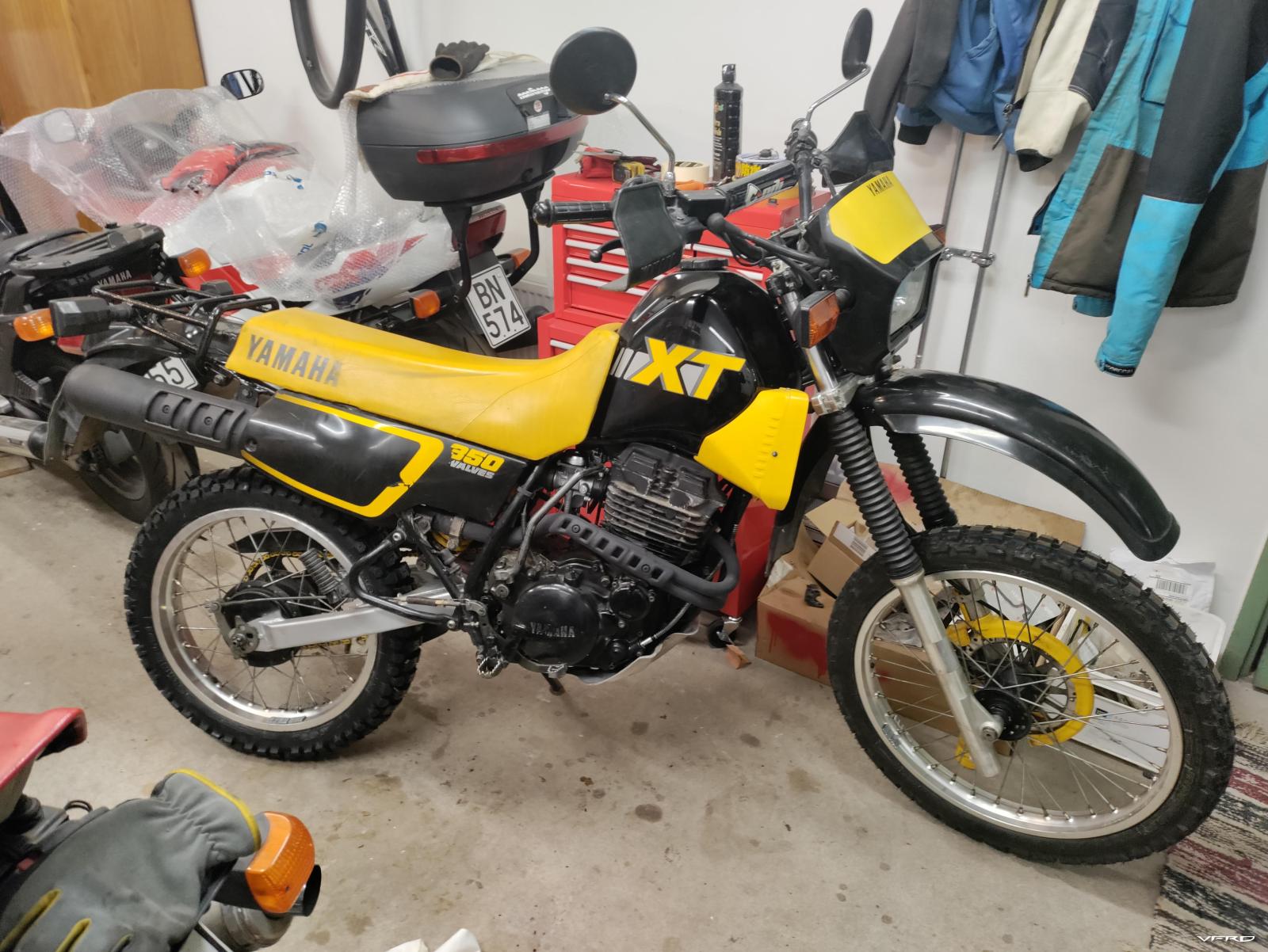

The XT350 has left the building
Hopefully new owner likes it
