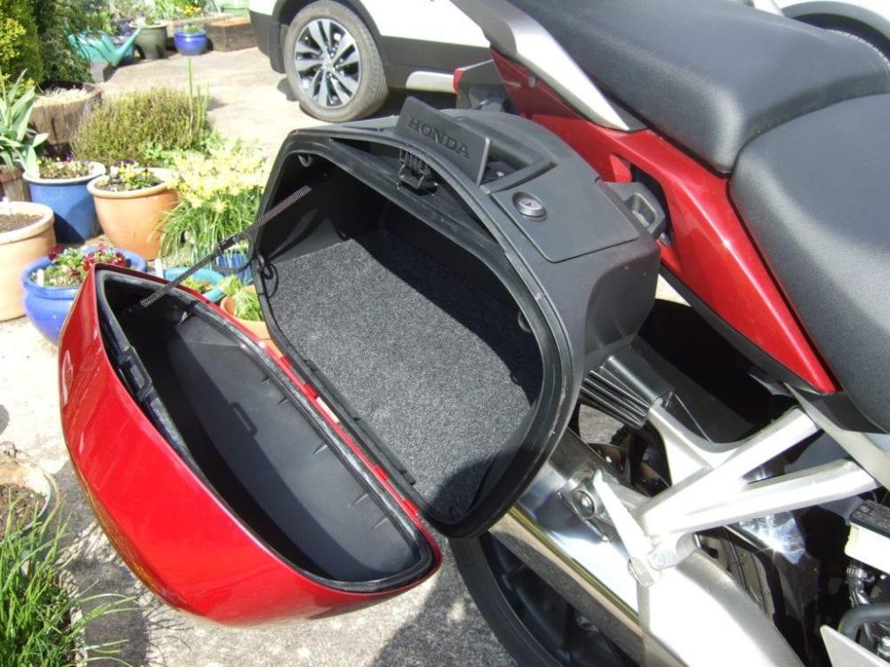

Photo is an 800X, the pannier looks identical to my 2014 800F.

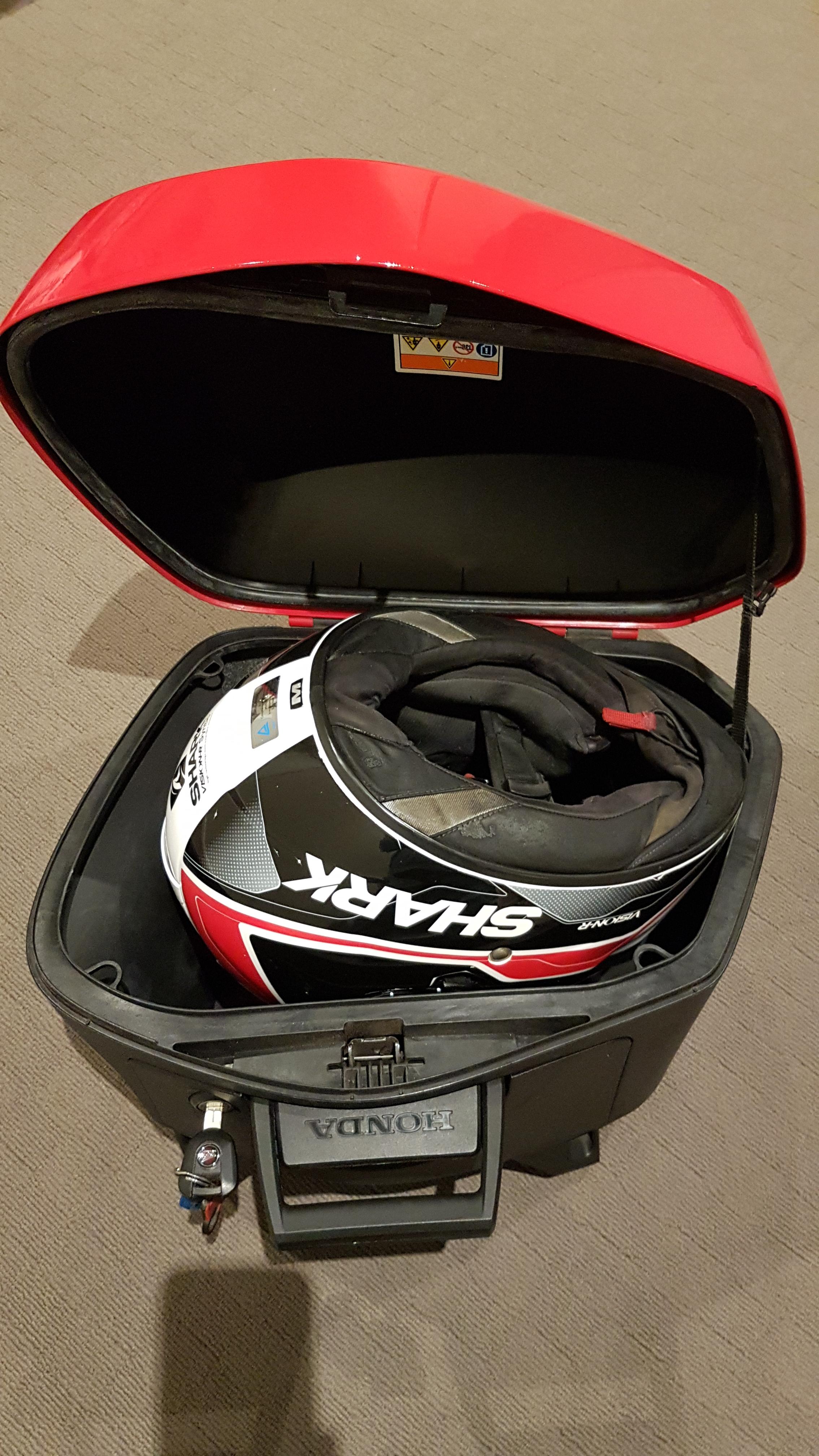

By the way, do the 29l ones accommodate a lid?

My Shark Vision R size Medium only just fits, pannier lid can be closed and locked.

Thanks for that Grum, - great pic!
