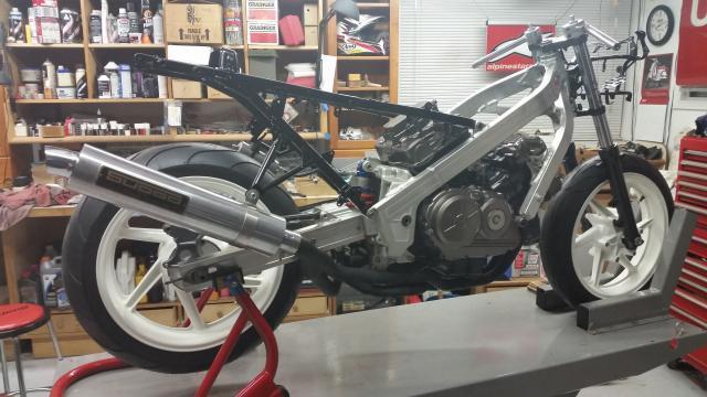

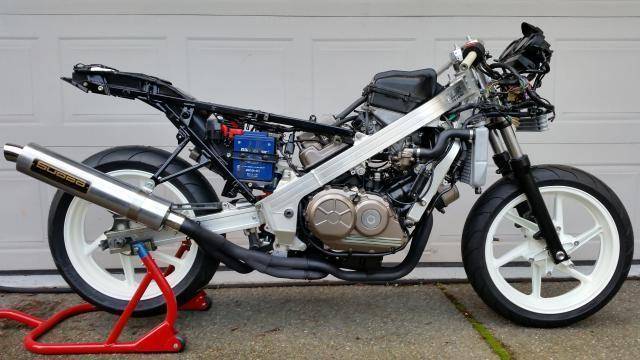

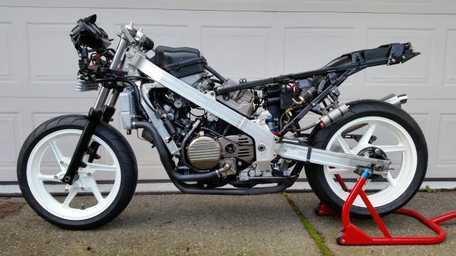

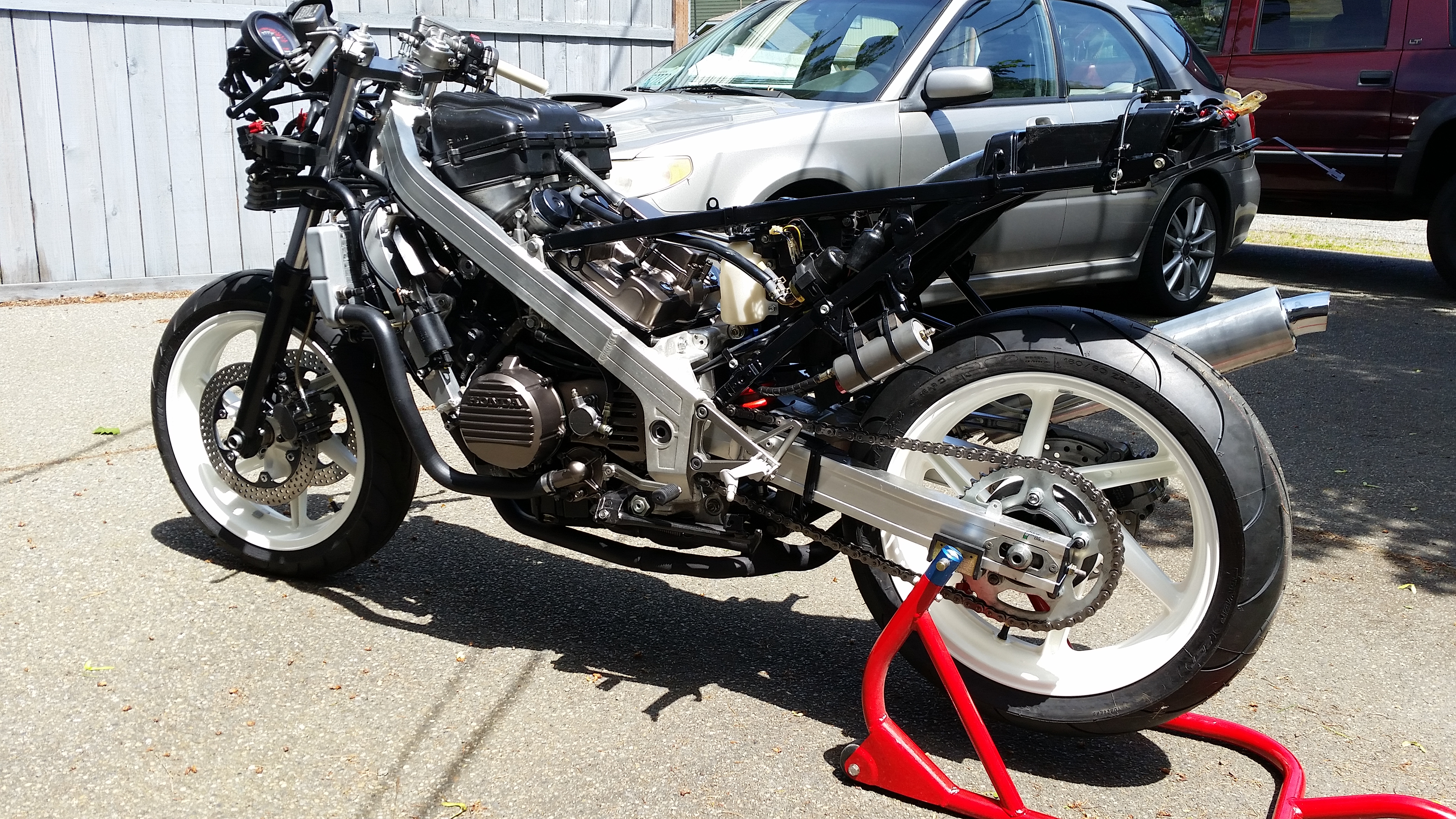

Member Contributer Captain 80s Posted January 29, 2016 Member Contributer Share Posted January 29, 2016 Started with a set of F2 wheels, forks and brakes. Next came a frame and engine and misc bits. Here's some work done. My more detailed build thread is on "another" forum. Lower F2 triple clamp with VFR stem and drilled and tapped adjustable steering stops. Forks rebuilt with RaceTech gold valves. Subframe has passenger pegs eliminated and the muffler mount coped and welded in the new position. Left side has passenger peg mount abbreviated and welded for shock reservoir, which is a modified F2 Fox TC using 87 linkage to accommodate the length (make up for 17" wheel and some extra). Custom spacers machined from stainless for either the F2 caliper bracket (pictured) or the stock bracket using a Triumph rotor (F2 bolt pattern and stock VFR diameter). Seat latch bracket modified to eliminate signal mounts and grab bars. Link to comment Share on other sites More sharing options...

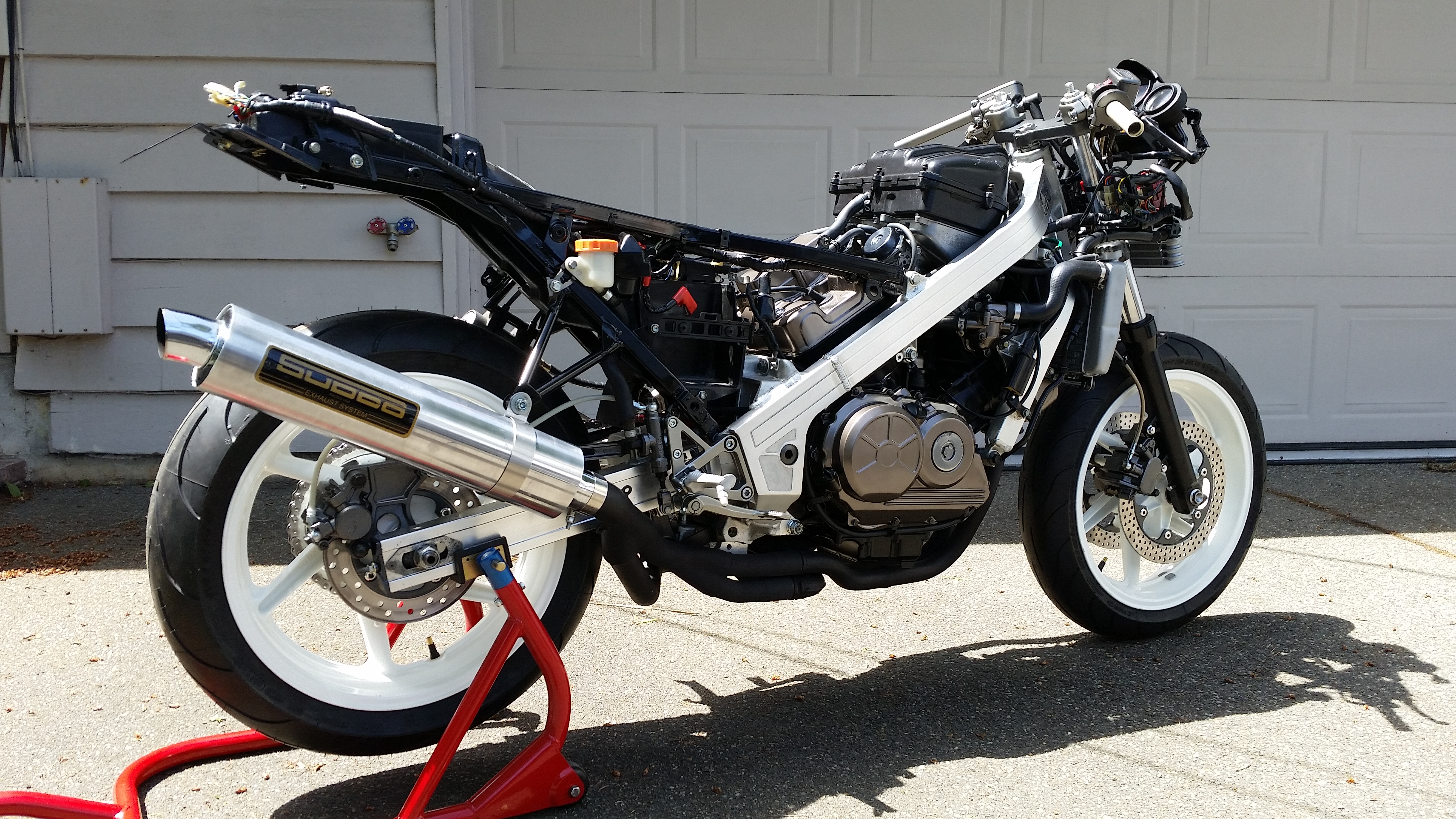

Member Contributer Captain 80s Posted May 31, 2016 Author Member Contributer Share Posted May 31, 2016 Just need to bleed the brakes and clutch and take care of a couple minor things (left handlebar switch wiring and tidy some things up.) Link to comment Share on other sites More sharing options...

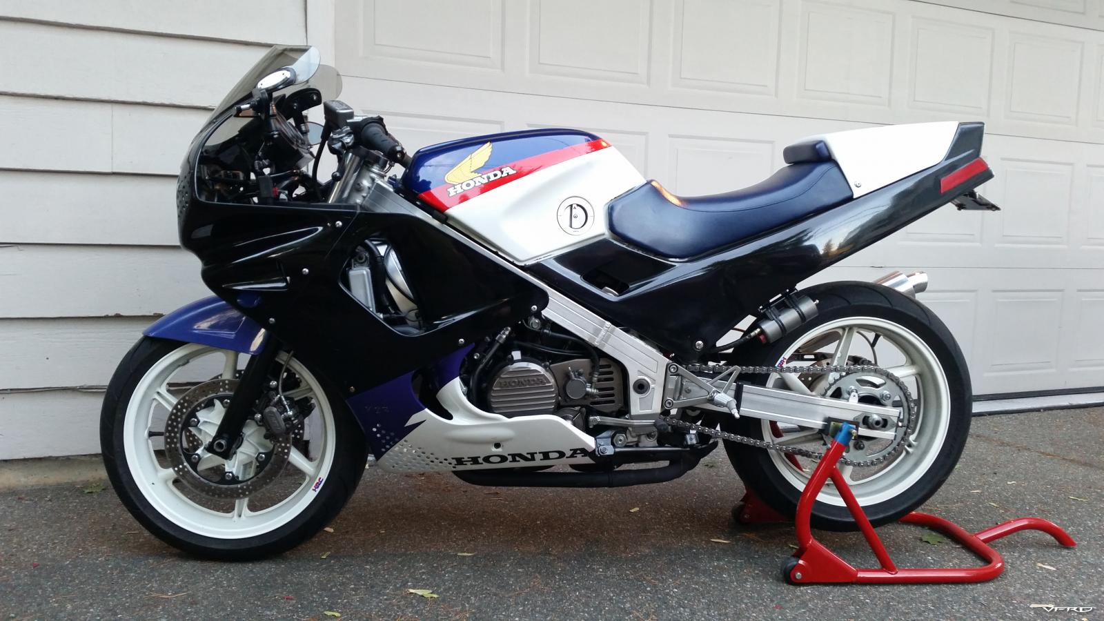

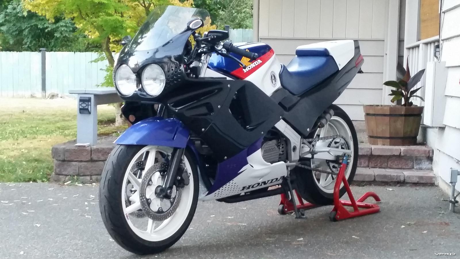

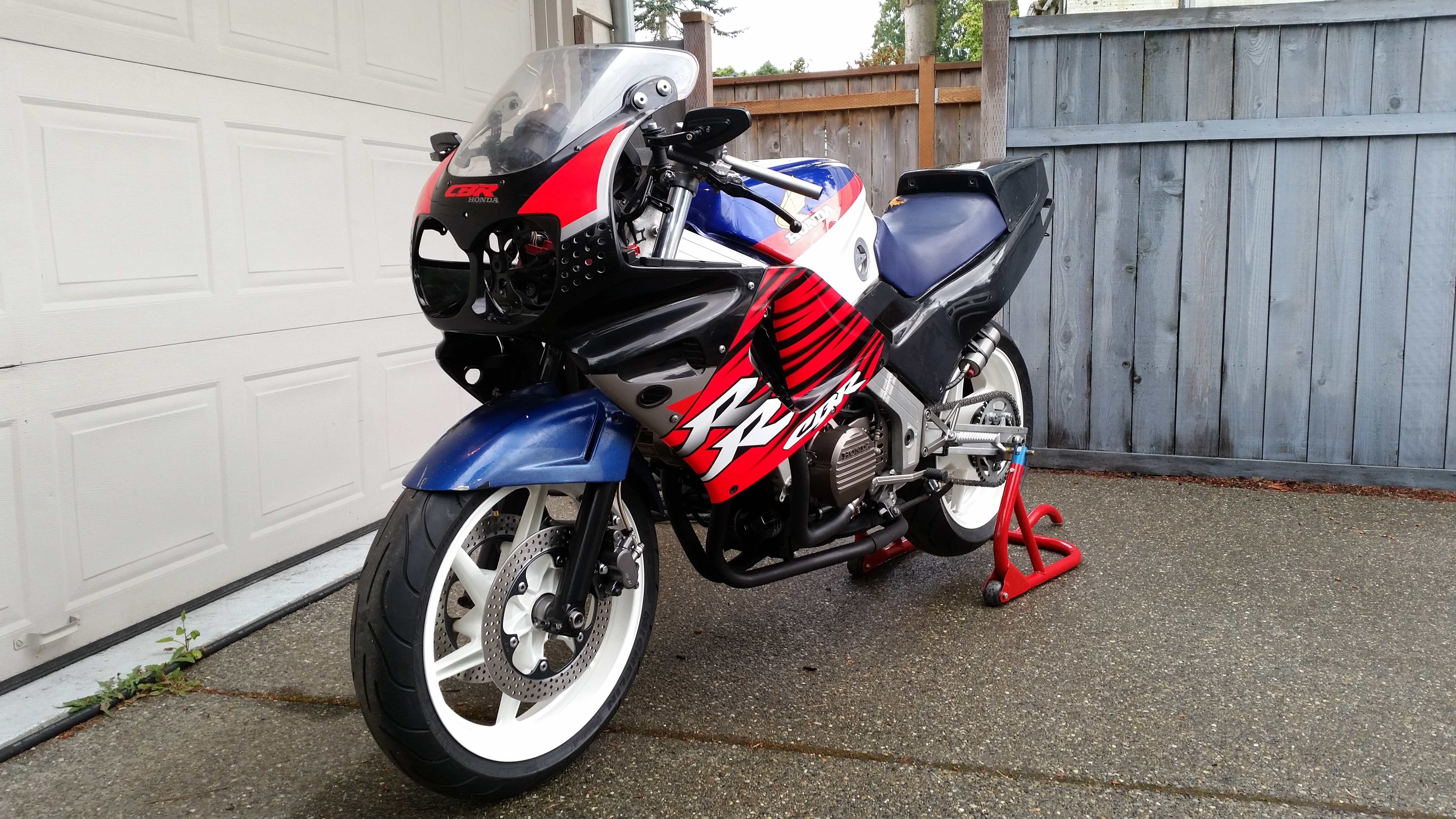

Member Contributer Captain 80s Posted June 24, 2016 Author Member Contributer Share Posted June 24, 2016 Starting to fit the body work. Cobalt Racing tail section. OEM CBR900RR upper and mids. I have the headlights and bracket. Fits the bike surpringly well. Good steering lock range and the vents in the mids line up nicely with the radiator. Link to comment Share on other sites More sharing options...
Member Contributer CornerCarver Posted June 25, 2016 Member Contributer Share Posted June 25, 2016 Loving it so far! For the upper cowl placement, did you position it so that the mid fairing were aligned (more or less) with the top frame rail or did you position it for bar clearance and the ability to tuck at speed on the straights? Link to comment Share on other sites More sharing options...

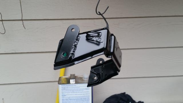

Member Contributer Captain 80s Posted June 25, 2016 Author Member Contributer Share Posted June 25, 2016 I'll have to say I got really lucky. I had held it up a bunch of times trying to guesstimate where to start... and then I just did. A visual cue for me on all the best looking Hondas (really, any bike), the top of the tank line runs into the top of the headlight(s). Look, you'll see. Started there, and it worked. I have the brackets designed and I'm making them out of round tubing the same size as the upper cowl stay. Good steering lock and the side vents are perfectly positioned. Also recently realized I "get" to take off the front end to install the adjustable steering lock bolts that I drilled and tapped for. Can't get them installed with it assembled. :( Link to comment Share on other sites More sharing options...

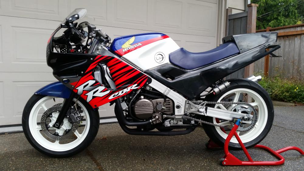

Member Contributer Captain 80s Posted July 24, 2016 Author Member Contributer Share Posted July 24, 2016 Rode it yesterday. Feels amazing and runs great. Couple little tweaks to do, but everything works as hoped. Link to comment Share on other sites More sharing options...

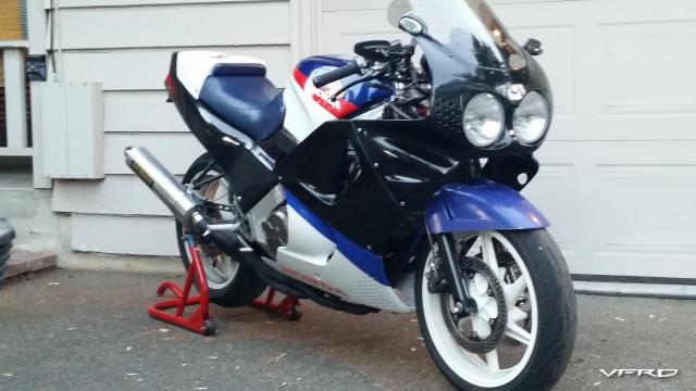

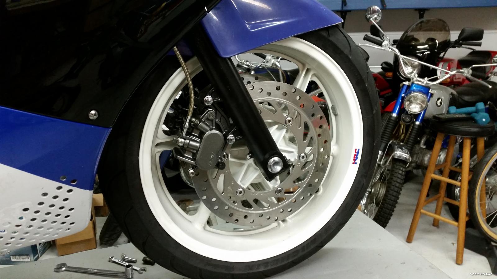

Member Contributer Captain 80s Posted November 19, 2016 Author Member Contributer Share Posted November 19, 2016 Overdue update. Fitted the lowers... Very happy. It now has 1991 VFR front calipers, brackets and rotors. Bigger disks and full size brake pads, not those tiny F2 pads. Link to comment Share on other sites More sharing options...

Member Contributer Captain 80s Posted November 21, 2016 Author Member Contributer Share Posted November 21, 2016 49 minutes ago, Auspanglish said: Surely you won't need the optics at the track... Looks real curious!! Decided to make it street legal for testing and so I can enjoy it more often. Link to comment Share on other sites More sharing options...
