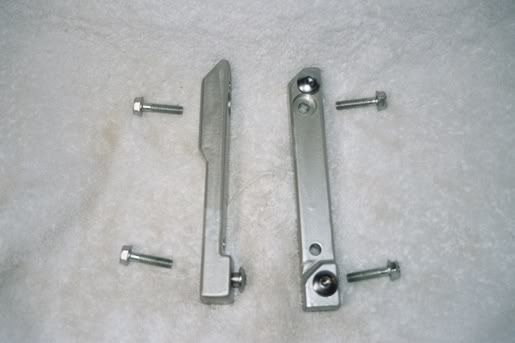

The VTR fork spacing is not as wide as the 5th forks, so the fender wont fit up to fork tubes and mounting holes wont line up. I ran into this when I used VTR lowers on my 5th gen upper tubes. So what does an engineer idiot do? Figure out a conversion brackets so the 5th gen stock fender bolts up. I ended up doing the extreme step of taking VTR lowers and the VFR lowers to a CMM house, getting all dimensions digitized and doing a design. Then over to the machine shop and they knocked out some pretty impressive brackets. Jeez, I must have been nutz, I got about 300 bucks in my fender brackets.
Check my gallery for photo and assembly.
teaser pic - yes, I'm a whackjob.. :tongue:
Posted Image
