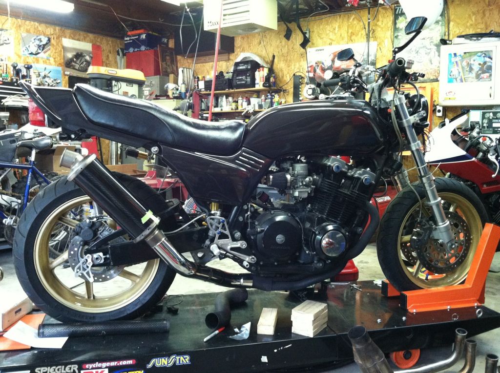

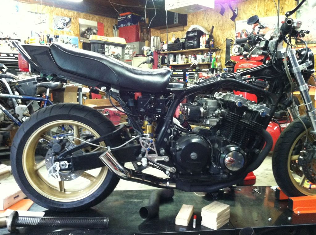

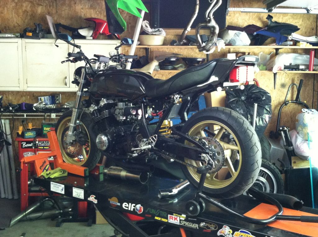

Had a bit of a slowdown while I rearranged the shop to make room for a new machine. Getting back into things now.

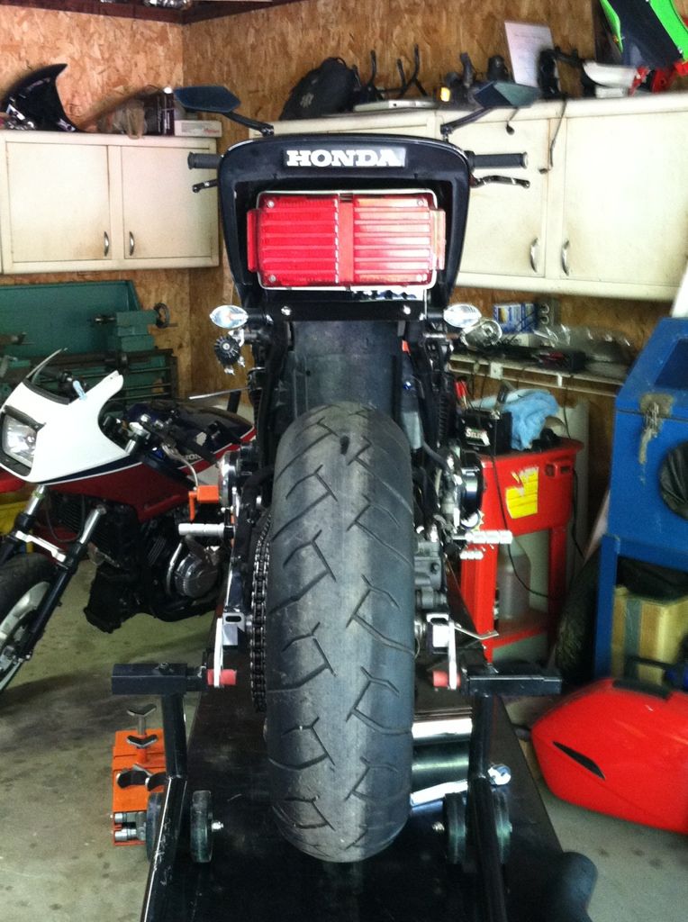

Rearstand brackets are done, minus paint. the blocks will remain bare and the brackets will be painted the same bronze color as the triples.
Posted Image
I even tested them...
Posted Image
Posted Image

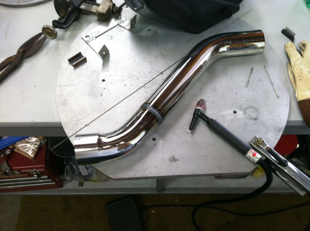

I did some exhausting work today...
Posted Image
Posted Image
Posted Image
Posted Image
Posted Image

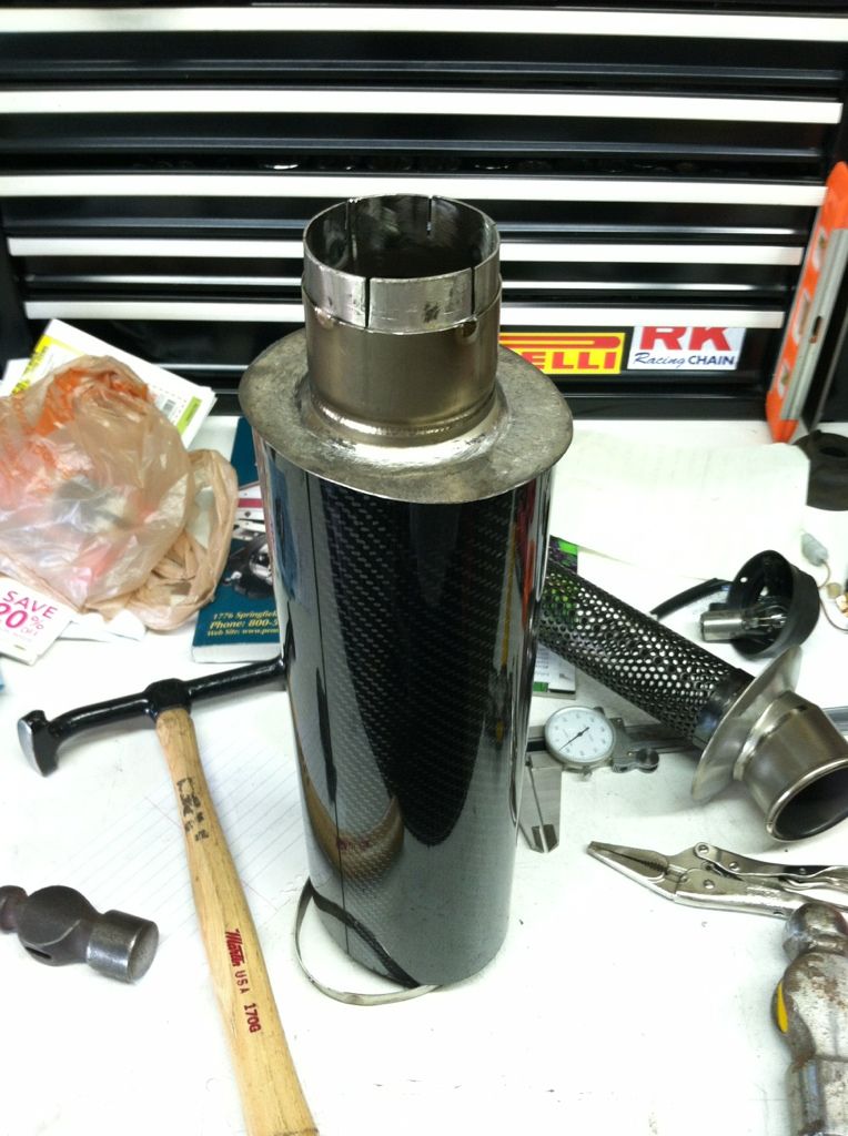

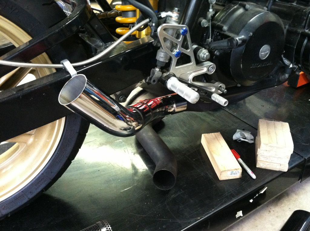

Posted 30 May 2012 - 07:37 PM

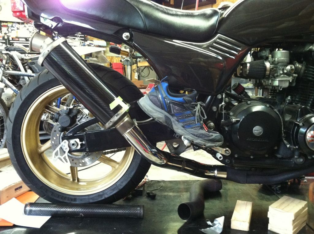

The can is a work in progress, I'm recycling endcaps and innards from a crashed titanium Arata can. The parts have to be reworked & resized to work with the different oval shape of the carbon sleeve I have. Both caps were convex. Because the inlet cap was out of shape, the easiest way to make it work was to hammer it flat.
Posted Image
Posted Image
Hope to have the exhaust wrapped up this week. I also reworked the stainless header so it will be ready to go after I rebuild the cylinder head.
Had to make sure I wasn't going to toast my boots...
