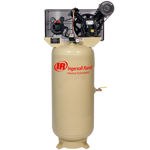

I had the good fortune to live next door to the local Ingersol Rand service technician for a few years. We drank beers together in the evening and became pretty good friends. I got a really, really sweet deal.
I have found that it has met all my needs.
