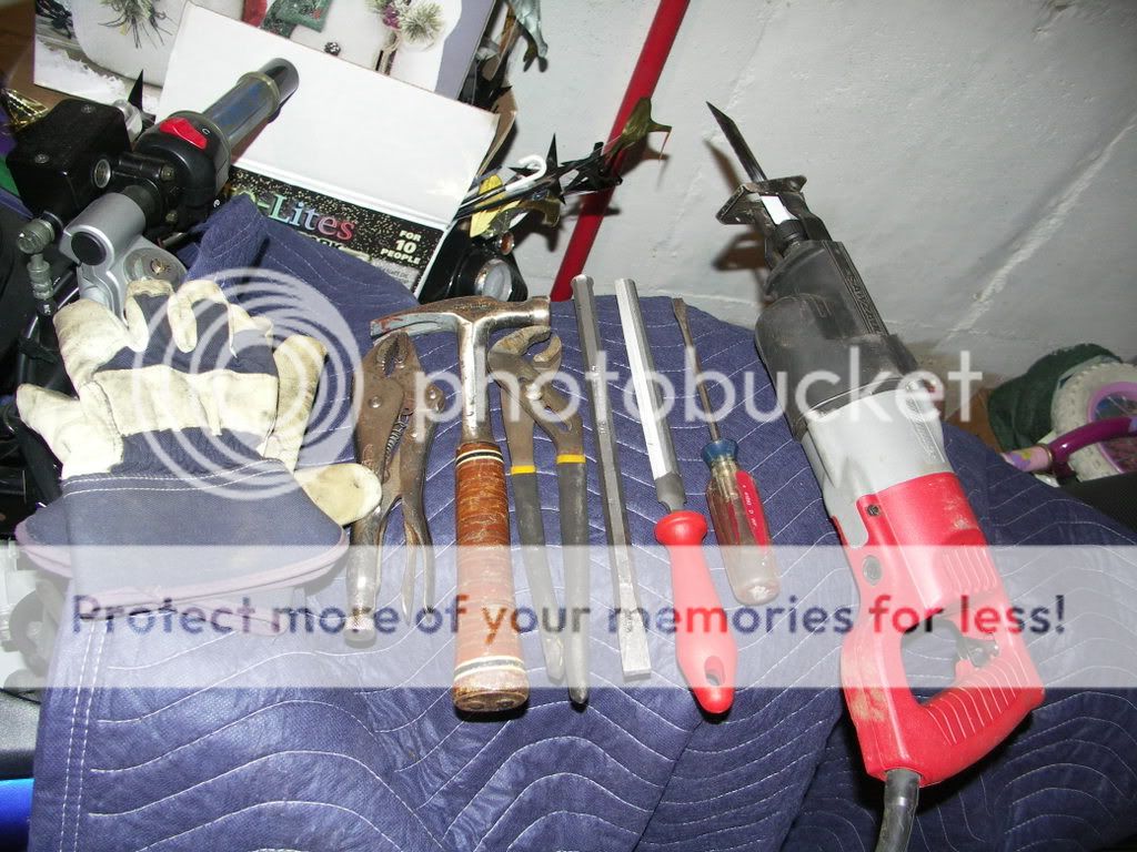

The tools:
Posted Image
  • Heavy duty work gloves. After reading prior posts
  • Goggles (not pictured). Use your imagination.
  • Wise Grip
  • Hammer
  • Channel Lock
  • 12 inch chisel. A shorter one will not work
  • File (rough grain)
  • Large screwdriver
  • Sawzal
