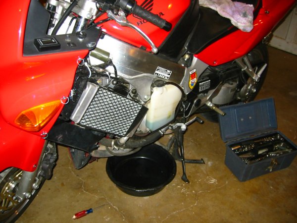

I began by first removing the 2 lower fairings with the bike on the center stand.
First I drained the oil, position the drain pan below the oil plug.

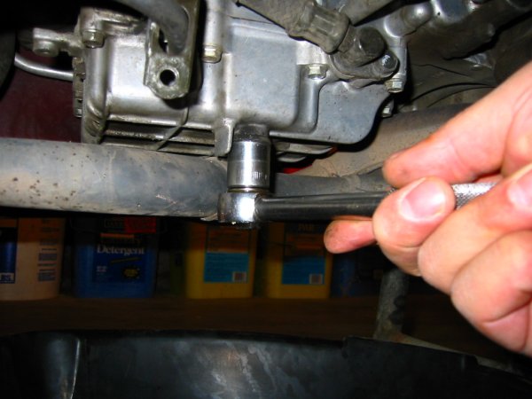

The manual says to warm up the engine to get the oil to flow better, I don't do that since I like my skin unburnt, I just let it flow out for a very long time! Remove the drain plug 17mm, Inspect it for pitting the soft metal washer might need to be replaced if it is pitted.

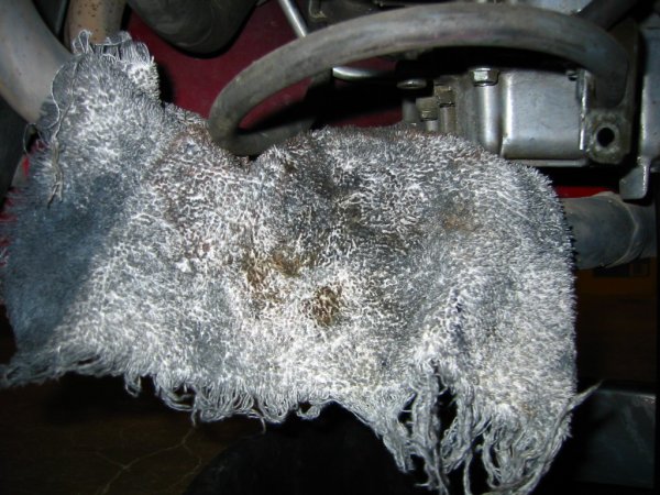

When replacing the oil filter it is best to put a rag over the headers cause oil always spills out onto them.
Posted Image

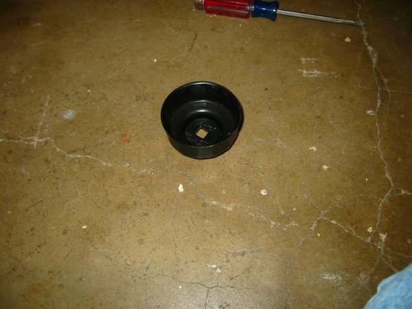

It is difficult to remove the oil filter by hand or using a ring type wrench, I use this Honda filter wrench $7.00
Posted Image

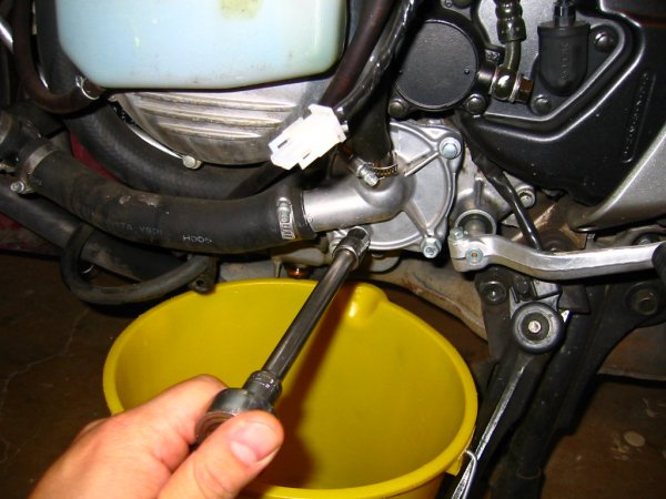

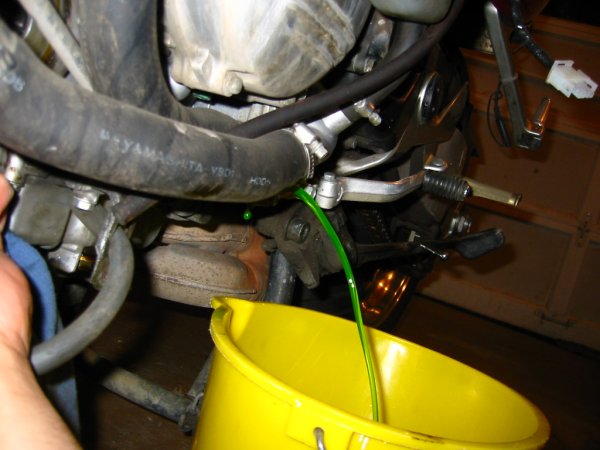

Remove the drain plug from the water pump, make sure the bike is not hot! You will get burned! The bike was cold here, the fluid will not come out until you introduce air into the system.
Posted Image

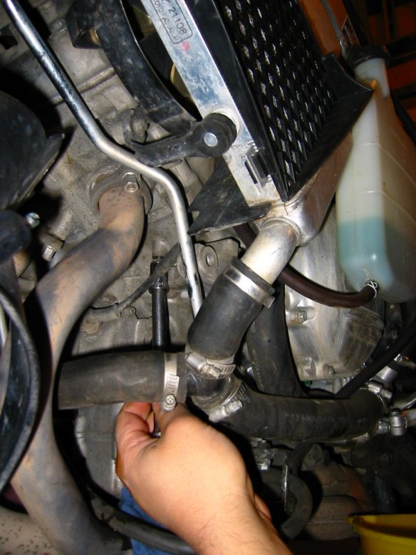

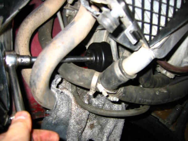

I drained the cylinder plug now, you can see why I did not put the oil filter back on, because it was in the way, make sure your bucket is positioned cause the old antifreeze squirts out about a foot and a half.
Posted Image

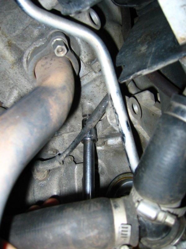

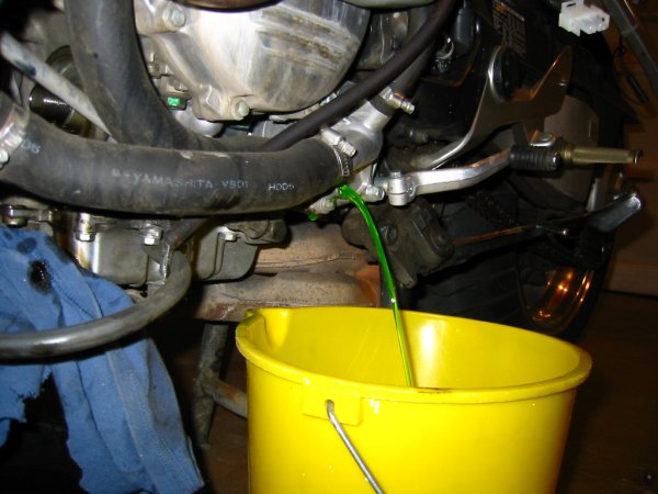

Here is a better view of where that plug is
Posted Image

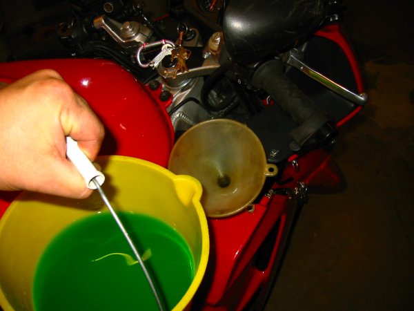

It just starts gushing out, once its almost done go over to the other side of the bike and open the radiator cap, more will come gushing out.
Posted Image
radiator cap open now
Posted Image
At this point I began pouring in distilled water into the radiator cap, and watched until the fluid coming out was clear!
